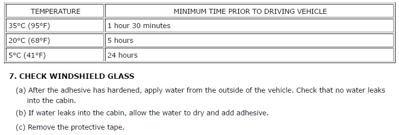

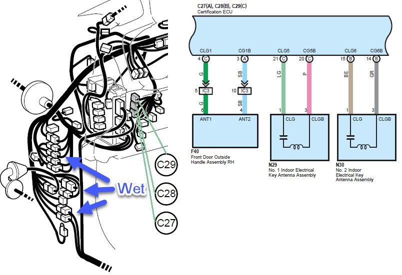

    After thanksgiving I had posted this thread on my outside Temperature gauge going wonky, turns out the reading goes south whenever it rains.. this led me to thinking there was a water issue in one of the connections.
    Last night we had a major rain storm - super flooding here over the 200 yr event but that's another story. This morning I went out and my smart key door wouldn't unlock. Touching the handle didn't work, nor would unlock/lock buttons on the fob. I had to go inside and get the key (Meso cool) and manually unlock the door. Once inside the smart key was picked up and the truck started like normal.
    After a morning of searching TW I came across this thread with electrical issue due to water leak, I crawled down and pulled the drivers trim and kickpanels and I can see water on the back of the connections under the dash..
    Had a windshield replaced this summer, but is there anything else I should be looking for leak wise? What is the best method to track it down?
    For drying out the connections a contact cleaner is probably the best correct?

    I'm not sure how long the connectors were wet or if they still are, but you'll want to make sure there's no corrosion on the terminals. You're good to use contact cleaner but don't use any kind of parts cleaner as that will destroy the plastic on your harnesses.

    Glass shop removed and resealed the windshield, I used contact cleaner and compressed air do blow-out the lower connections that had been wet..
    Zero issues, temp works great, dry foot wells, problem solved.
