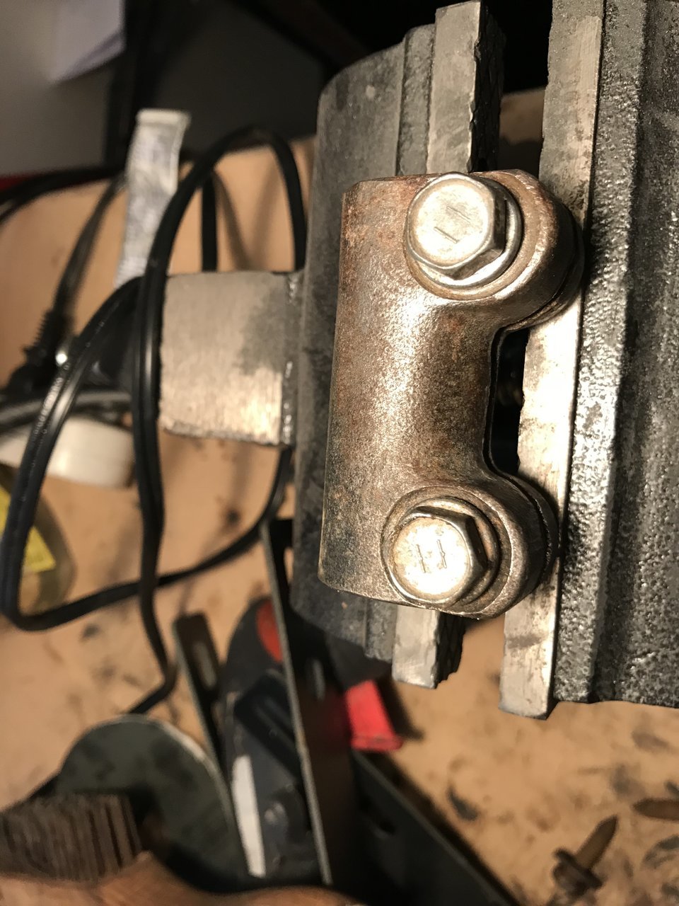

    Update: Rack and Intermediate Steering Shaft are out! Took a lot of heat, prying, banging and stringing together every profanity in my memory bank. Dreading the replacement...
    Will I need to remove the inner tie rod ends to get the new one back in??
    New Intermediate Steering Shaft from stealership
    Also, got a new Steel Line (7-6733) and a male hose fitting, for the rubber hose going into the rack (7-1307) from NAPA. Both were messed up getting them out. Rust is a bitch, I envy you southern drivers.

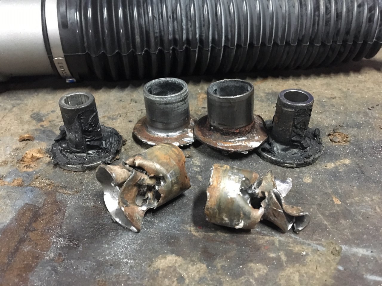

    Started getting the R&P bushings out of the new rack...super PITA by the way. Finish up getting the new Poly bushings pressed in tomorrow and let the FUN continue. :boom:
    I only plan on doing this once with this truck, might just as well do it right.

    I left the inner tie rods on the new rack when putting it on. Just takes some finagling to get it right! Good luck and be patient. You got the hard part done.

    Old bushings are out of the new rack and new poly ones are in. That was a lot of fustrating work...but worth it.
