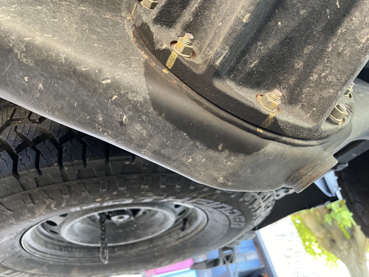

    Copy that. I will be installing a new diff breather this evening and maybe that'll stop the seeping of oil and then I can cancel my appointment with the dealership. Also check the fluid level tonight. I just went out on my lunch break and I can see fresh oil coming out at one small spot at the pinion.

    LOL I ended up not taking the relax advice and I went out anyways to work on the truck last night. It was in the shade and I felt good so it was no problem.
    I did have a Tacoma rear breather relocation kit I purchased from Yotashop.com (https://www.yotashop.com/toyota-off...nKOdipe7fFErLTiD4MxrKWmUNn0mx3BoaAqzNEALw_wcB) for $23. I had not had a chance to install this kit yet but since diff oil was seeping from the pinion I thought hmmm.... maybe the factory diff breather is not functioning properly. SO I got out the tool and loosened up the breather and to my welcomes surprise there was a good amount of pressure that came rushing out of the differential. Along with the pressure release and my try to blow air through the breather (which I could not) I came to the conclusion that the diff breather was broken. I set into installing the diff breather extension kit from Yotashop. I did zip tie all the breather lines under the truck, left a fair amount of slack for articulation, and finished up the breather extension in the drivers side tail light housing.
    I am at work now and I am happy to report IT WORKED!! I crawled under my truck and the 30 mile run from yesterday which yielded oil spots all over the underside of my truck showed no signs at all today! So because the factory diff breather was unable to release the pressure that builds up in the diff because of heat the gear oil was forced out through the path of least resistance which in my case was the pinion seal. So if you are having Tacoma differential oil leaking issues it could be your breather! I hope this is over and I do not have to deal with the dealership again anytime soon! I am posting a few pics of the clean diff afte my drive to work this morning.

    Positive pressure or vacuum? The stock breather is a one way valve. I forget which direction that it is supposed to flow. Mine diff had a vacuum when I did the mod. The replacement filter has no flow direction.
    Hopefully, you are solid though.

    I tried forcing air through the bottom which would be the direction air would have to escape the differential. I was not successful in getting any air to pass through the OEM breather.

    Like I said, I can't remember which way it was supposed to go. Clean it and try sucking on it. Air should flow in one direction. If not, it is definitely the issue.

    I had this happen on big OTR trucks in the past......NOW keep an eye on the level and any other spatter, if it stops the seal was not too compromised.

    I have given this some thought. I am still a bit worried the seal might be bad now that the oil has been forced past it. I am going to be putting some 4.88 Revolution Gears into my rig in the next month or so and those parts should be changed out anyways. Thanks for the heads up!

    To be thorough, I would pull the rear wheels and make sure the axle seals didn't do the same thing spewing rear end lube on your brake shoes.

    The seal is fine. They aren't designed to hold pressure so they easily open up a leak path when asked to do so. Doesn't compromise it.

    Wow! Thank you for your input!! I was concerned that the seal could be compromised. Although where it was wet yesterday it is dry today after the breather exchange. This is good to know thank you!

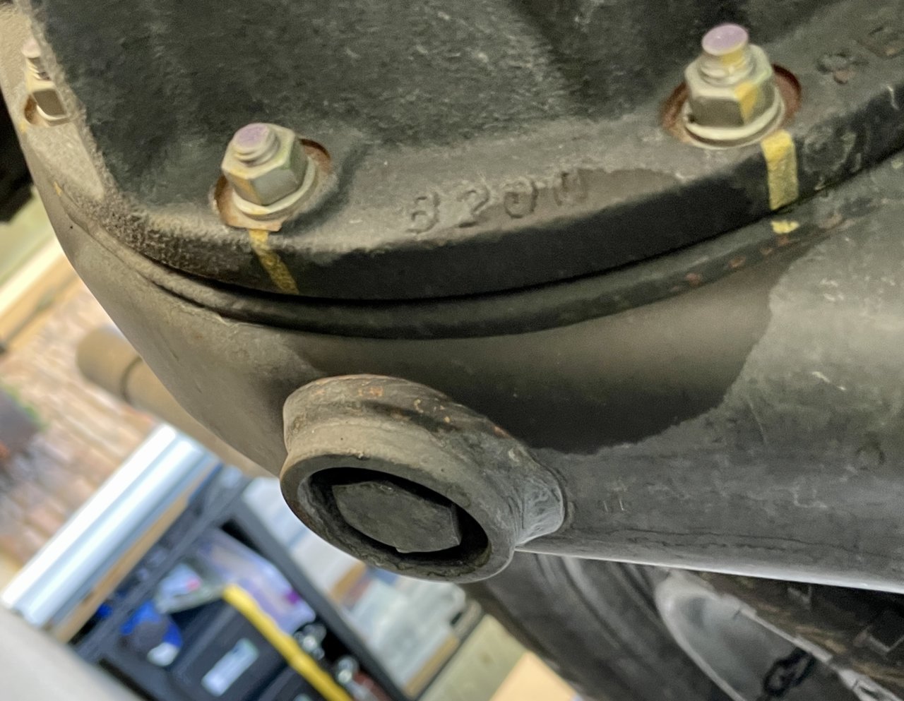

    With that amount of miles on the truck I would take it into Toyota and ask them to reseal it. These 3rd Gens are known to do that. I asked my guy at Toyota and he said no problem bring it in.
    However.... Before I did all I noticed the rear diff breather looked kinda dirty and I thought it could possibly be plugged up. I unscrewed the breather and tried blowing air through it and sure enough it got all gummed up and no pressure could escape causing the gear oil to force out around the weak point in the seal when the diff heated up. For some reason Toyota put extended front diff breathers in but not in the rear.
    So I bought a rear end diff breather extension kit, ran it up into my drivers side tail light housing, and I have not had one issue of oil leaking since.
    I am not saying that is what your issue is but that is what worked for me.

    There was gear oil coming out of the axel seal too near the U joints.
