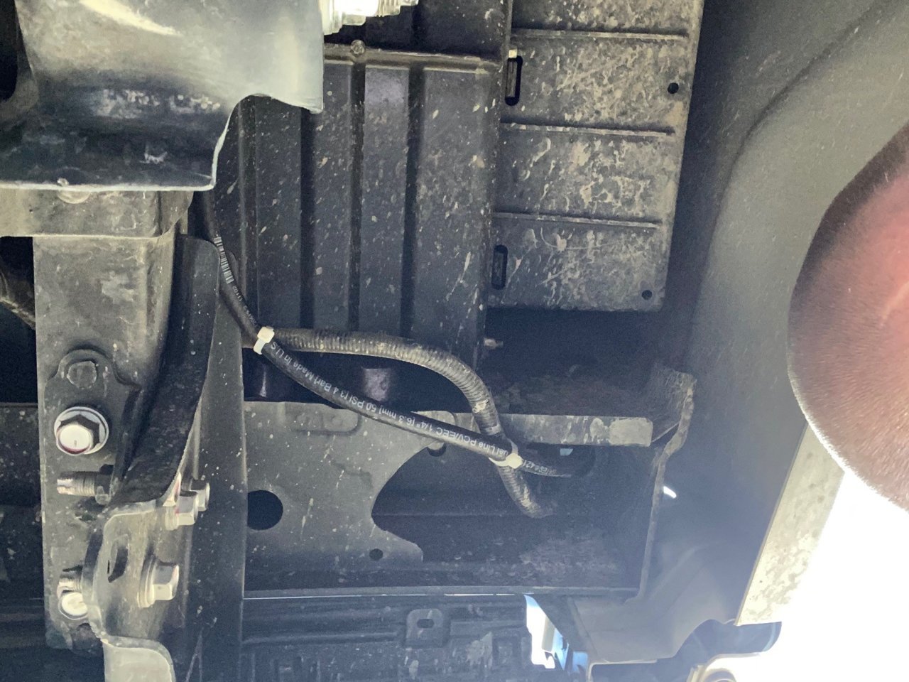

    wow. that undercarriage is clean!!

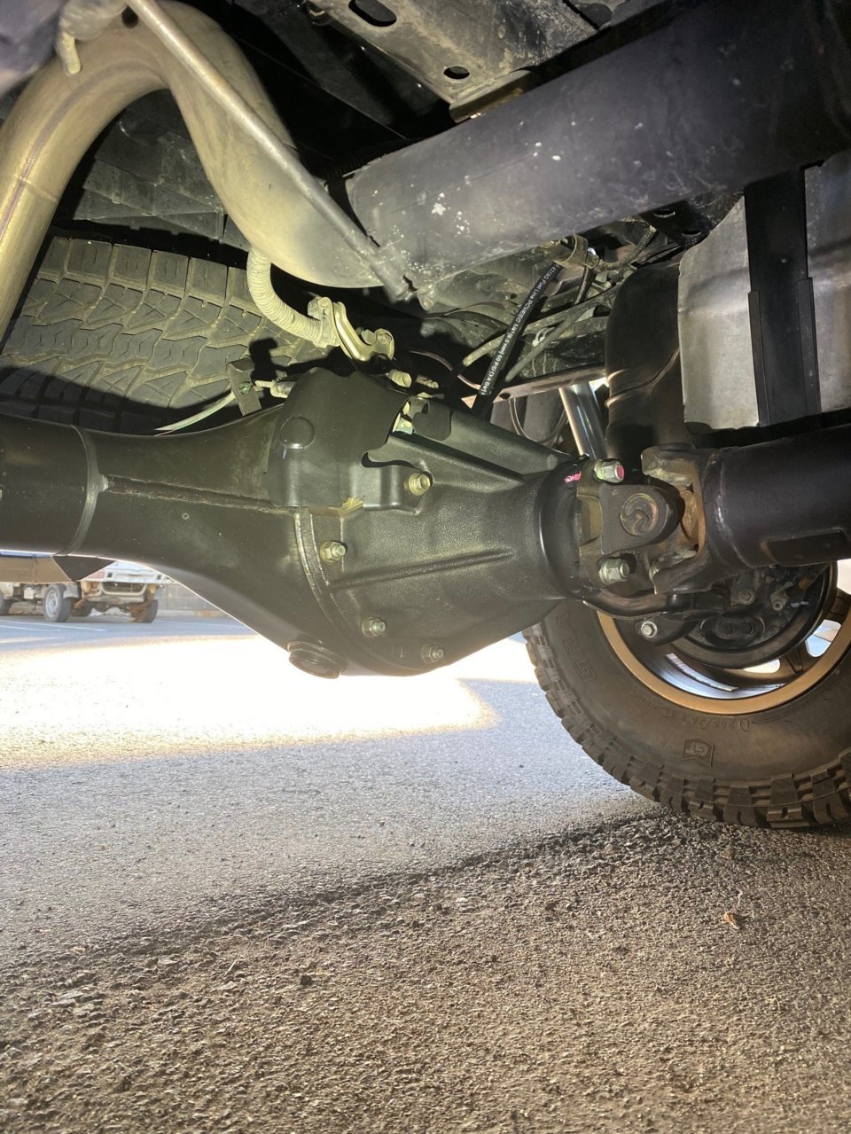

    Sorry I meant the pre load spacers where the drive shaft mates up to the 3rd member. I think I am naming the part correctly.

    lol thanks. after each and every trip (mojave road, big bear, joshua tree, red rock state park, rowher flats, etc.) i get under and scrub everything down. it is a pita but it's worth it to me.

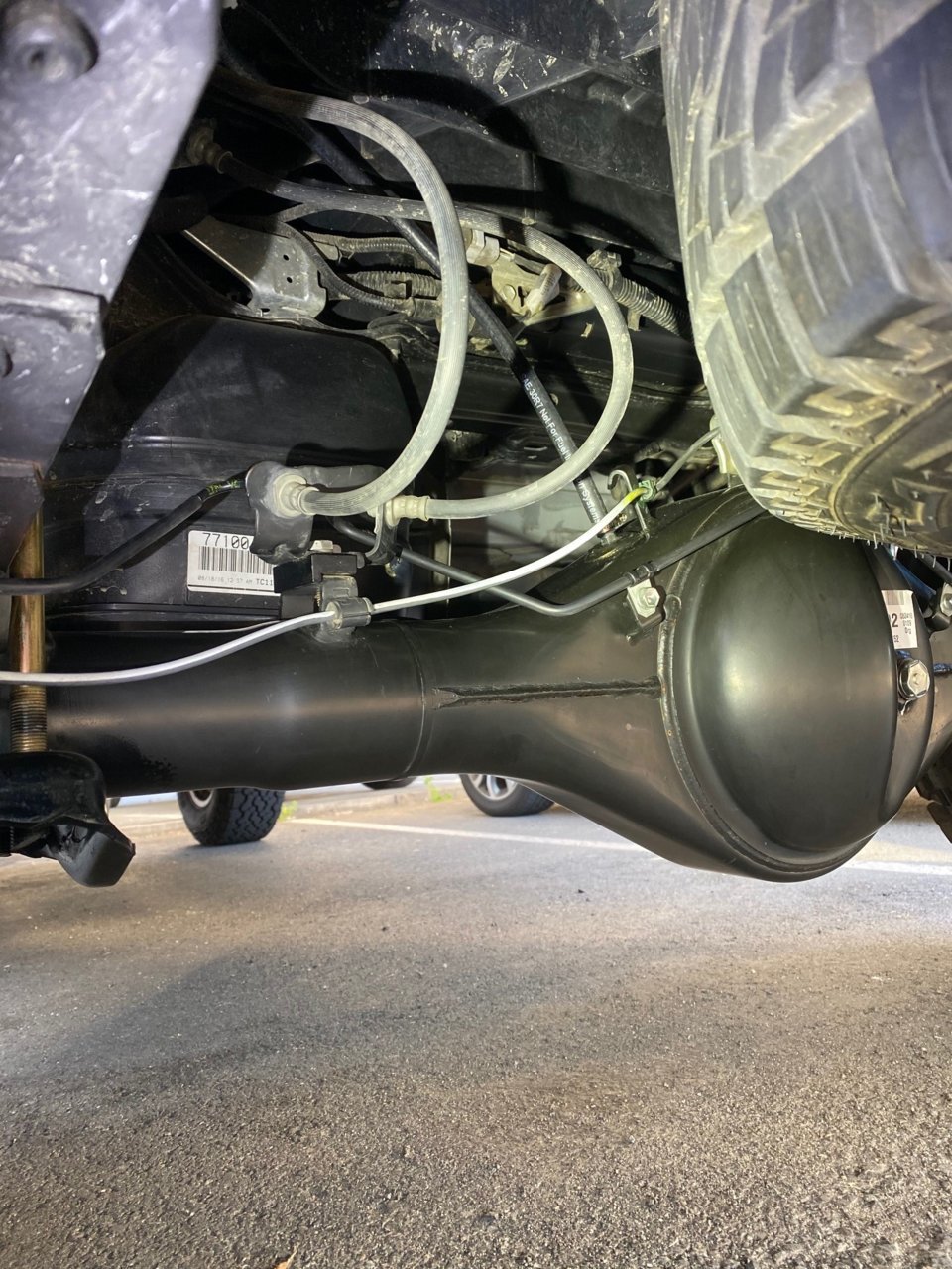

    I'm pretty sure at least some of these trucks, including mine, came with rear diff breathers that were only one way. ALL the original write ups that I've seen on 3rd gen rear breather relocations pointed to such and most included links and Toyota product numbers for two way breathers. I believe it was simply the part numbers for the front breathers which were two way. I definitely don't know why Toyota would have done this, possibly an accident, but I believe it to be true. I did the relocate on my truck the first week on ownership, with less than 200 miles on the truck. My breather was brand new, and definitely not a two way.
    Did you replace yours, or did it clean up and flow both directions?

    I can believe Toyota doing something like that. Having a two way for the front and not the rear. IDK why not just make both single direction flow.
    After I removed the rear breather and cleaned it out I still could not get any kind of air flow either way through it.
    I think the rear is one way flow so it can release the pressure when the diff gets hot and not allow any kind of water or debris ingress to get sucked back into the rear diff. Because it it sits right down near the ground where all that kinda crap can get back in.
    The new extended breather I installed is one way and I have had zero issue in about 30k miles. In my opinion Toyota should have just installed the extended rear breather from the factory to start with. It seems like that is a MUST HAVE mod unless you stay on pavement all the time.
    You were smart to add that to your truck right away!!
