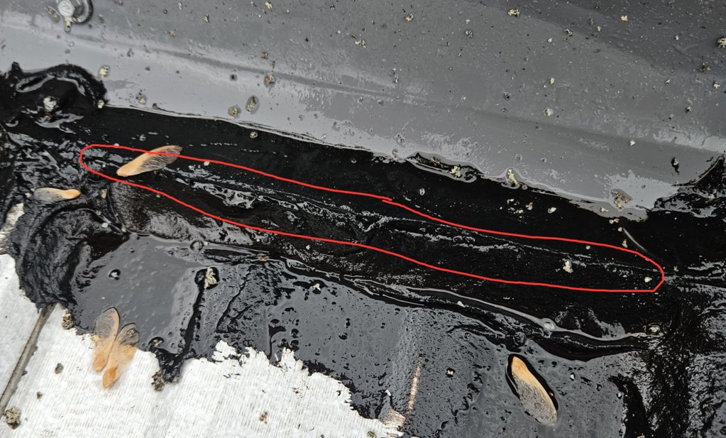

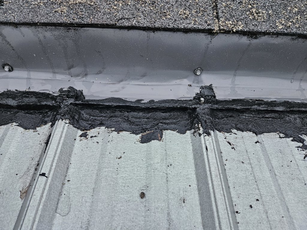

    I've been chasing a leak for over a year now on my machine shed. This entire thing was clearly an afterthought at some point in the past, added on to the garage. Its been leaking for a long time and now IM the lucky guy who gets to deal with it.
    My initial suspect was the foam between metal roof and flashing due to poor install and dry rot over time. Then I found one of the seams in the flashing was funneling water IN not out. I "fixed" both with tar last fall. Worked great for a few months, but now Im finding the tar has cracked because I spread it way too thin.
    At this point Im considering what the best approach is while staying on a budget.
    Continue to patch it and hope for the best? Maybe try to form a thick bead of tar across that whole seam.
    Buy a 50' roll of extra wide flashing? Rip the old flashing out entirely. I bet forming a 28ft long piece to the shape I need by hand would really suck..
    Buy some preformed 90 degree 6"x6" and tuck it up under the existing?
    If anyone is a roofer by trade or ever dealt with the transition to such a shallow pitch Id welcome any ideas!
    Initial repair thinking the foam between ribs was the culprit (because it was missing in areas)
    Very hard to see wet, but its way too thin along the edge of the flashing and forming cracks

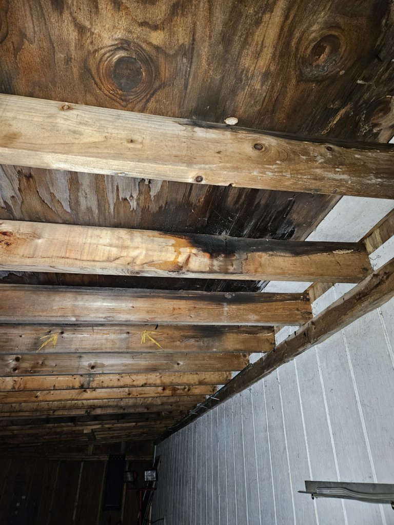

    Also just to add - yes I know the entire roof, sheathing and probably even some 2x6s need to be ripped off and replaced entirely.
    But funds are short right now. Short term Im just trying to keep it dry and buy myself a few years before doing the whole roof

    The wet patch material typically expects a fiberglass cloth or repair fabric to be used underneath.. otherwise temperature changes and UV will cause cracking as you've experienced.
    Also.. water can track the craziest paths sometimes.. check at the top of the flashing where the shingles meet.. you may be looking at the wrong spot. cover way more of the area than you think necessary. I maintain a flat roof old building and it's a MFer. Good luck.

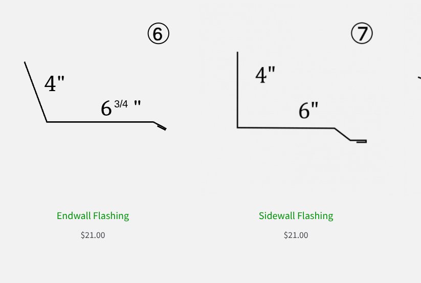

    If you go to a metal roofing products dealer - not a box store - they have a catalog of ready made wall flashing & such.
    They cost less than you would think and usually deliver in a week or two.

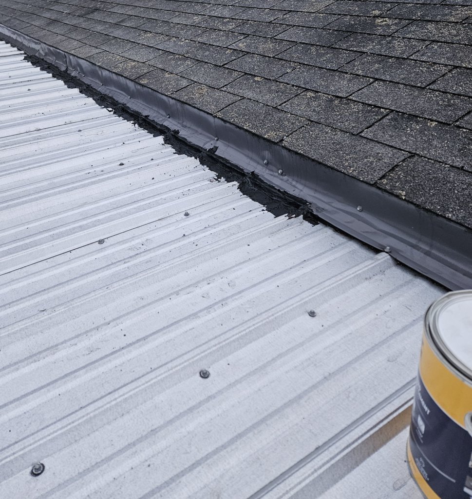

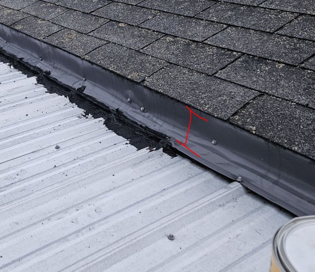

    That shop got back to me - $1200 for a 28 ft "custom transition" :rofl:
    Not sure they understood what I want, nor did they want the work with that price.
    In any case planning to pick up a 50 ft roll of 10" flashing and bend my own. Thinking Ill sandwich the top ~3" between two 2x4s in the vice. Use that as a guide with a rubber mallet to bend the angle I need. Never worked with roll flashing before but Id hope that will give me a nice clean bend.
    Do you guys think 7" overlap over the corrugated metal will be enough? I can also get 14" valley flashing locally. But only in 10 ft rolls

    $1200 ! :eek:
    Look here: https://midmainemetal.com/trims/
    I was thinking something like this.
    They are 10' sections but no problem to overlap and use some urethane sealer on.

    Hmm they are only a few hours from me. #6 looks like it could just work. Ill have to check them out

    You can also buy the foam closers that go on top of the roof and under the flashing. Just need to know the profile of your corrugations as there are different styles.
