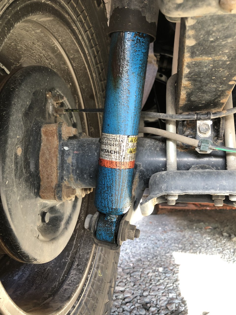

    Bill
    2017 TRD Sport
    Had the truck parked while away for the weekend. Noticed this morning that the driver side rear shock is leaking. Had an add leaf installed when I put in the levelling kit. Would this be the cause?

    Addaleaf should not have caused that. Not unless shock was over extended. But you do need a new shock now. That one is toast.

    I will say that the stock shock limits the range of droop in the rear, so like most of us with lifts you may be fulling extending that shock when off-roading. So maybe.... sometimes the seals give- mileage may very. I also developed a rear shock leak on a bilstein so it is a good time to be looking at getting a shock back there that is longer than the OEM unit anyway.

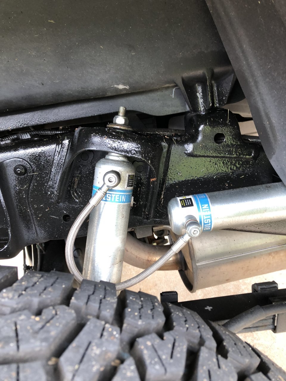

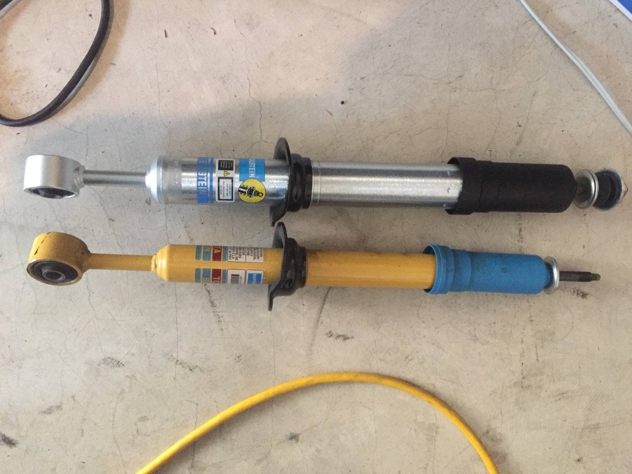

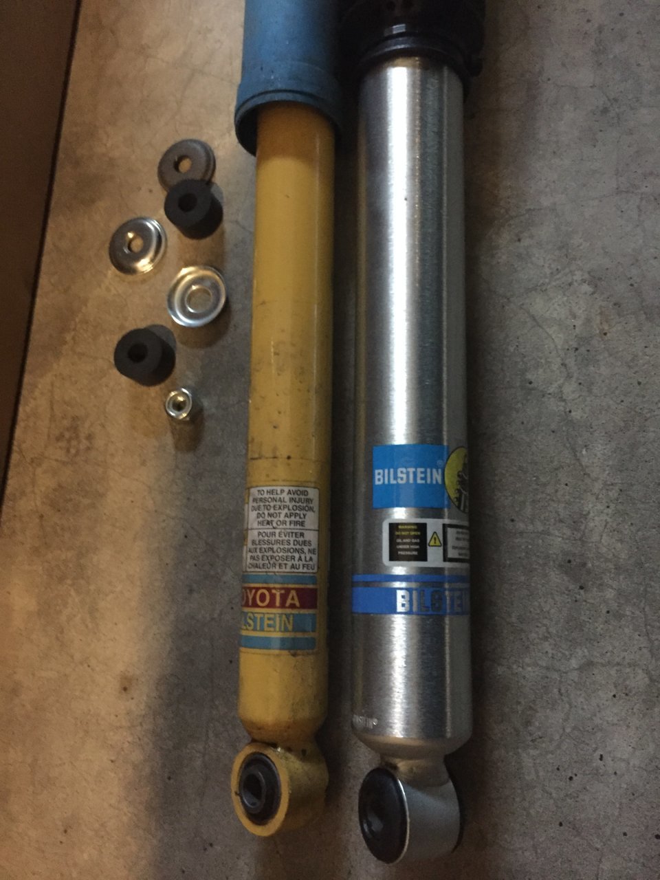

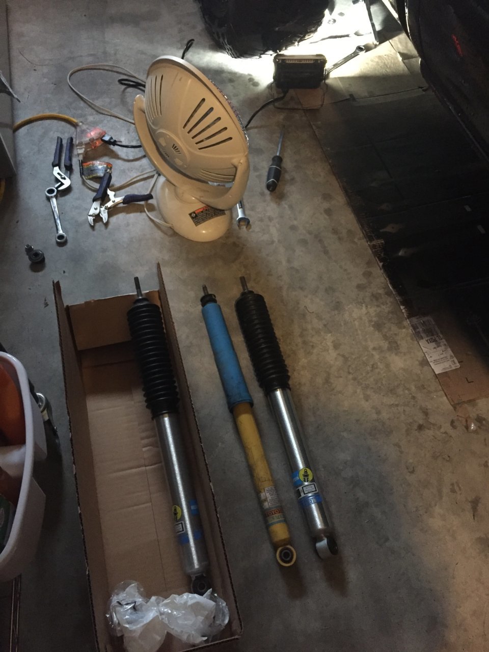

    2017DCLBOR
    5100’s are a bit larger than the stock Bilsteins while providing a firmer ride with less lean and roll in curves.
