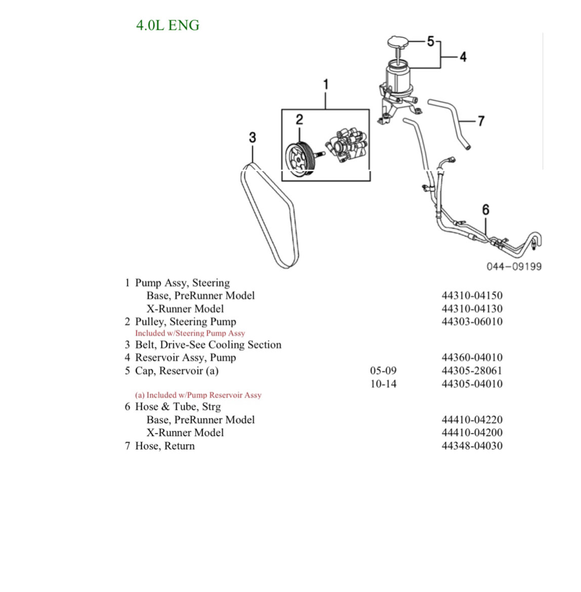

    05 4x4 V6 I have a leaking steering pressure line. I intend to have all (4?) the steering lines replaced.
    1. What is the designation/name of each hose?
    2. Should I also replace the reservoir?
    3. Do the belt & pulley need to be removed?
    Many thanks,

    1. See picture below
    2. I would not, Not if it isn’t leaking?
    3. Yes, I would remove the belt.
