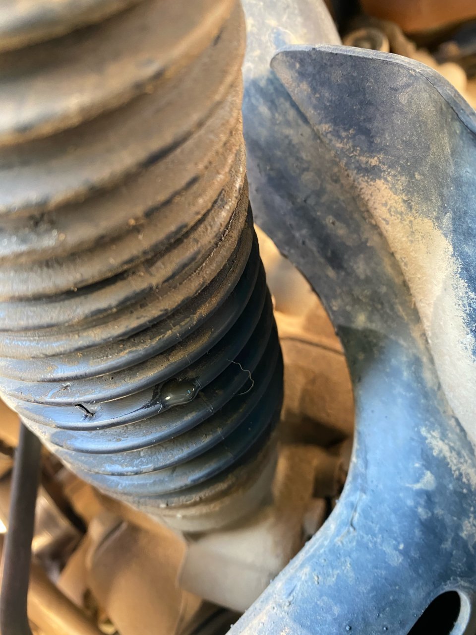

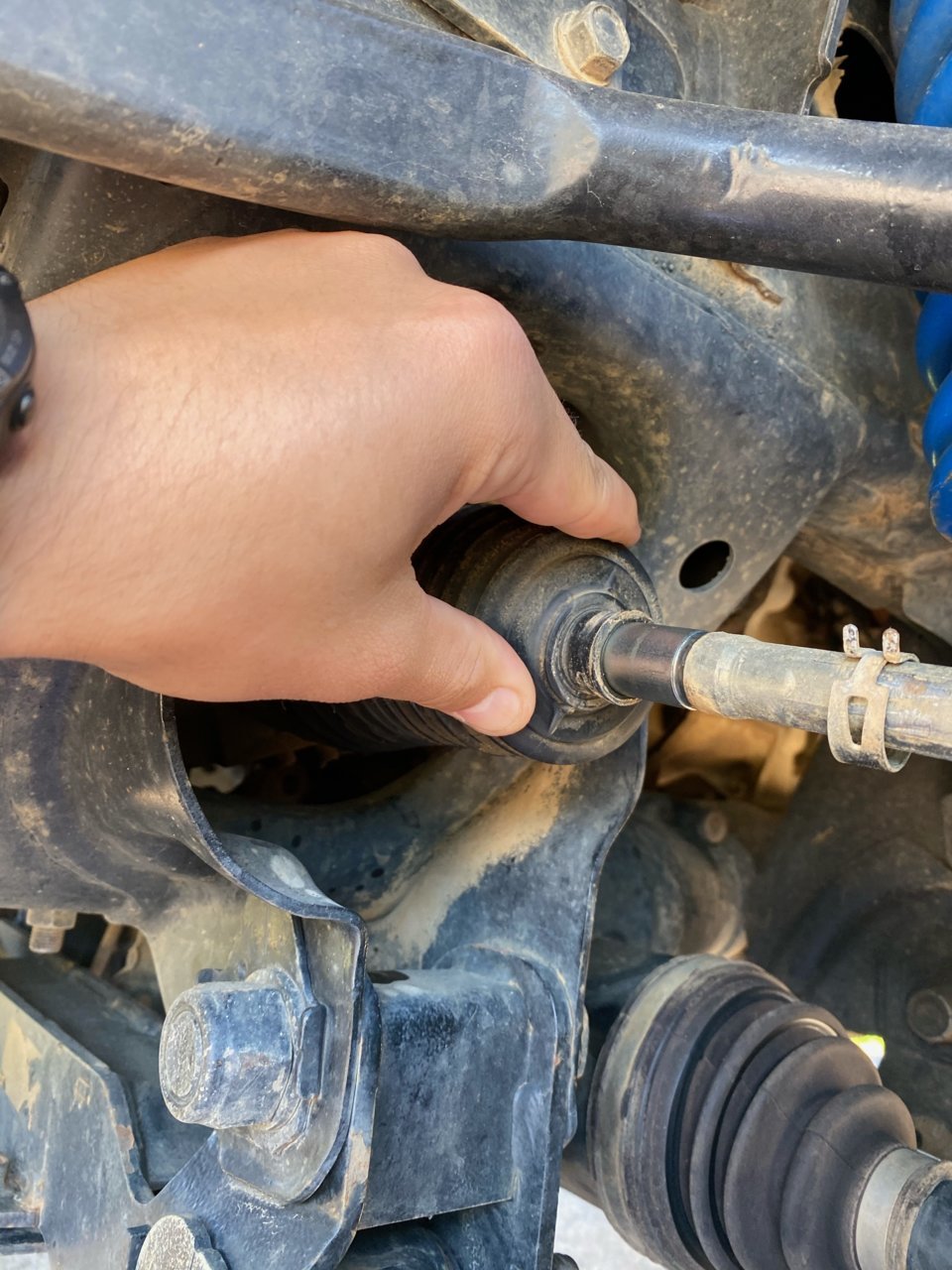

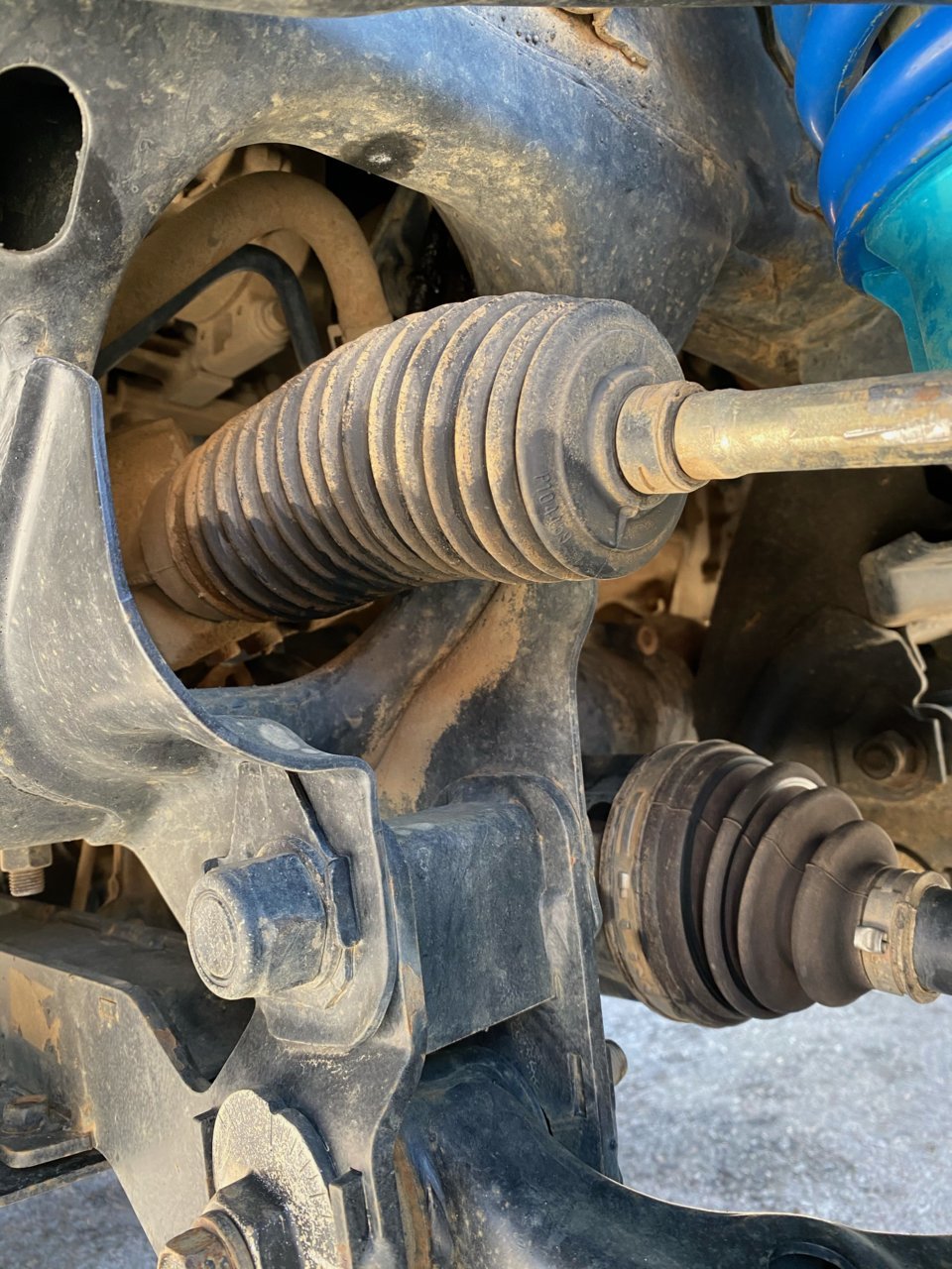

    Noticed some grease on my boots so I decided to poke a small hole in the bottom to see if any fluid would come out. I got a small little dribble, nothing major at all. Pulled the boot back to see if any would come out and none did.
    This morning I noticed some leakage on the frame under the hole. From the pics below, do you guys think its time for a new steering rack? I just find it hard to believe that the seals would go out this early.

    Sure appears a rack seal leak. Kind of strange unless the boot allowed dirt to get in. I had about 75k on my tundra before the same seals began leaking...when i pulled it apart the seal was covered with fine silt.

    How big of lift do you have & how much high speed semi rough road have you been playing on? You'd be amazed how much load / deflection is placed on the bore of that cast aluminum housing your rack is made out of.

    Tire/wheel size also have a big impact. Based on the pics, it looks like it's wheeled often,, which is fine, just gotta assume the risks involved.

    I think mud and silt/dust getting past those rubber boots has a lot to do eating those seals. I live off a 2 mile dirt road that gets very nasty in the spring. It can't be helped getting all sorts of mud/dirt, and fine sand in there. My rack began leaking after a few years of this....just year or so after the warranty expired. Funny though the newer style toyota aluminum rack never had a problem till the day i sold the truck some 13-14 years later.

    They absolutely won't cover it and they absolutely will blame your 35's lol. Sorry to say. These leak with stock tires easily enough, let alone 35's.

    Look at his CV boots. Id say he has a lot of lift..

    Yeah 6 inch lift. My CV's are actually almost flat because of the diff drop though.
