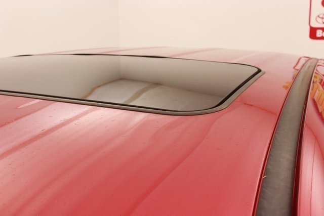

    I have a 2006 DoubleCab with a sagging headliner. I plan to remove it (myself) and repair... either repair it myself or pay someone who is qualified :) I'll also clean the sunroof drains. I found a really good how-to for removing... except my truck has a sunroof and the how-to vid did not. Is there a big difference in removing the headliner with a sunroof? I tried searching for a post that contained that pic... but was unable to find it (likely user error). Thanks for any input!

    Definitely 3rd party. Used to work with a guy that had one on an early 2nd gen AC. Solid install, looked factory too.

    Yeah, this looks factory, but I guess it is aftermarket. It has the sun screen (sliding cover) that matches the headliner... they matched it perfectly. Here is a pic of the outside (from the dealer)... I don't have any from the inside yet...

    Nope, aftermarket option.
