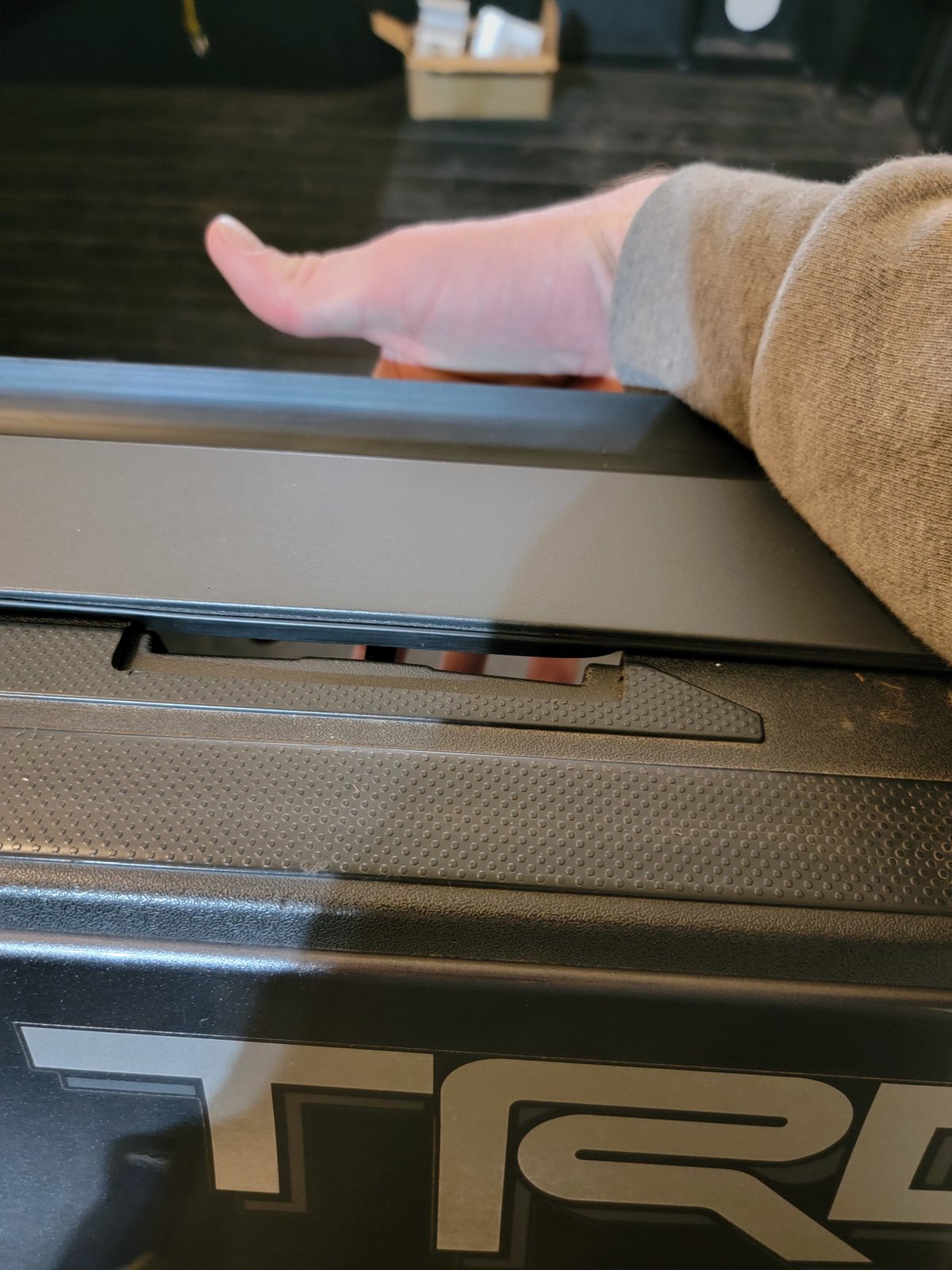

    Hello everyone,
    I bought a tonneau cover for my son's 2016 Tacoma. After it was professionally installed it is not wide enough and the holes on the top rails of the bed are outside the cover and I cannot find plugs or maybe rail covers without holes. We asked Toyota dealers and they had no solutions, we also asked the Extreme Terrain sales rep and he had no answers either. We thought there should be plugs to cover the holes or rail covers.
    I'm not sure if anyone has had this problem and found a solution or not but if anyone has an idea we would appreciate the help.

    The oem bedrail caps, don't come withhole. Take a picture of what you have on truck now.

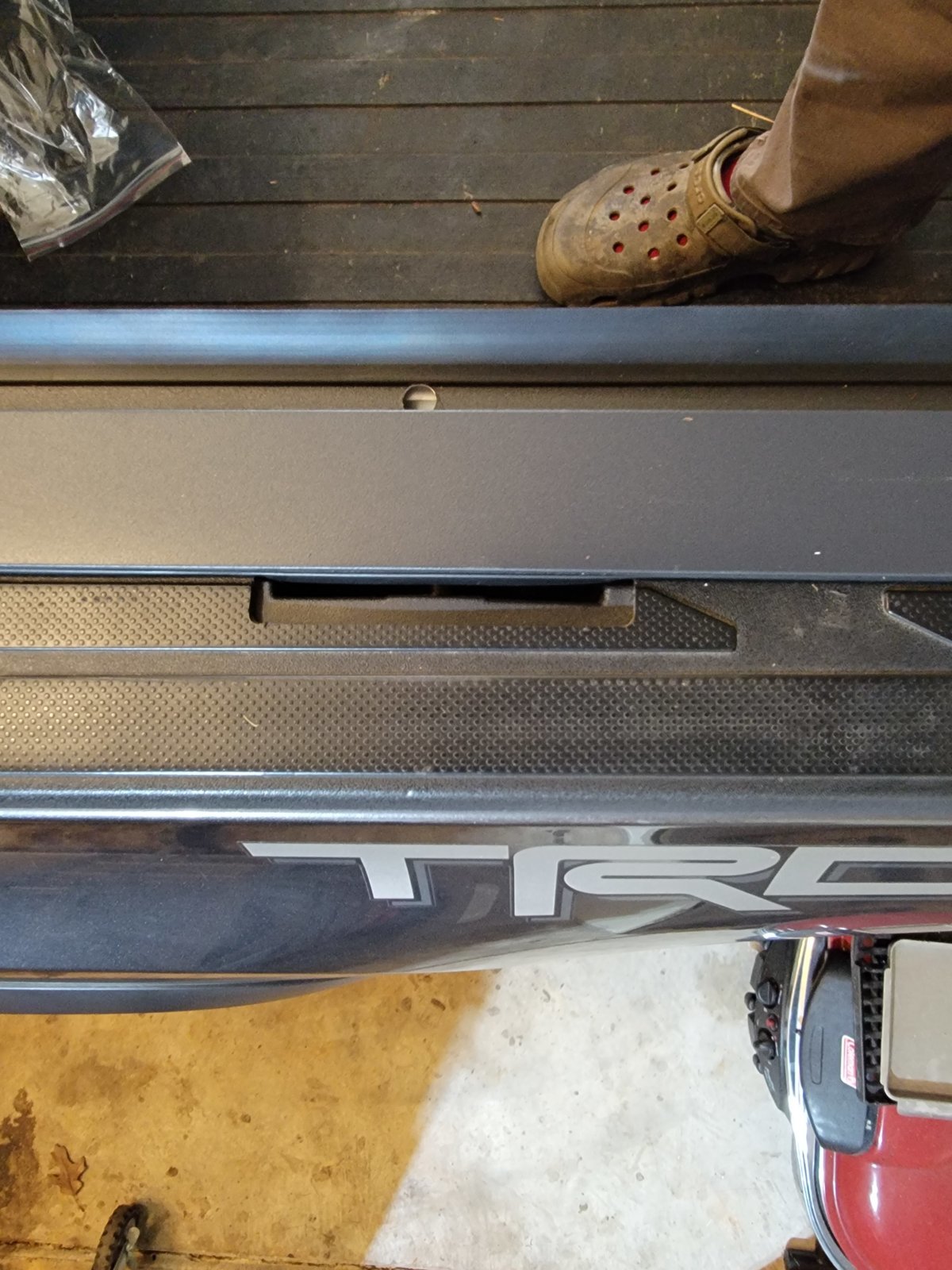

    Yeah, those aren't how the bedrails come from the factory. It's hard to tell, but I'm guessing someone had a rack in the bed. The cuts look pretty clean, but you will need new bed rails.

    Those are bed rails that come with trucks that have the OEM bed cover. You'll need to buy new bed rails as there is no 'caps' made for them that I've ever seen. You will also have to unscrew the latch bar thingy that's right there in those cutouts.

    As mentioned those are bedralil caps from oem cover. New rail caps. They run around $200+ for oem.

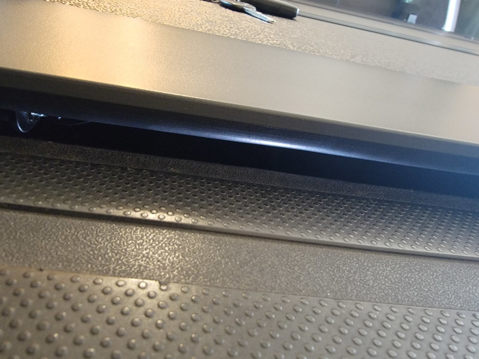

    is the tailgate at the bottom of this pic?
    there should definitely not be a gap like that if that's the tonneau/tailgate seam. granted, mine never seals fully, but the rubber seal is touching the tailgate enough to prevent the majority of water from getting past.
    this was a non-factory adjustment to the bedside rail caps. as others suggested, you'll need new bed rail caps. i highly recommend contacting junkyards for a discounted set. i've routinely searched on ebay for yards selling used tacoma parts, and then individually contact them to see if they have the parts i need. many are much more reasonable than the dealer.

    OP does have another issue, the cut top covers, that are surely creating a large leak.
