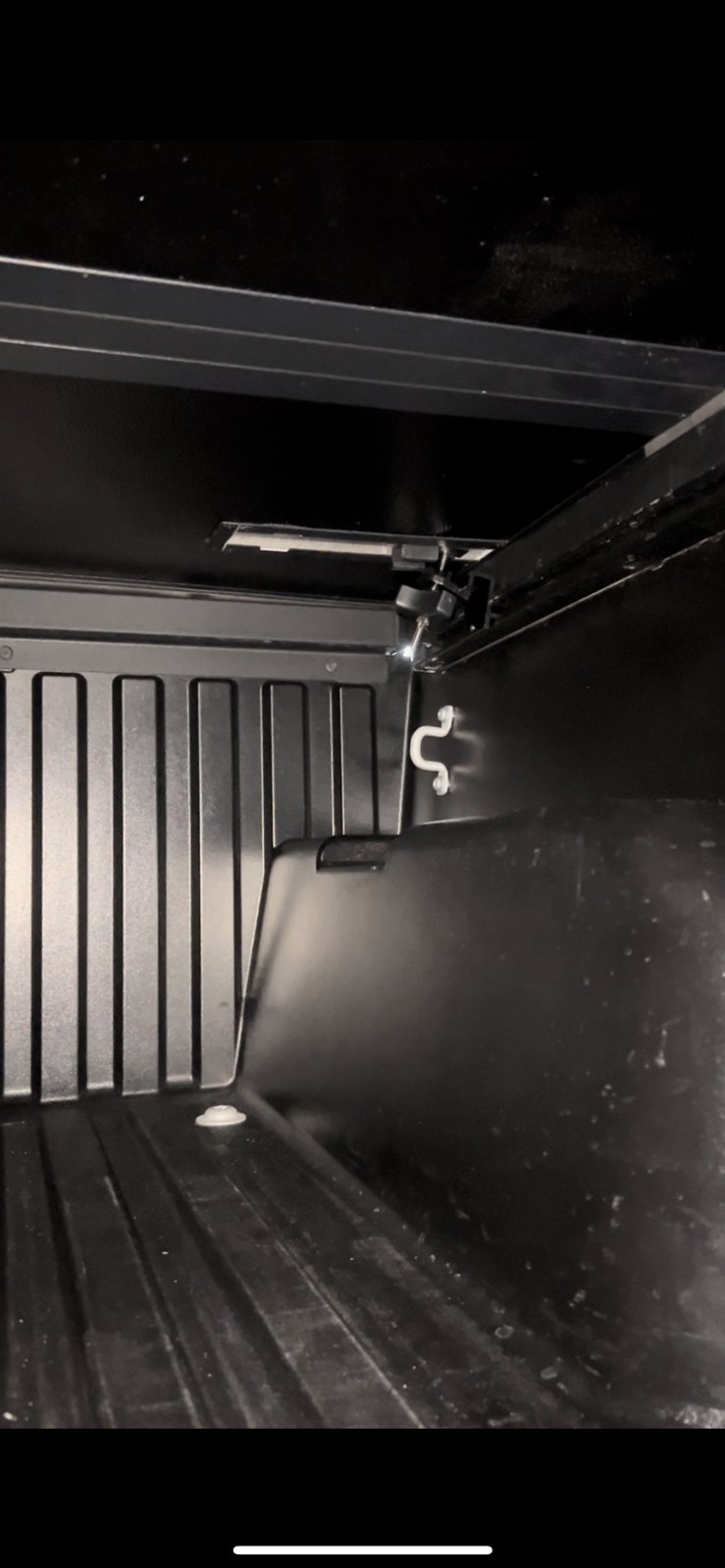

    Hi Guys! I just installed a new tonneau bed cover on my Tacoma! I love it a lot, but I do have some slight leaking in the front of the bed. Some brands like Bak bed covers offer a drain tube and stuff like that, I was wondering if there was a way I could get some help finding something similar. Attached is a photo of the area that water comes in, I used a flashlight to highlight the area.
    Thank you!

    Anyway, that sucker leaked hard for the first couple - three months. I had to constantly tweak the rail tightening and play with how it sits against the front of the bed. I ended up using some clear fuel line/ hose from Lowe's. And running that off the holes and the rail to the drain holes in the front of the bed. That helped a lot with that particular leak.
    What? I ended up doing all the way around. Was pulling it into the garage, closing the garage door, putting flood lights on above the cover and any garage light I could flip on. On. And then crawled inside the bed, close the tailgate and dropped the cover down closed. Closed. That way I'm laying inside. It completely sealed up. And then I looked for lights. If the light can shine through, the water can get through and that's a good place to start looking for big leaks as any.
    You'll find them! Good luck
