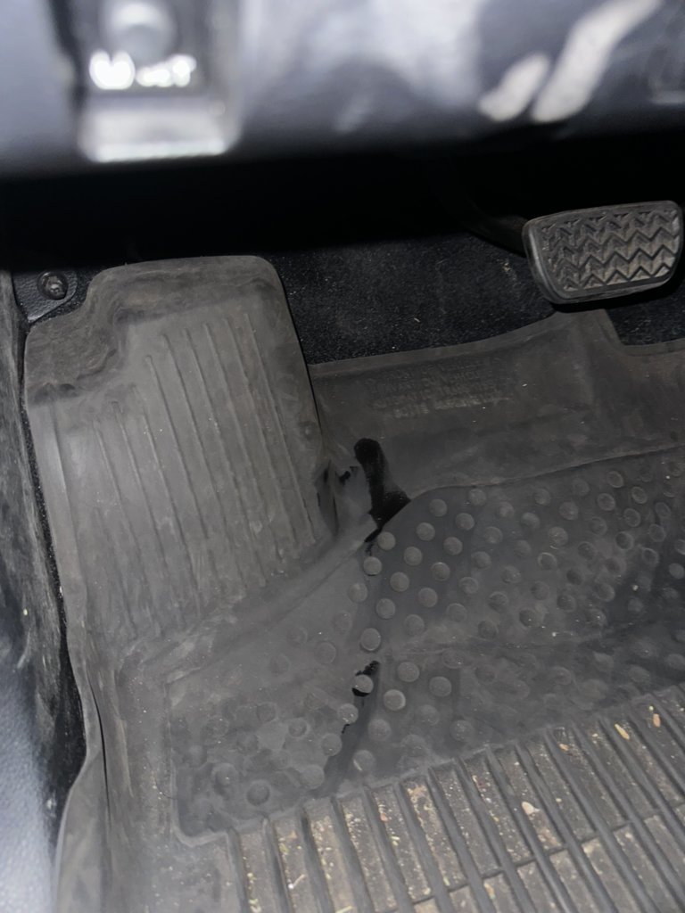

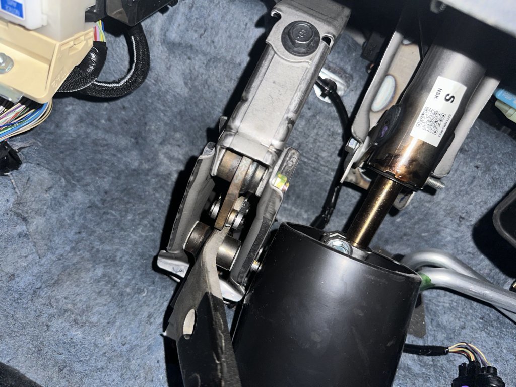

    I got home from work today and noticed a wet spot under my steering wheel near the pedals. I thought I stepped on something but it seems like underneath the wheel a part is leaking oil. Does anyone know what this is or can provide insight on what it is or what can be done to fix it. Any information is greatly appreciated thank you for your time!

    Oil separation from the steering column grease. I haven't had it but you're not alone.
