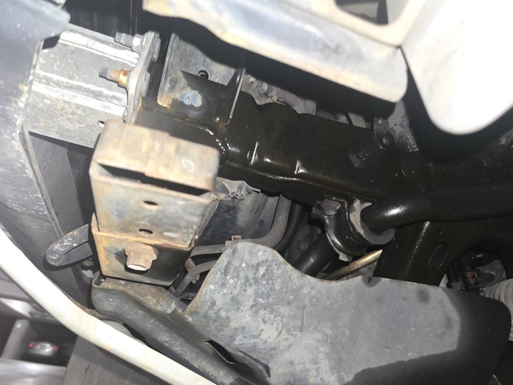

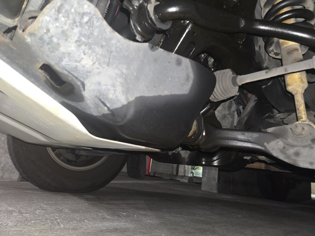

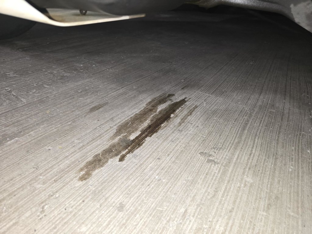

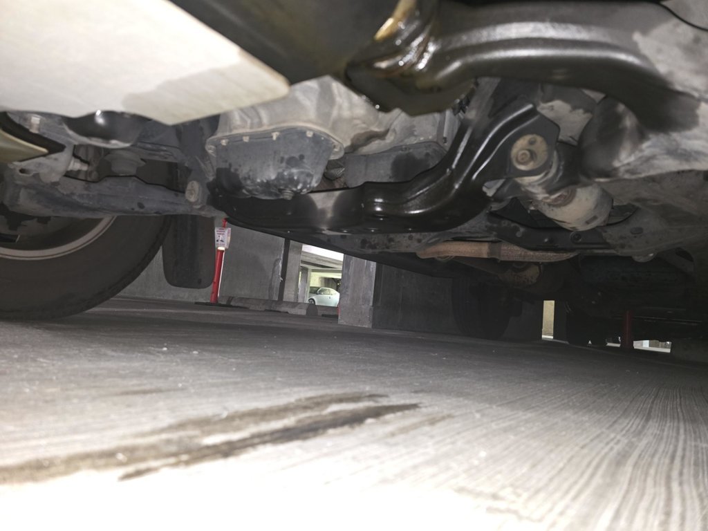

    This leak just appeared today. Any idea? It's not the drain plug. Got oil on the control arms and above the skid plate. Forgive my ignorance as I'm not a mechanic. Any thoughts appreciated. Thank you.

    I'd start by checking fluid levels. Specifically, power steering, brakes, and oil.

    Betting coolant being that far forward on the frame.

    Check your oil filter/cooler, see if it’s leaking that high
    definitely looks like engine oil

    The oil filter is right above that area
    Have you popped the hood? Look around the oil filter stand

    Thanks everyone. Turns out the oil filter had a small hole. Probably from the filter wrench teeth. I've done countless oil changes, never had this happen before. Hand tightening going forward. Lesson learned.
