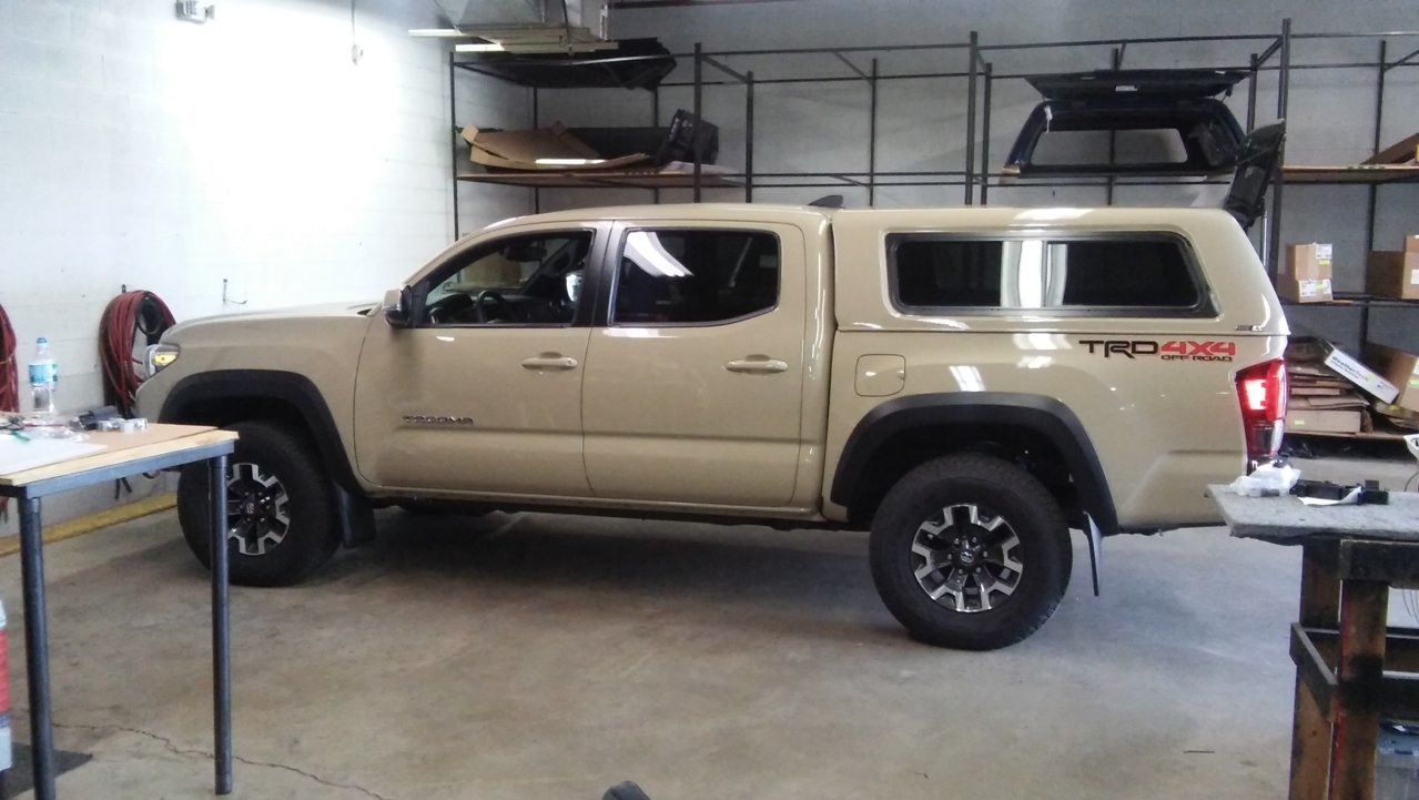

    Just got my new ARE top installed and 1st rain the inside under the side windows soaked with water along the backwall. The installer is 1hr away so I guess this is on me.
