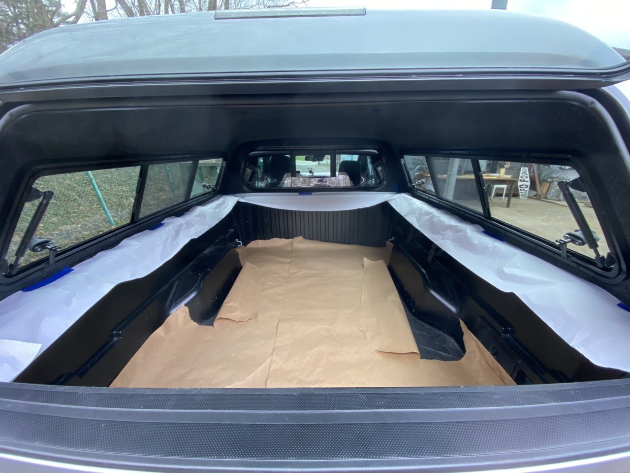

    Found this thread while searching for potential solutions to my cap leaking issues. Just had a BRAND NEW ARE MX installed on Friday (Windoors, carpet and sliding front window). When I inspected the install I was impressed, they seemed to do a great job sealing the front spots where people get water. I left happy and excited!
    That night and all day Saturday it rained crazy hard all day. Tons of water leaked in, carpet headliner soaked all around, water on every under rail inside and dripping off the mounting clamps. Sooo much water it’s really hard to see where it’s coming from.
    Brought it to the dealer, they looked at it quick said the Windoor seals looked good, but I think it’s still leaking. Been dry for a day so I’m going to hit it with the hose and find out.
    Plan is to bring it back to the dealer every day until it’s either dry or I have my money back in hand.
    Bought this for camping.... needs to be dry
  9. Dec 9, 2020 at 5:42 AM
    #69
    JDUB-Fabrication
    JDUB-Fabrication Well-Known Member
    Aug 11, 2019
    #301850
    652
    Newburgh NY
    2010 Lexus GX460

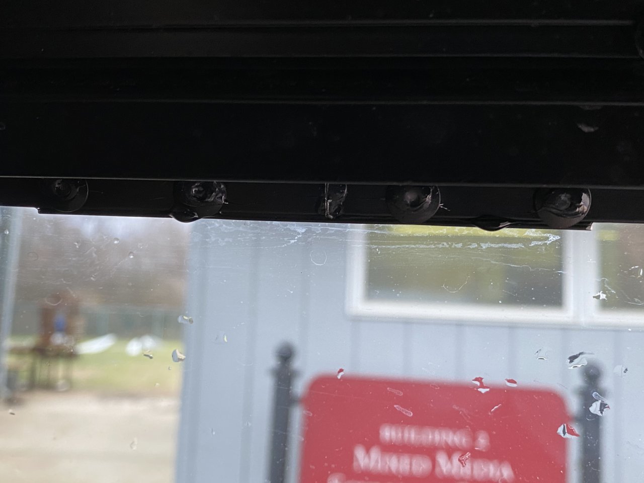

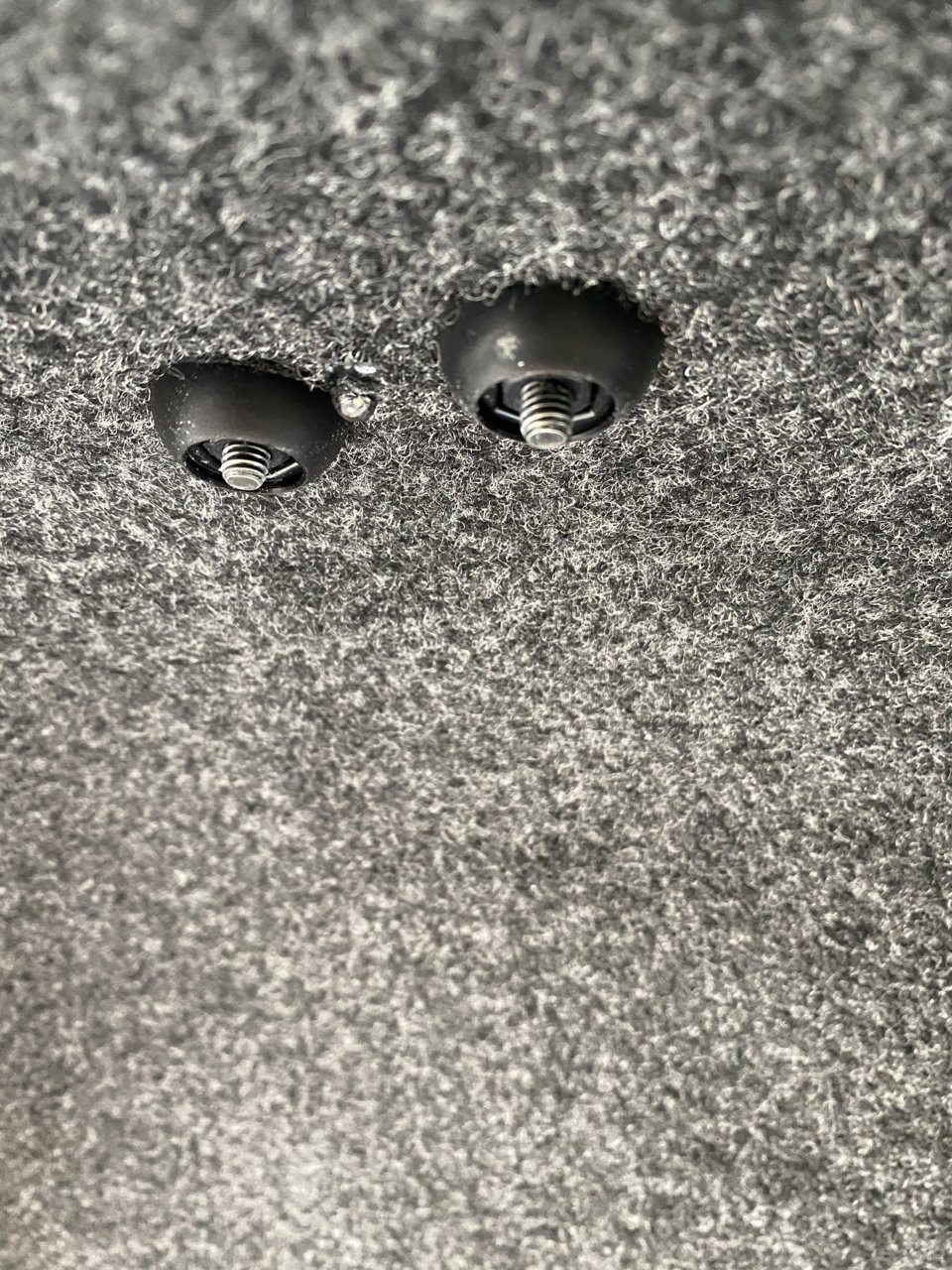

    As my above post explains, brand new cap with lots of leaks. Already had it back to the dealer once, they “checked” the seals and said it’s good.
    So I go do another wet test with paper inside the bed. Found a few issues.
    1) water coming in from the roof rack track bolts in one spot.
    2) water coming in from the Windoor hinge on top.
    3) water coming in the front spots near the cab.
    4) water coming in the back by the tailgate.
    5) under the Windoors felt wet but couldn’t find the exact spot, but for sure the Windoors are leaking.
    I went to the ARE dealer on my way home to stomp my feet and speak to the manager. Have an appointment for Friday for them to go over the cap again...
    needless to say I am not happy, asked what the process for getting my money back was and he looked at me for a second and then said ARE doesn’t really do that. He said to speak to corporate, then I said well they say to speak to the dealer, he laughed and said oh yeah they usually say that... WTF
    On my way out I said, well I’m going to keep coming back until it doesn’t leak.
    (I understand some of the issues are not the caps fault, like the tailgate and maybe the front two spots, but the Windoors and roof, oh hell no.)
