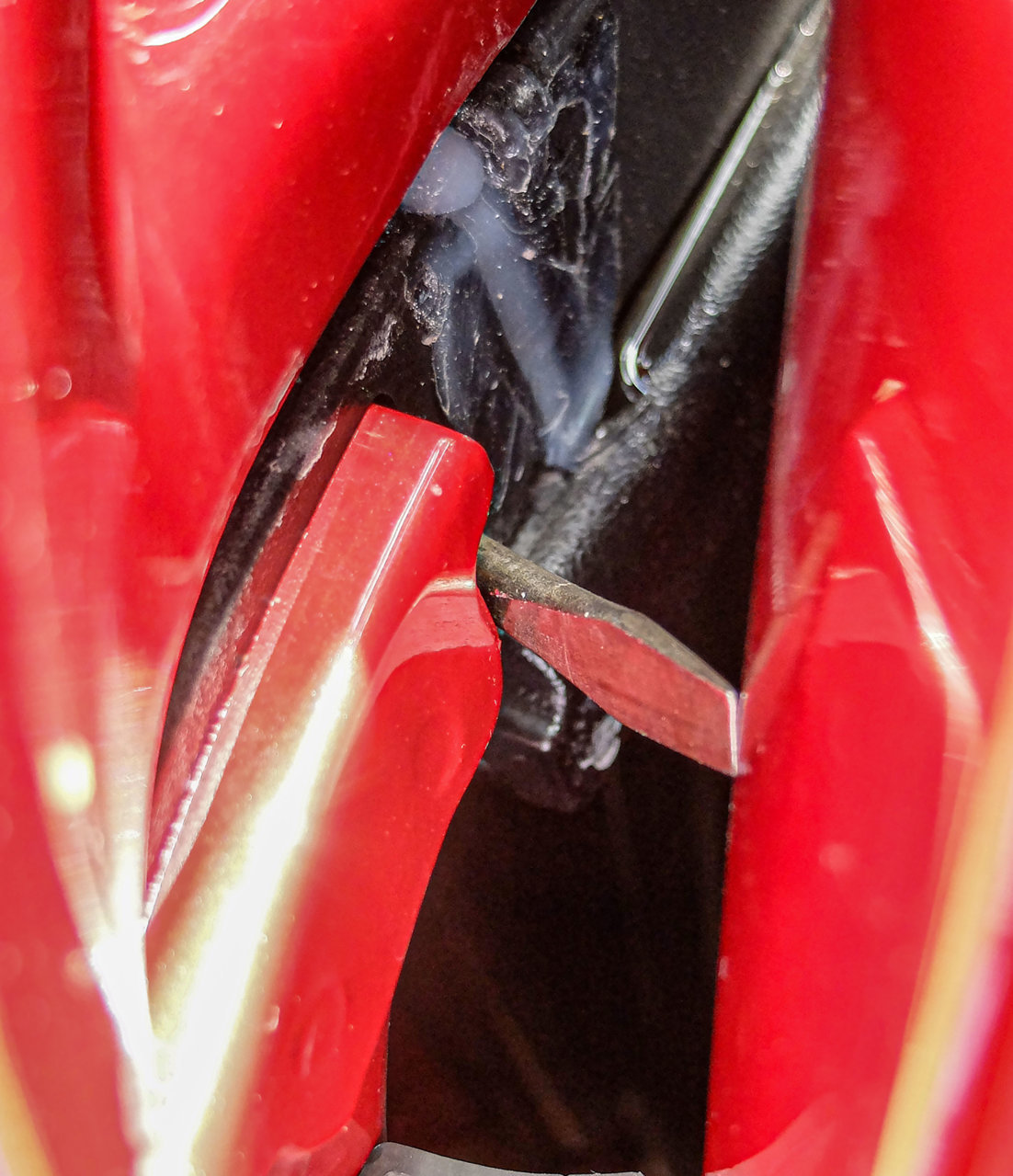

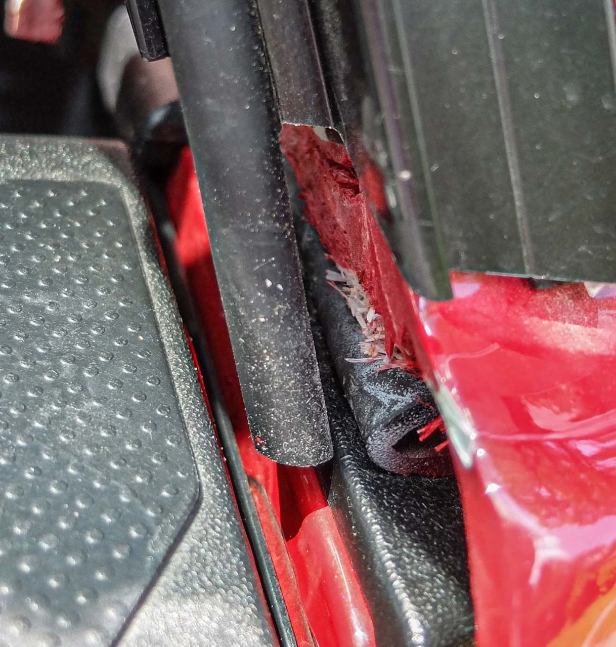

    Brand new Century installed correctly. First rain, windows leak at clamps?
    No. Water runs along rails to clamp.
    Looking underneath with a mirror and flashlight: gaping hole front corner(Pic 1 & 2). I stuck a screwdriver through to confirm what I was seeing.

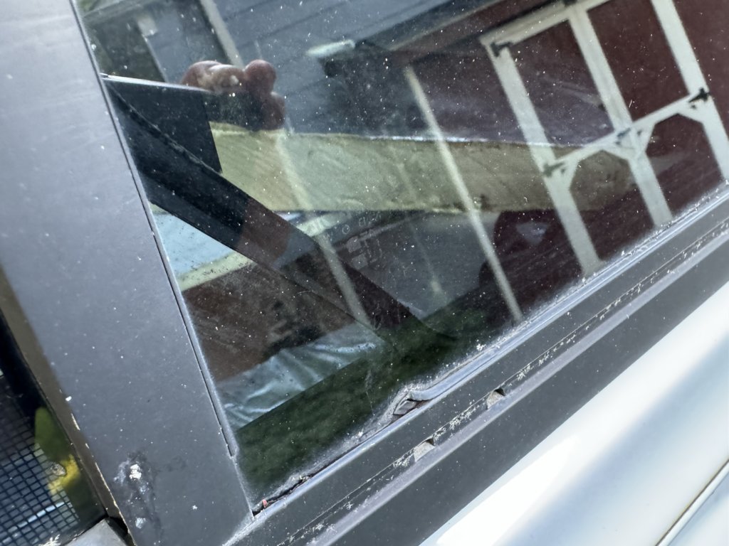

    That lead me understand that the corner in the back window was leaking forward to the clamp. (pic #3)

    Photo tip: Start with you closeup as shown, then back up a foot or two or three & another pic from that distance.....I don't know what I'm looking at !

    That's normal for Tacomas. Gap at the front corners

    I’ll stick something we use in the building trades – foam backer rod – in the front gap. If that works, there’ll be no residue from tape, caulk, or spray foam.
    The back window frame where the channel frame is cut short - that’s a design flaw – that goes back to the installer for a solution.
