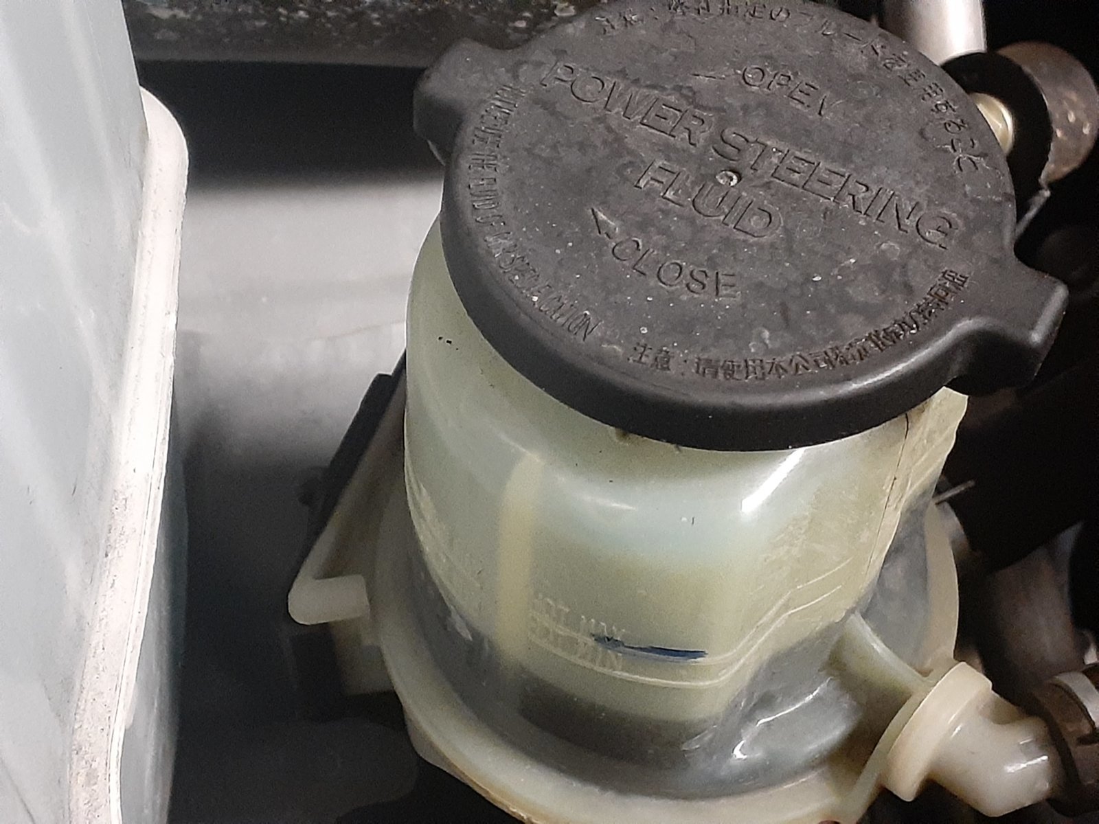

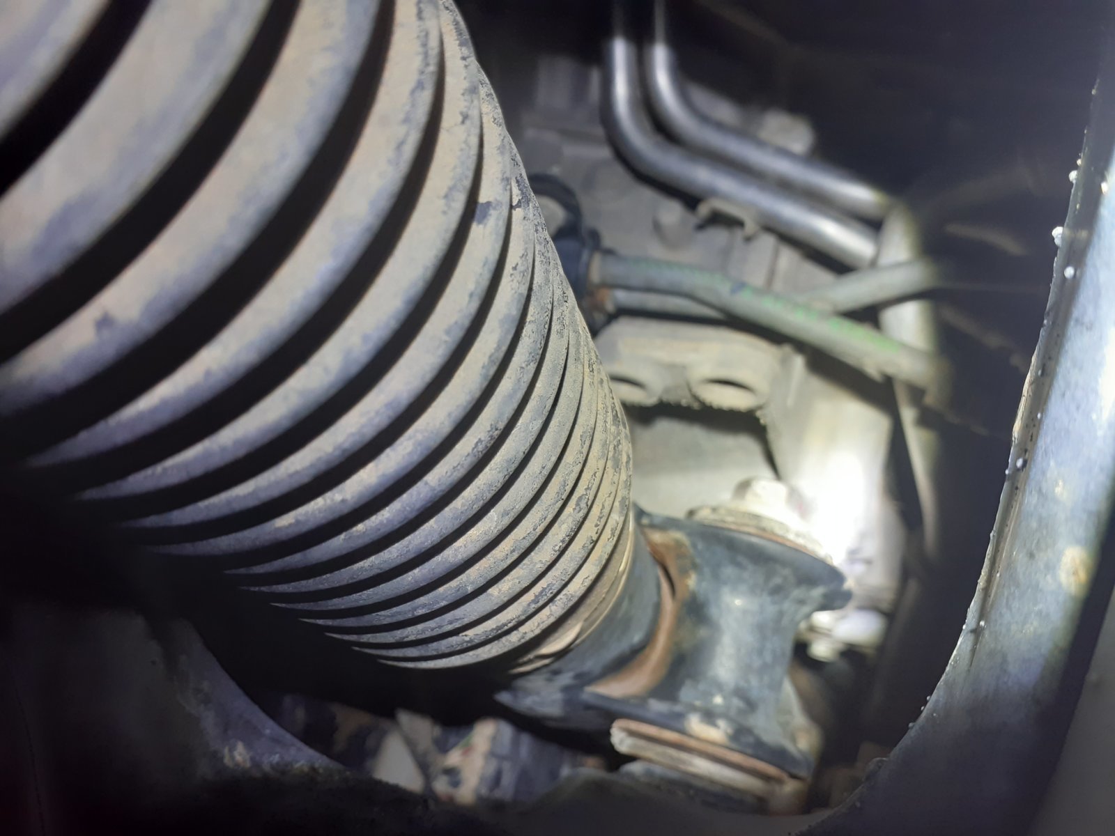

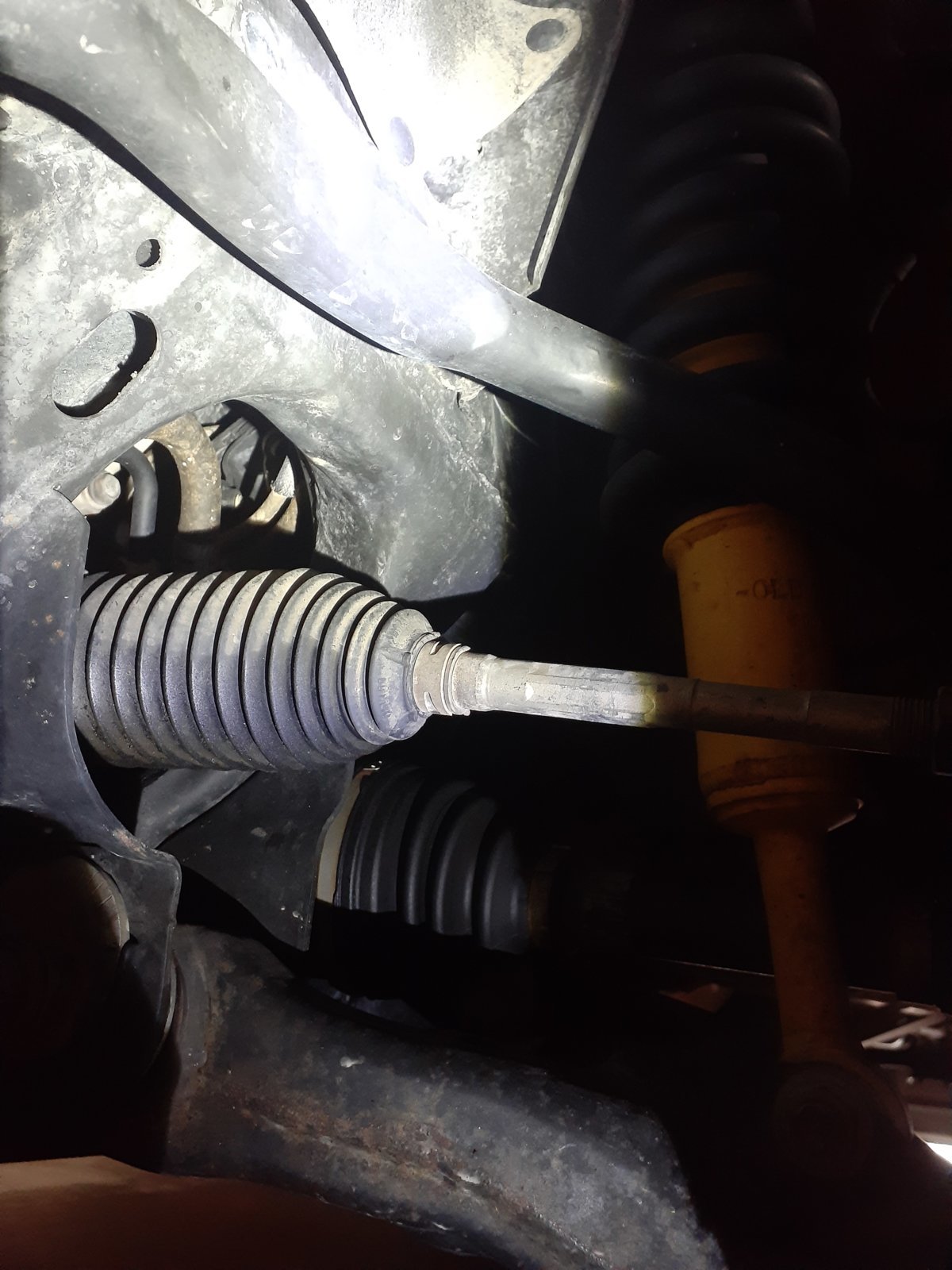

    Ok I'm noticing my fluid is low and I see a wet boot on drivers side. If this is still an issue on 2023, why wouldn't OEM new rack solve the problem? Wouldn't a new rack just present a new opportunity for another failed rack in the future?

    ^OEM new rack would solve the problem. Reman rack would solve the problem. OEM new rack is more likely to last longer.
