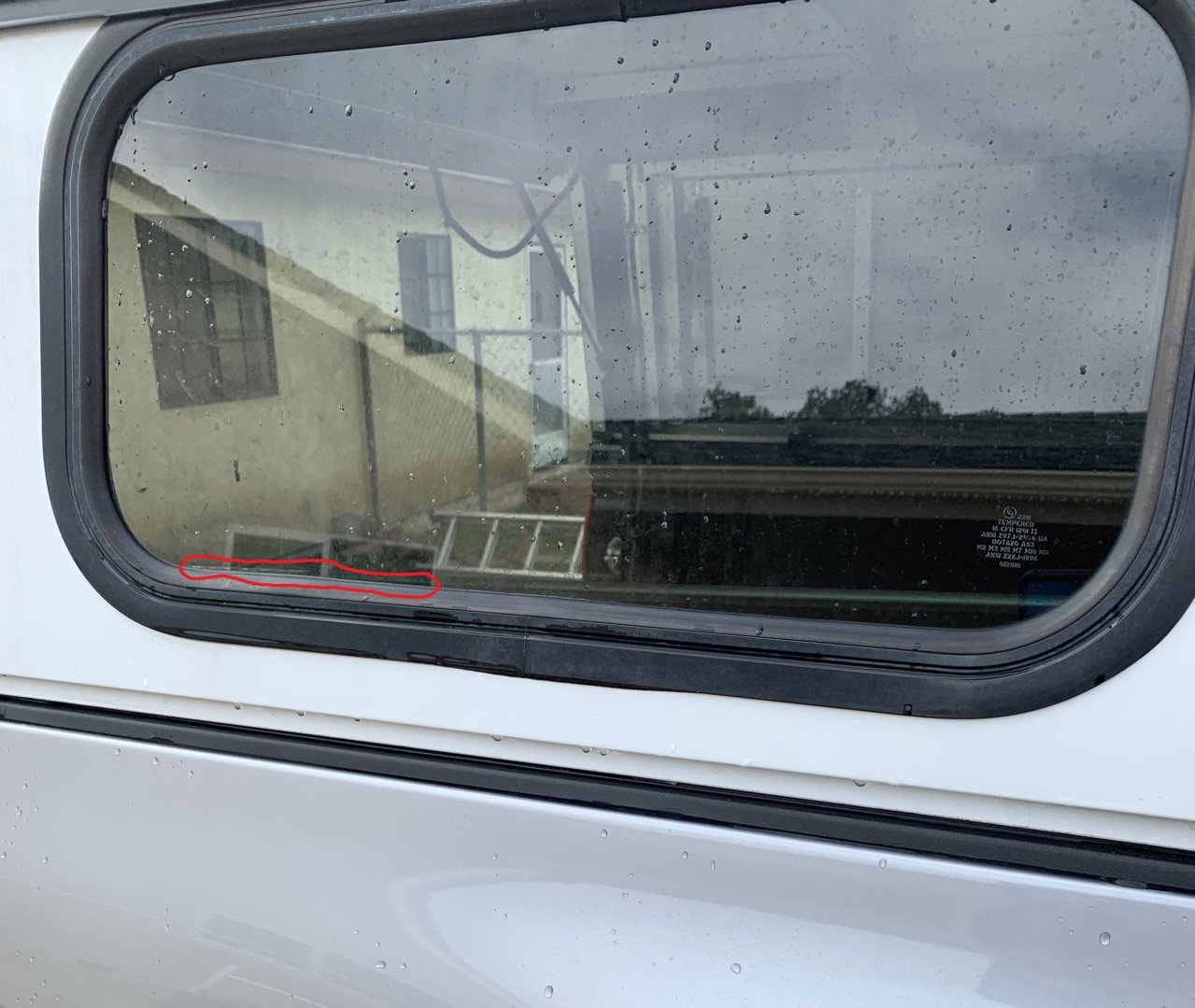

    I have a couple of leaks from my windows on my ARE DCU, the water is coming in between the rubber and glass. Best way to seal this?

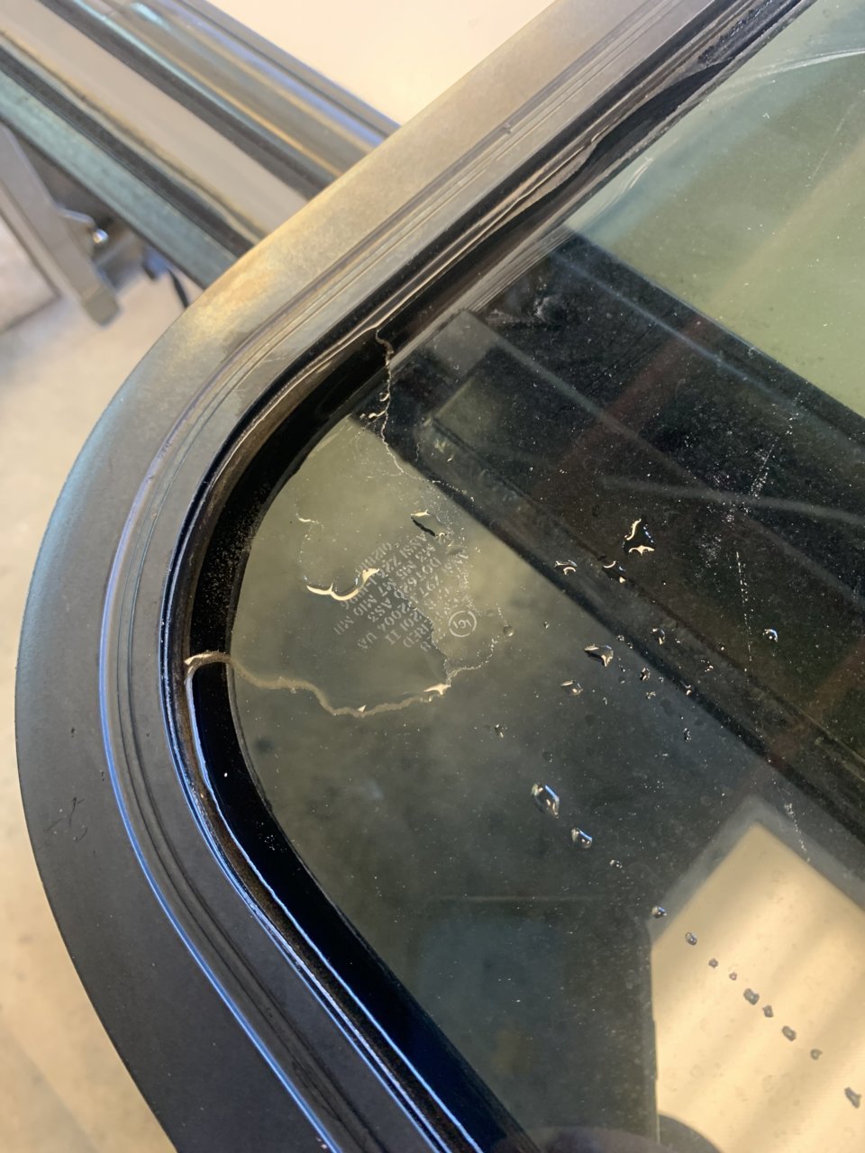

    I completely removed the window from the cap today, pulled the rubber out of the frame and discovered the window is leaking where it is glued to the frame. I poured water onto the glass and let it settle on the edge where it’s glued to the frame and it dripped from the opposite side. The pic is where I poured the water.Not sure of a fix yet
