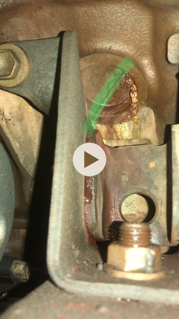

    Hi there!
    It looks like my freeze plugs sprung a leak. Has anyone replaced them on the passenger side before? It looks like a major PITA. My thinking is I can unbolt the piece above it (can someone help me identify it? I've circled it in green) in order to work on it. The tan colored piece that gets crazy hot after the car's been on. I thought it was part of the exhaust system, but when I look at that in the FSM I can't find it in any of the exhaust diagrams.
    Any help you can provide would be greatly appreciated.

    if you can take that picture you can get to it. Dont drive it in. If you can get a self tapping screw on it and tie a line to it just in case you can drive one side and it should spin then pull it out, of course much easier when the motor mount is out of the way. Putting it back in is just a s easy, socket and extension and a hammer. I would pick up 2 just in case there is a "learning curve".

    There just doesn't seem to be enough room. I can feel the freeze plug if I stick my hand in there, but there isn't enough room to really do anything.
    Is that circled part the exhaust manifold? If I pull that off is there a gasket that will need to be replaced?

    Yes indeed exhaust Manifold it does have a gasket .

    Couldn't get the exhaust manifold off. There just isn't enough space to work on this stupid thing. I see why people recommend pulling the engine out. Gonna try plugging the hole and hoping for the best. ¯\_(ツ)_/¯

    Pray tell why could you not get the exhaust manifold off??

    The short socket I have wasn't seating properly around the bolts connecting the manifold to the exhaust system. I have a deeper socket, but that was too big and I can't fit the socket wrench in where it needs to be in order to loosen the bolts ... though as I type this I suppose I could have used an angled piece.
    Anyway, even with the manifold off, I don't think there's enough room to remove the freeze plug and replace it with a new one. The engine mount is blocking it. Seems like the only way to replace the plug would be to pull the engine out of the car.

    Unfortunately, freeze plugs usually are much easier to just pull the engine out to work on it.
    Also, you may as well replace them all.....it's just a matter of time now.

    Thought I would provide an update.
    I couldn't figure out how to get to the freeze plug to replace it, so I took it to a shop. Ended up being ~$270 to get it replaced. But now another plug started leaking, this time on the passenger side closest to the cabin. It looks like the starter is in front of it. I'm hoping I can remove the starter and have better access to this plug to replace it. Fingers crossed!

    Luckily I didn't need to pull the engine. The freeze plug in question is right behind the starter. I pulled the front right wheel off, pulled the starter out, hammered out the old plug, and pounded in the new plug!
    I followed this video to see what was involved with removing the starter, then got to work.
