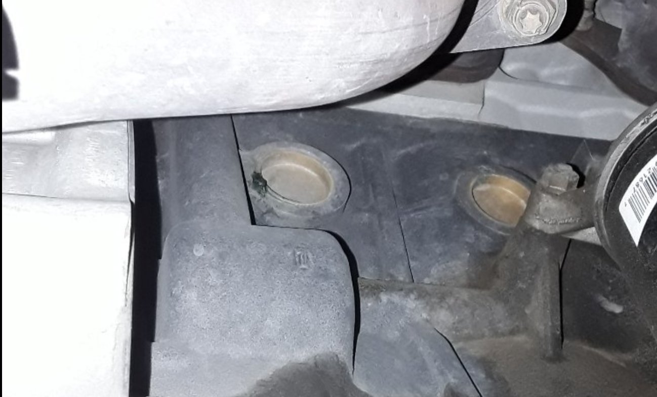

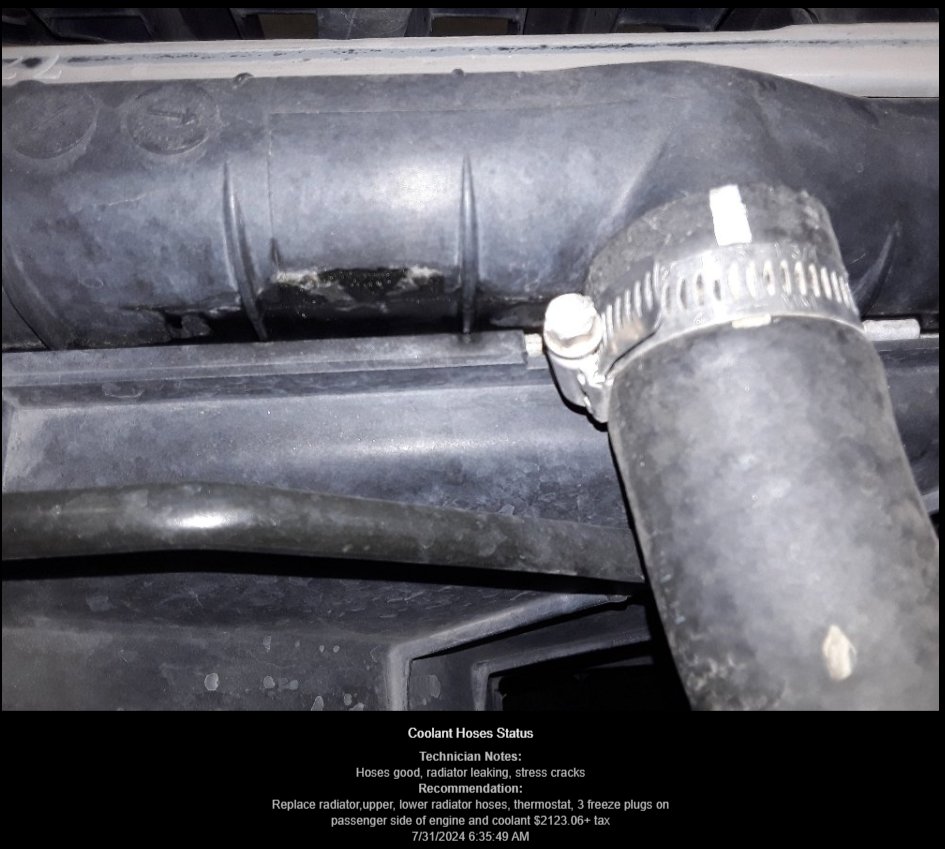

    I have my 2002 Tacoma 2wd extended cab in the shop today for a faulty starter (hit it with hammer and it starts) but mechanic also noticed freeze plugs on passenger side "are building coolant crusties." In addition the radiator has stress cracks. So bottom line is I'm looking at $2100+ for new radiator and replacing the 3 freeze plugs on passenger side. Not immediately clear to me whether there are plugs on drivers side too. A fair portion of the price is related to the PITA factor of accessing the plugs.

    Id get a 2nd opinion on that and radiators are ALL shyte and cheap these days

    Those freeze plugs look like they're fine to me. I wouldn't worry about them until one springs a leak.
    You can get a new radiator off rockauto for pretty cheap too. Swapped mine out in a day, wasn't too bad.
    I'd find a different shop for sure.
