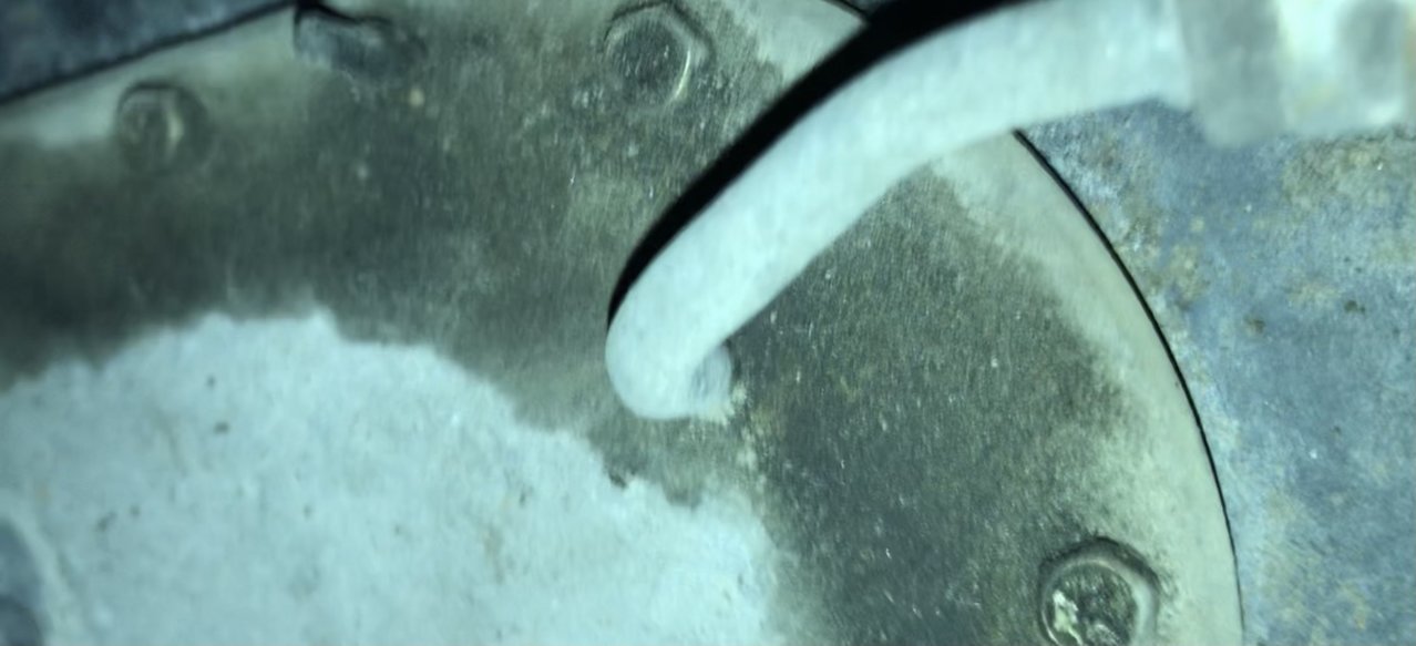

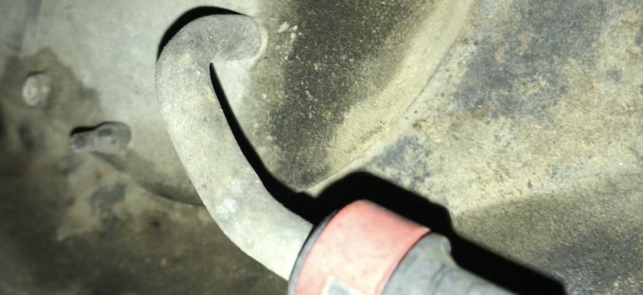

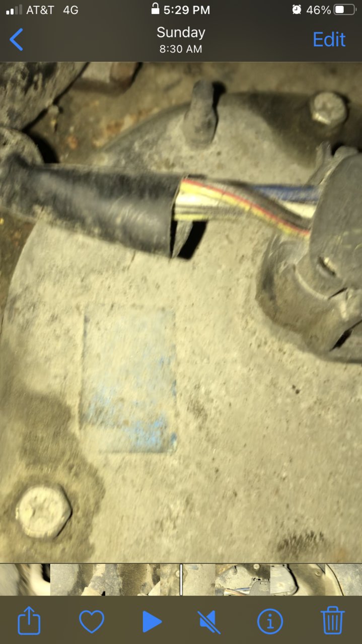

    Heya-
    Got my first Tacoma a few weeks ago and I’ve been trying to pull ‘er into shape. Hoping to get some help with this issue. I noticed a persistent smell of fuel when the tank is full. Stuck my phone up there and took a little video all around the tank and noticed some fluid up around the fuel pump. The local dealership quotes me 2k to fix it so I was hoping there might be a safe and cheaper solution to this. I’m not a mechanic, but working on learning what I can. If you got some advice, plz give it!!

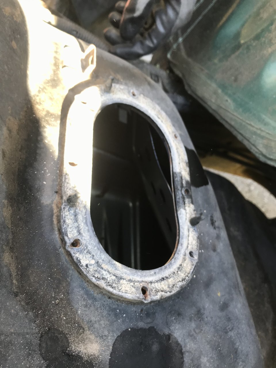

    There are a number of rubber gaskets and hoses attached to the gas tank. You could pay a mechanic to do a smoke test and try to figure out what's leaking, but you're better off just replacing everything in one go in my opinion. As stated above, pull the bed or drop the tank. There will be 2 or 3 gaskets on the top side of the tank, a fuel filler neck, and a bunch of evap hoses. I did this job last year, here are the pictures I took of the process:
    https://www.tacomaworld.com/media/albums/2020-12-gas-tank-decrustification.63925/
    Here are the gaskets I used. If I was going to bet I'd say it's probably the big oval gasket for the sending unit that's leaking.

    Are sure its not the fuel line quick disconnect.....I dont see leakage around that sill..
    It looks to be on top of that plate.....
    or is it seeping out of the bolt holes?? And if so can you gently tighten them...

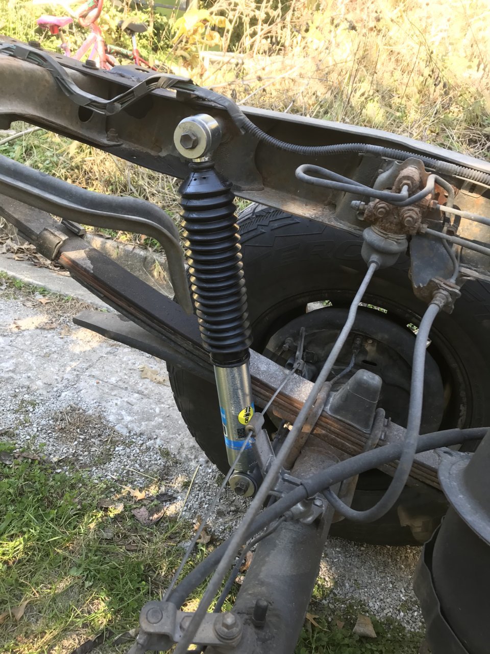

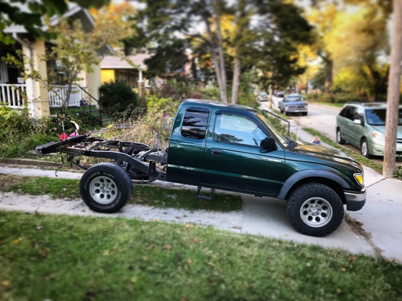

    Popped off the bed, replaced the gaskets, even threw on new rear shocks while I was at it. Honestly, everything looked a lot better than I feared. The leak is fixed and I saved a bundle. Thanks for all the help!!F123EA08-A321-4424-9FF8-3EC3E0CA8C84.jpgA69B904C-3109-4A0D-9684-59B864C808DC.jpg3826C5FA-FA5C-4A3A-8C16-69FA678FDD55.jpg
