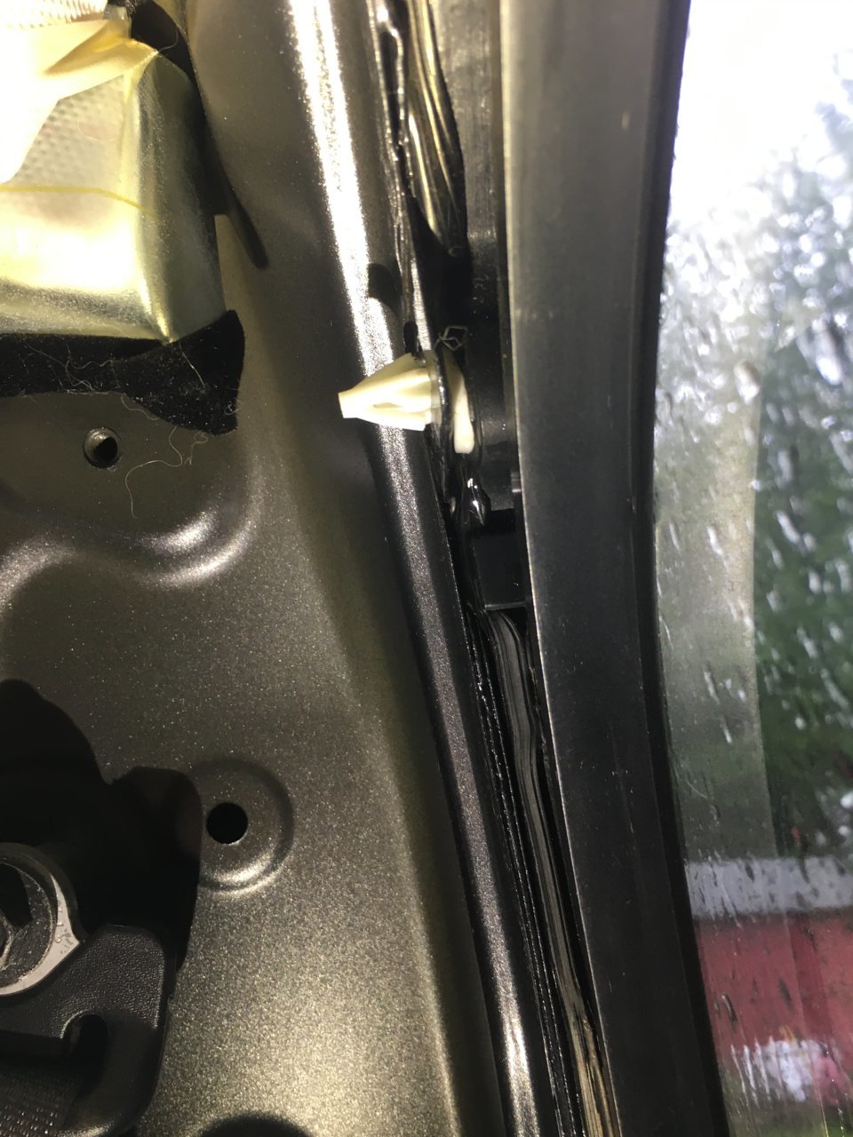

    Many have had issues with the third brake light. I was convinced I had the same issue but had to keep investigating after I replaced the third brake light and kept having water come in. Figured out that it was coming through a tiny hole in the window glue in the top corner. Hard to tell but there is a small bead of water right under the white clip.
    I ended up getting window sealer from napa and getting at it from the outside (had to pull the roof or window molding back slightly to access the area). No issues since.

    Thanks for the reply and glad you found your issue. It's hard to visualize that spot. You added this sealant around the whole back window? I might pick this up today and put this around my brake light and window and see how it goes.

    Its not the best picture; its at an angle looking towards the passenger side, and up. I had pulled my plastics out, and the headliner down. That white clip is easily visible if you pull the headliner slightly where it meets the plastics.
    When I identified the area it was coming from, I waited for a dry day; on the outside I started searching for the spot by pulling back the rubber window trim. Where that trim meets the roof molding, underneath there is a small piece if foam. The pinhole was directly behind that. I pushed the foam aside for some clearance; cleaned up the area with an isopropyl alcohol pad, let it dry and went at it with the sealer, just in that spot.
