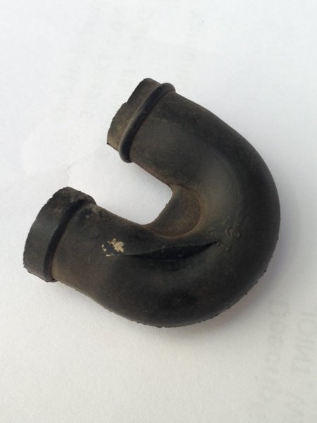

    Here is a close up of the original U-joint, 85376-06010.

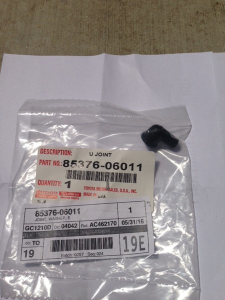

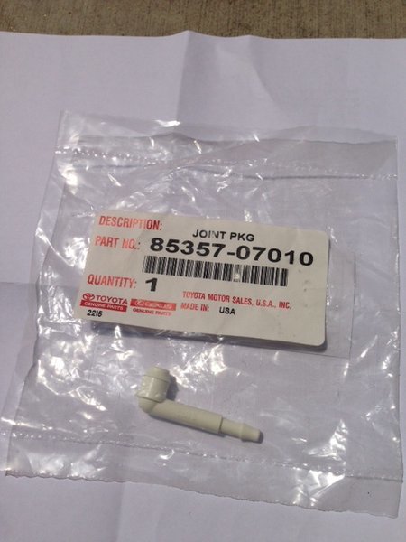

    This part has since been replaced by these two parts.
    U Joint 85376-06011
    Joint, Washer, C 85357-07010

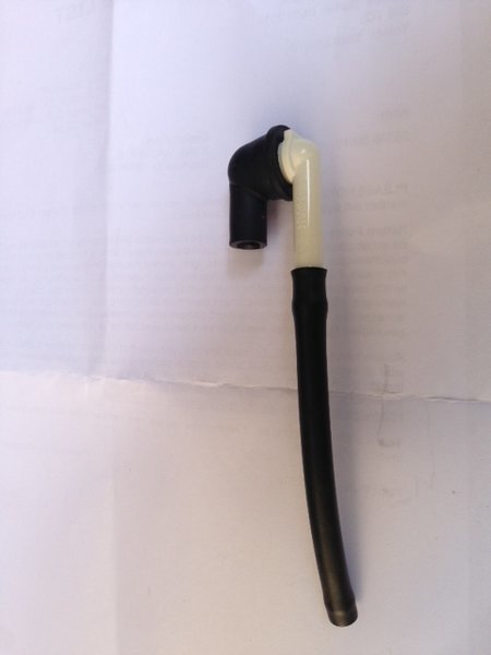

    Here's how the replacement assembly looks.
