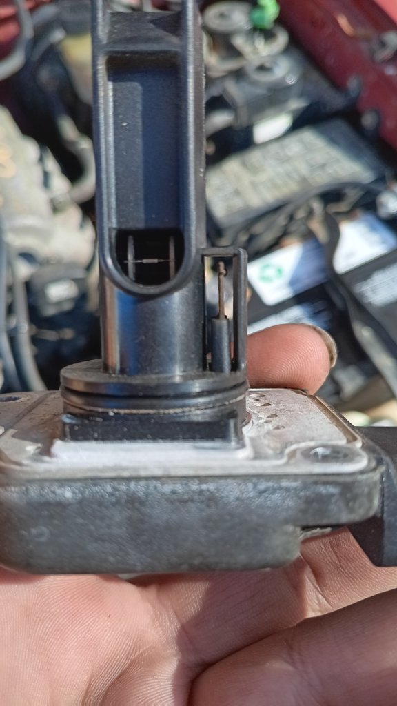

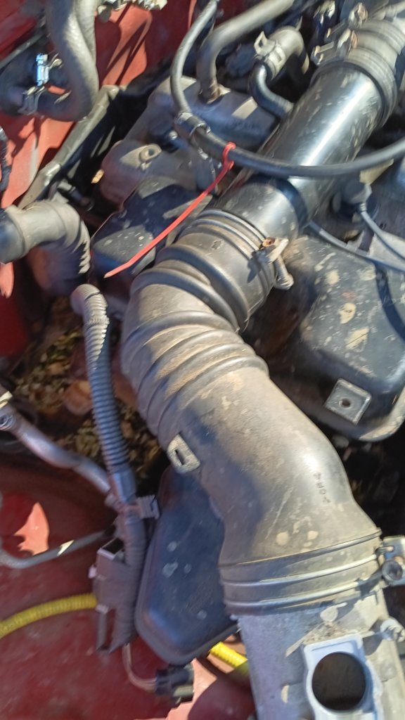

    Picture of MAF sensor and intake hoses. No cracks or leaks there.
    Also, forgot to mention, oil smells like there's gas in it.

    That MAF has seen better days. It's worth a can of maf/electrics cleaner and you'll see how much crap is built up.
