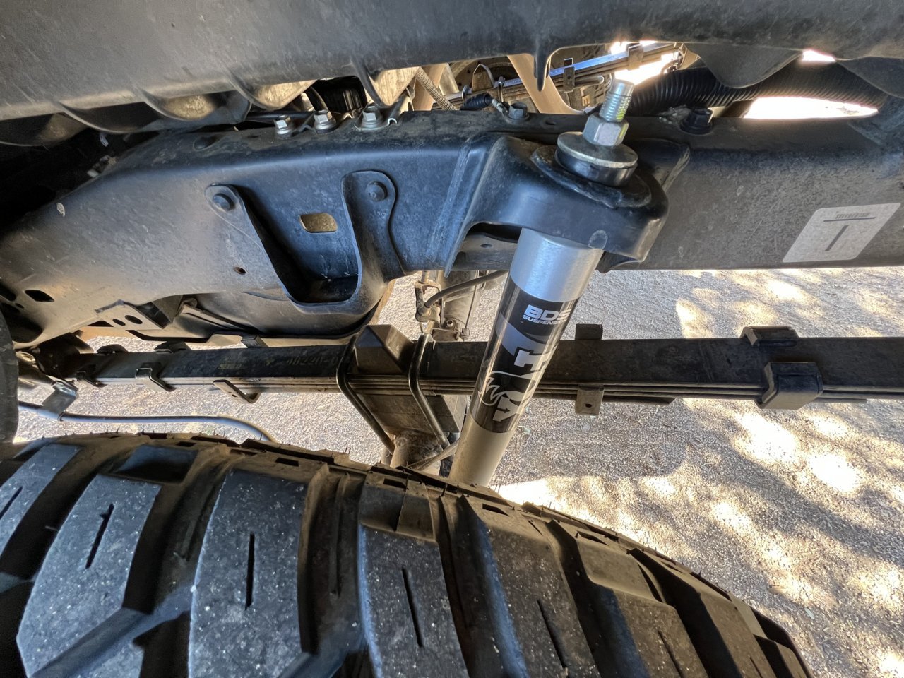

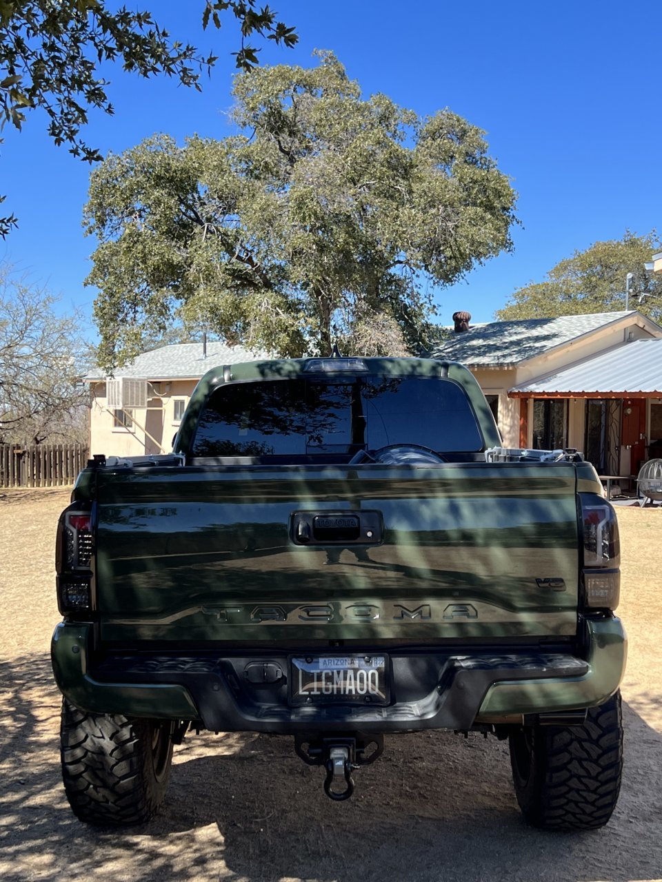

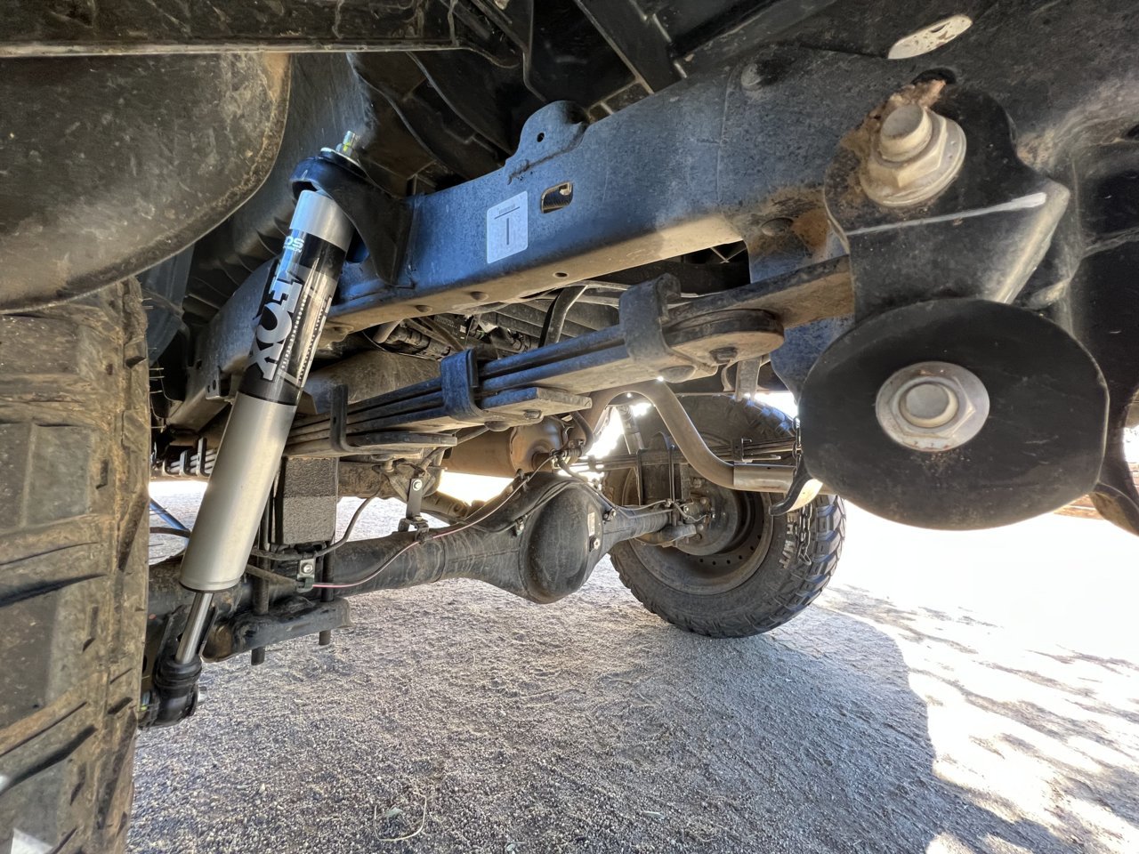

    Hi, first time posting here. I recently had a 6” BDS lift kit with fox shocks in the rear installed on my 21 Tacoma. No issues, drove for about a month so far all over the place on/off road. except yesterday after getting back from a mild fire trail, i noticed the back left is sagging about 3 inches lower than the rest of the truck. no apparent damage, didn’t off road very hard, crawled a couple burms but nothing crazy. Not sure what the issue is here, no fluid leaking from the shock, no broken suspension parts that i can see. Any ideas? edit: pictures attached below

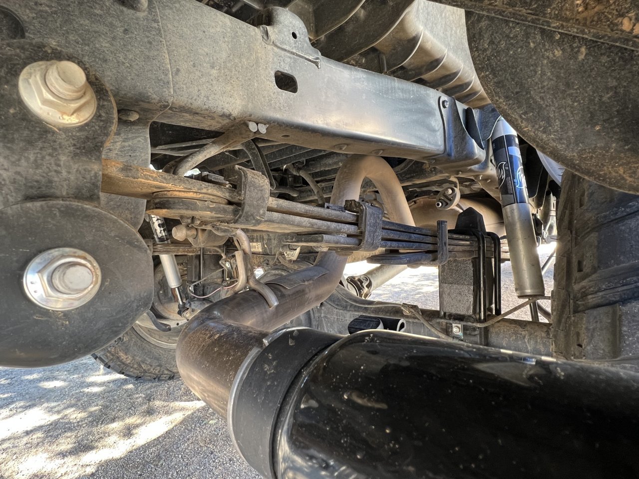

    photos attached 7214E1D4-9ADC-4661-AA97-FE35979A959C.jpgED82688B-D9F1-45A2-9906-55F1E9A339B8.jpg D5542C94-81E1-4E35-9F97-9BF572F1E281.jpg

    Wow. Either something is bent that i cant see, or its the leaf pack.

    Leaf pack looks more compressed then the other side, add some picks of the passenger side to compare.

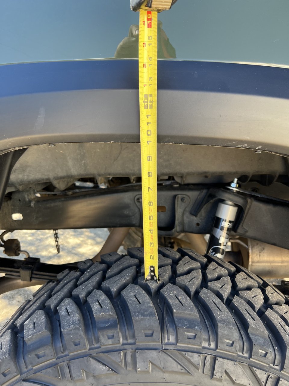

    actually measuring. it’s closer to 1.5” of difference

    Wide angle shots are not helpful when looking for bent stuff. Try to stay at 1x zoom?

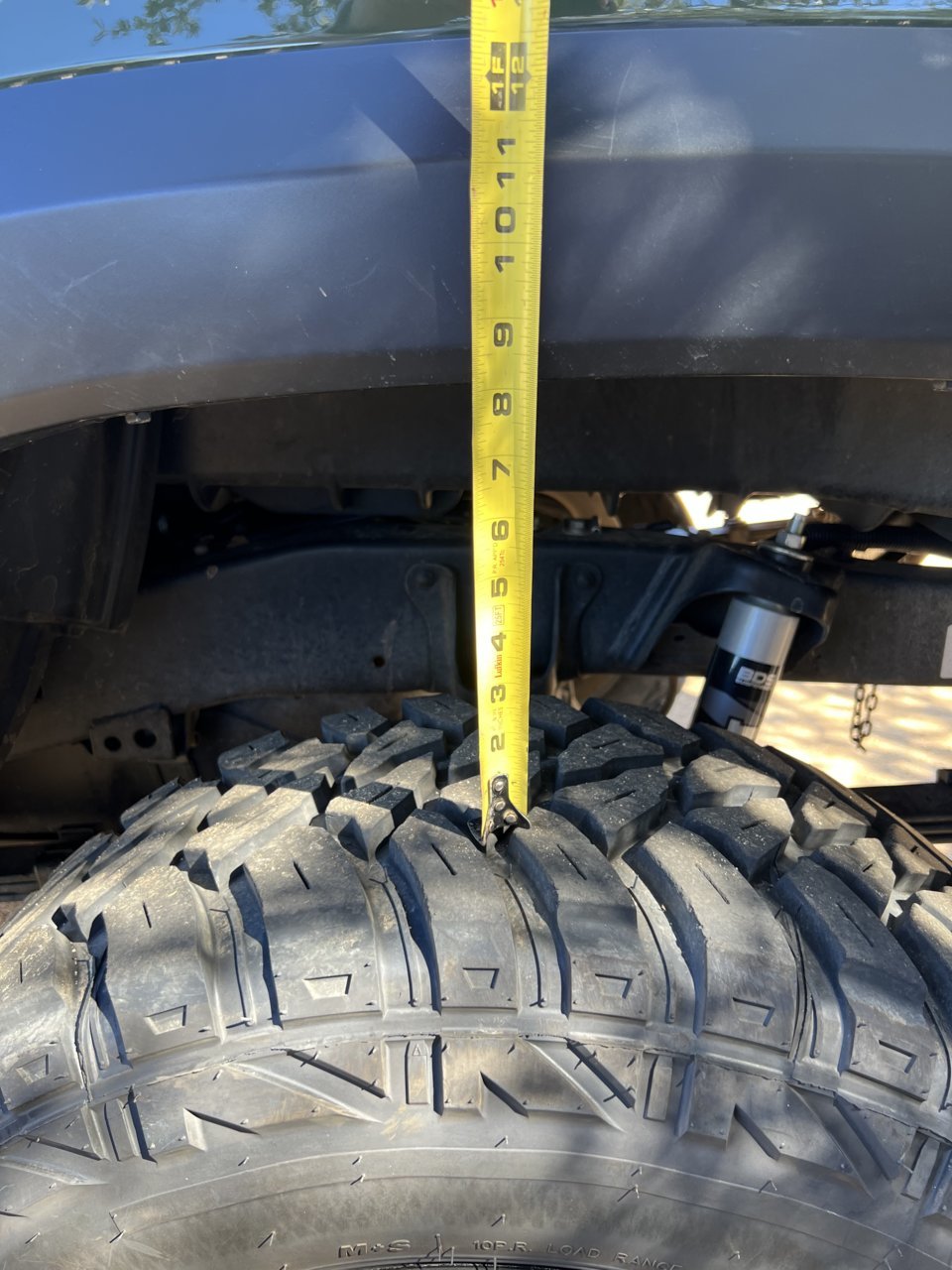

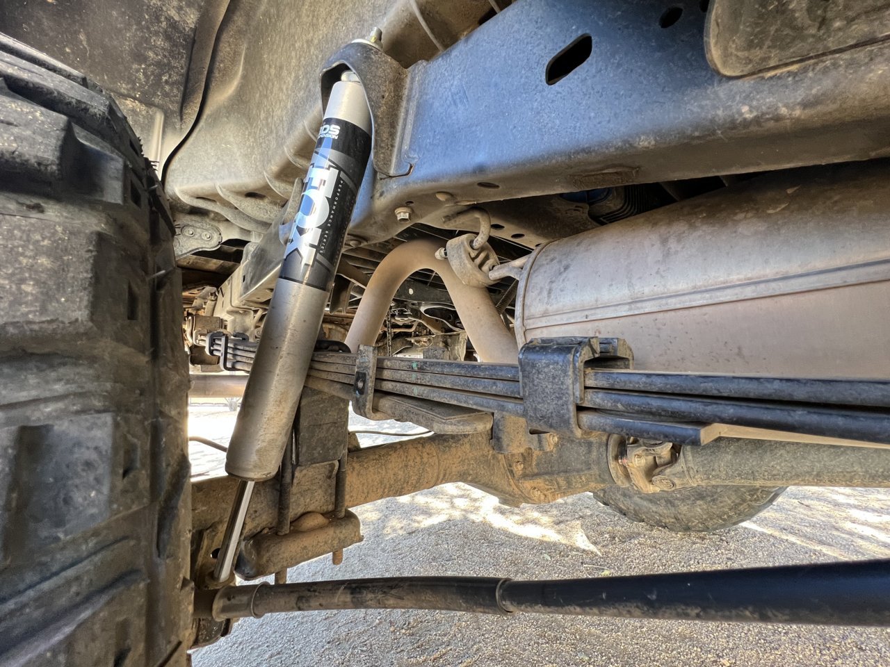

    right side for comparison

    It's hard to tell from your left side shots, but it looks like the left side is W'ed out and the right side still has some arch in it?

    measure from the top of each leaf pack to the frame above it.

    6” BDS Lift, 35” tires

    Lift blocks are known to W the leaf springs. You need new leaf packs to even it out again.

    ya that spring is smushed, is that a stock pack?

    Id get a costum built leaf pack to replace that block and bent springs.

    Hilarious license plate OP

    yes stock leaf springs. so you guys are saying that the springs got compressed too much and now they’re permanently bent? so I will need to upgrade to a new leaf pack to replace the blocks and even out ?
