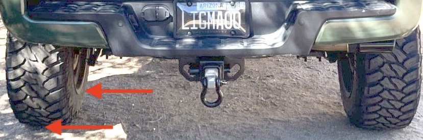

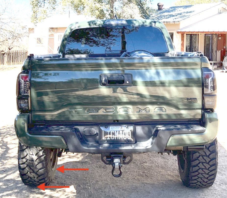

    that is good to know. this is my daily driver so i want to get it back on the road and even asap. this lean/squat is going to put uneven wear on the tires so that’s my rush.

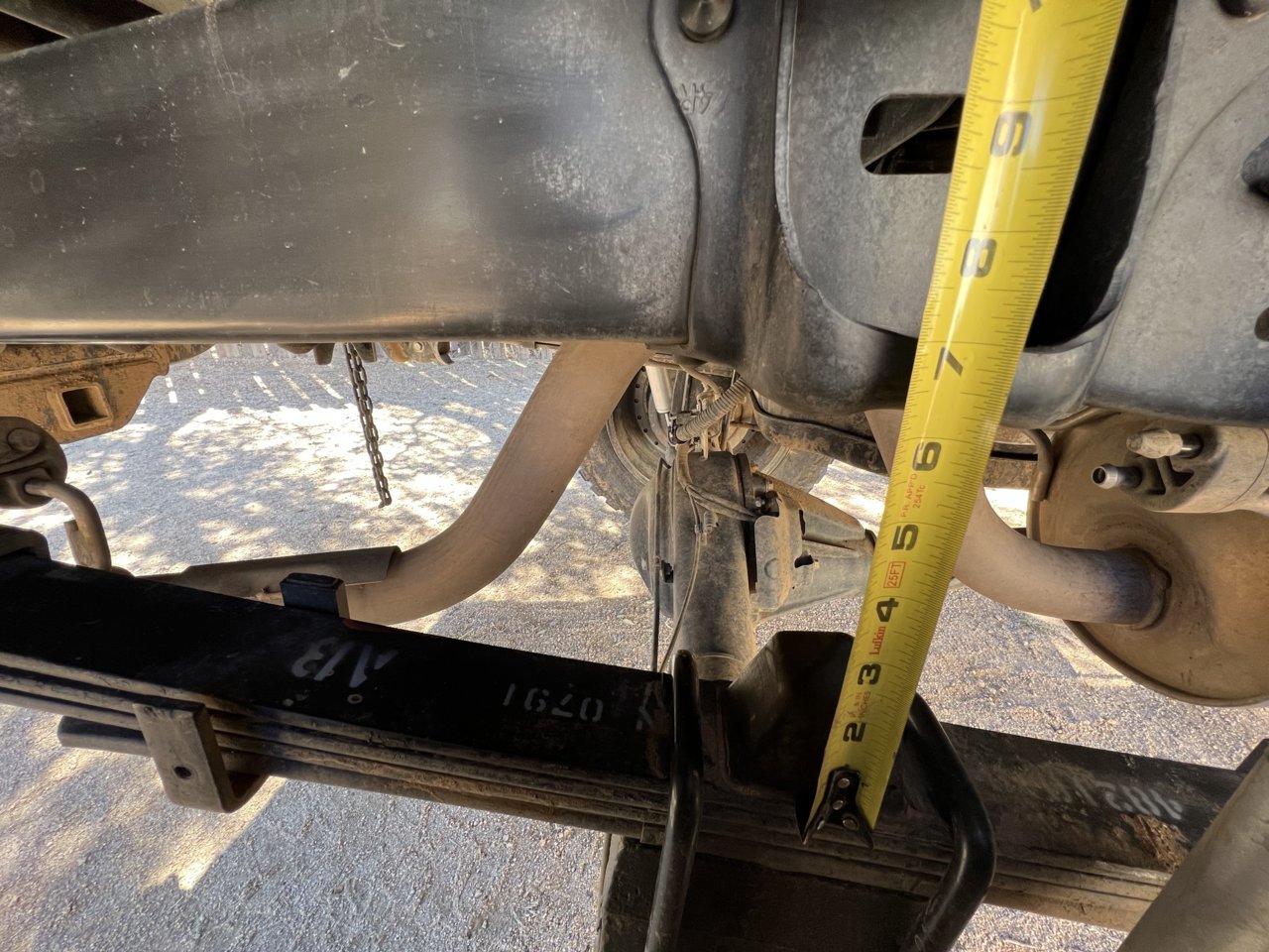

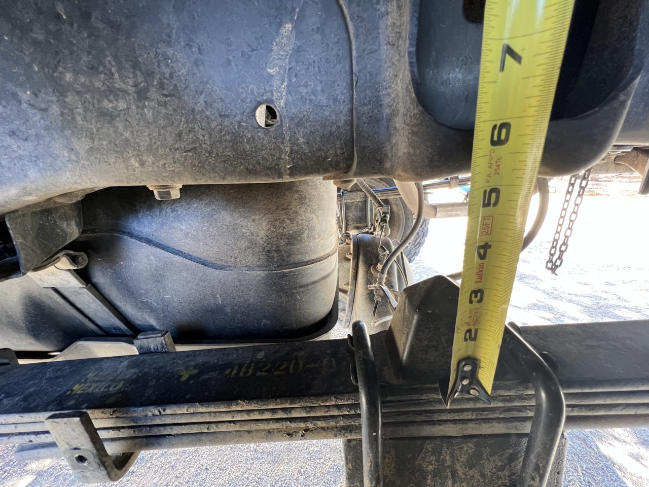

    Love that color. Although CSM is best. ( my color) . You need a new leaf spring. Which makes no sense to replace just the FUBARed one. Try to go with the smallest if not any block if you off road aggressively. Once a leaf spring is compromised like that its basically trash. Even if that spring is re-arched, it will absolutely do the same thing.

    yeah don’t think i would ever try and utilize the bent one again. getting new ones for sure without blocks

    your u-bolts look like they are different angles. maybe they are loose and stretching your suspension out rotated the u-bolt on the axle.

    Good catch. Honestly, probably shouldnt have gone straight to wheeling it. New U bolts are supposed to be retorqued after 500 miles.

    Did you jump the truck?

    Looks like the wheel is skewed out at the bottom and twisted. Like a bent axle shaft. Compared to the other side it looks off....to me at least.

    That leaf pack 'bout to make a U turn. That's pretty straight by the looks of it.

    Possibly both then? Lift that rear end and give her a wiggle.

    I think its just an illusion from the truck bed dipping down so much. If you take a piece of paper or something and cover up everything above the tires it looks the same as the passenger side. I Could be wrong tho

    Actually the skew looks more pronounced. That seems like it was caused by a heavy downward impact like a jump or hitting a hole real hard.
