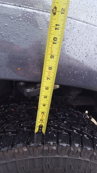

    i installed toytec left, stage 3 now a have a 2.5inch lean to the driver's side. Any info on this would be great.

    listing front.jpg front driverside with full tank

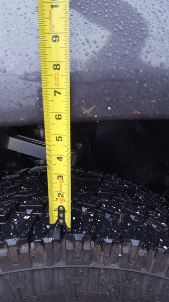

    listingfront2.jpg front passenger side

    How about another picture. lol. I don't think that one helps the guys see any problem.

    Crank your driver side coilover down about 3/8".
    That's normal

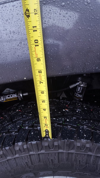

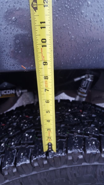

    rear1.jpg driverside rearrear2.jpg passenger side rear

    Pics of the coil / shock assembly is what I think we're after

    See some really nice suspension pieces in there. All tried and true. Show us the front shocks on both sides of the truck.

    ok will do thanks - the shocks have the same amount of thread - I will get pics

    Probably has more to do with the spacers/washers/shims in the top assembly than anything else, unless you've got adjustable coilovers and they're preloaded to different settings....
