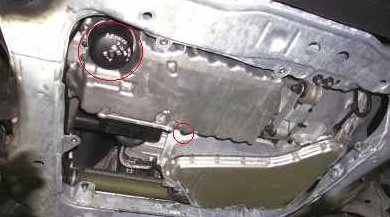

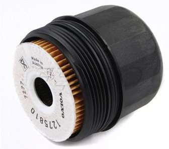

    I'm gonna apologize in advance here, but it really sounds like a lot of folks haven't changed oil on some old cars that had canisters hidden in weird places. Like having to reach in through wheel wells and such.
    On the cartridge side, here's our old Volvo's setup:
    I never heard a bit of complaining or issues other than a couple folks that accidentally jacked on their cast aluminum oil pan with the expected results.

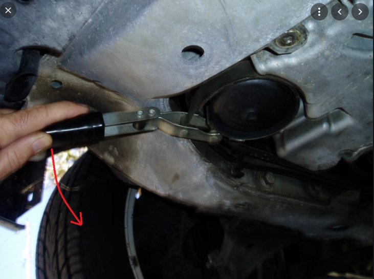

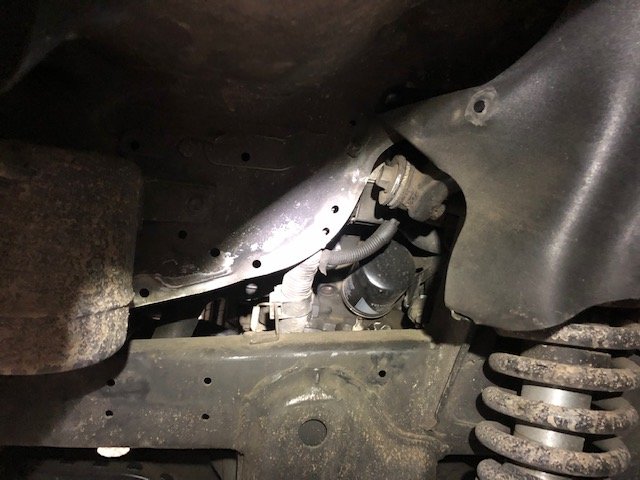

    I'll second the "If you think the filter on the 3rd Gen Taco is hard to get to, try x". I do all my oil changes (except for on my work truck) and can attest that some are more 'interesting' than others. On my T100 I have to park with the front wheels cranked hard to the left so I can reach through the wheel well to get to the filter. I used to have a Corolla where the filter was so hidden I actually had to call a friend who had the same car to ask where the filter was. I also have a MC which is a dry-sump system which uses one filter and two strainers. To date that engine is the most challenging oil change I've done.
