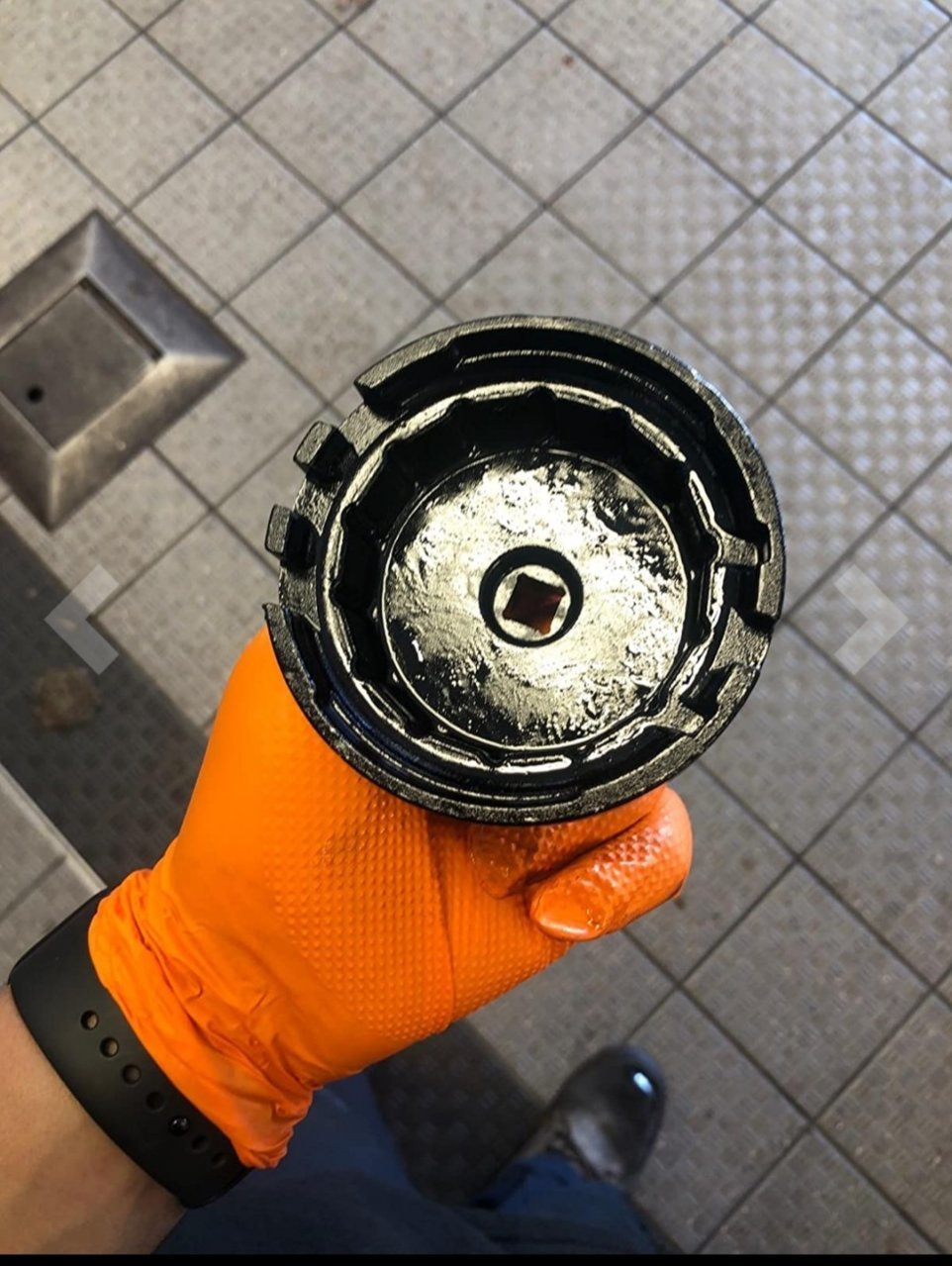

    Does your new aluminum housing have the same 3 pins/teeth on one side? I was looking at Amazon reviews of it and looks like it only has one on each side. The oem plastic housing has 3 on one side and one on the other side. They slide right in on the oil filter wrench oil remove tool, I've attached a photo of the wrench so you can see what I'm talking about. And if it doesn't have the same teeth, would my oil filter wrench still work on that new aluminum housing?

    I had to stopped reading this thread, as it basically boils down to person after person buying a cheap Chinese sh*t w socket (xMotive) that interfaces with the tabs (which it shouldn't) instead of fully engaging the flats like the proper socket in the post above, and then is surprised they cracked their housing. Bad tools make everything harder. You don't need the metal housing, just the right tool.
    Link to socket on Amazon:
    https://www.amazon.com/gp/aw/d/B0015PK3AG?ref=ppx_pop_mob_b_asin_title
    It is noted that it can be hard to remove from the filter housing after use, but rocking it back and forth with wrench will get it to disengage.

    Just to be clear: DO NOT BUY A SOCKET LIKE THE ONE SHOWN IN THIS POST ABOVE!
    Any socket that touches the tabs is a cheap Chinese P.O.S.

    Y'all do notice Motivx changed their design. The most recent one has no "notches." The one ordered from Amazon had the red spindle/no-notches pictured, but what I got was the all black older model that had the notches.
    I'm just figuring this out.
    From the description on Amazon:
    "CARTRIDGE STYLE OIL FILTERS - This is Motivx Tools 2nd generation 64.3mm 14 flute oil filter wrench compatible with all Toyota and Lexus cartridge style oil filter caps from 1.8L - 5.7L Engines. This is a notch-less design which securely grips the fluted portion of the oil filter cap without engaging the tabs like older wrench designs, preventing the tabs from cracking or breaking off avoiding serious oil leaks. "
    I suddenly feel bamboozled.

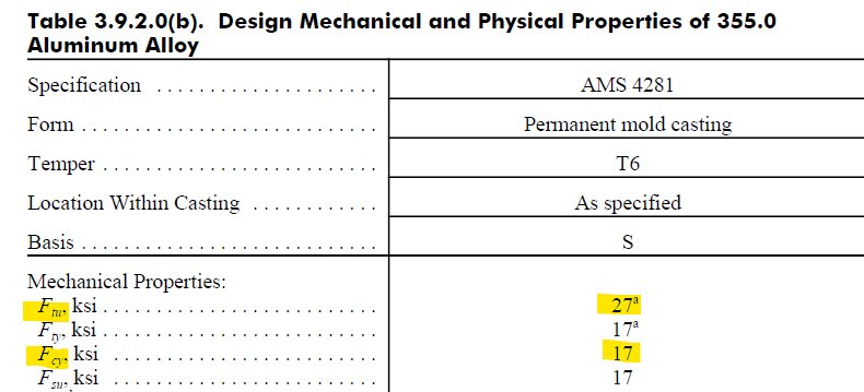

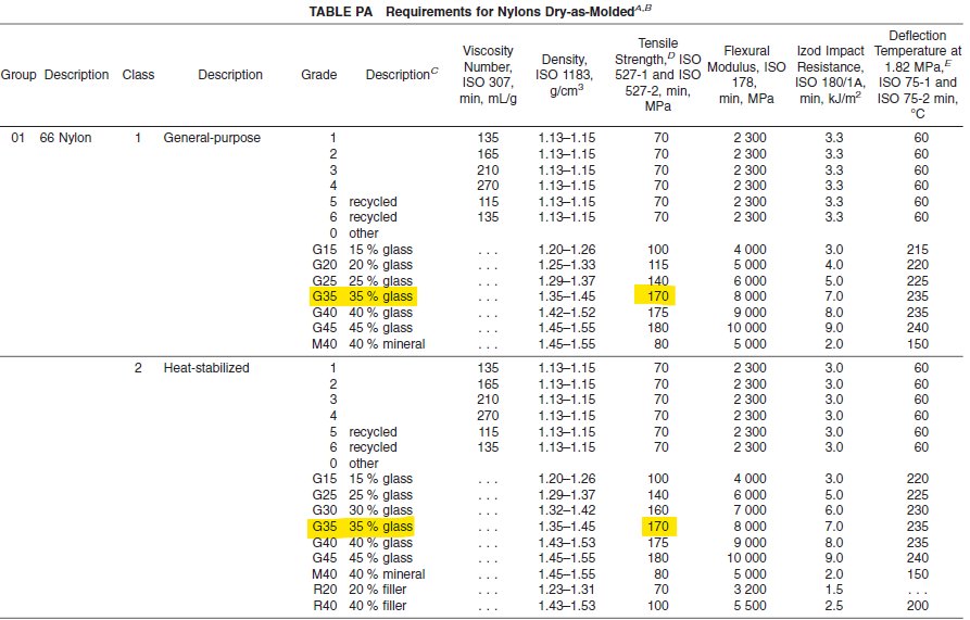

    I'm amazed at the number of people that can't remove the filter housing without destroying it. Often followed by bat shit crazy claims that the weak ass die cast aluminum is "stronger". Aluminum has higher tensile strength, so the ability to resisting stretching forces is increased, but has less resistance to compression.
    So for people that over-tighten the housing then use the wrong tool and sketchy techniques, die cast aluminum is easier to remove. But if you have mastered the complex mechanical concept of lefty loosey righty tighty, the OEM fiber reinforced nylon housing is better. Because fiber reinforced nylon has higher compression strength, the "plastic" housing will survive a bigger direct hit to the housing than the die cast ever will. In either case taking a direct hit to the filter housing wouldn't be good, but the large grain cast structure/thin wall aluminum housing would crack or shatter at a lower threshold than the fiber reinforced polymer housing.

    Got a really good trash can for the back seat that I'm kind of excited about. ;) Tinted the front windows and windshield strip Glovebox and Console dividers MESO Hi/Lo LED Dome and Sylvania map lights Upgraded Sylvania down road halogen headlights Toyota Bed lights Tailgate Power Lock Anytime Backup Camera on front with switch MESO Customs Puddle Lights w/ switch OEM Roof Rack TRD Air Filter K&N Cabin Air filter MESO Customs Gasshole MESO Customs pocket switch plate ARB Awning w/ sides and back Taco Vinyl radio knob Mountain Hatch Tailgate Panel Midland MXT275 with clean set up and Ghost Antenna on roof Tonneau Cover - full fold up Cali-raised Lower bumper light bar Baja Designs ditch lights Icon Add a leaf 2” rear lift Bilstein 5100 OME 2” medium weight coil spring (settled at 1.5” lift all around) Rear diff breather relocation TacoMods ECT gear shift button KTJO4x4 A-Pillar Handle KTJO4x4 B-pillar handles RAV4 spot mirror Exhaust Re-route The last Mobtown Hidden Hitch Rear Bumper Greenlane Off road Aluminum low profile front bumper RCI Full skid plates + Cat guards Fuel Tank Skid plate Heated seats Battery Upgrade to larger AGM Soundskins sound dampening kit Randy Ellis Rock Sliders Remote Start and GPS Goodyear Wrangler UltraTerrain AT 31" tires Fumoto Valve oil pan upgrade TRD Radiator Cap Rough Country Speedometer Calibrator Oversized Cupholders Total lift: 1.5” body lift .5” ground lift On the list: Re-Gear? Speaker upgrade? Greenlane Bumper Wings?
    Huh...fascinating. I think it's potentially cheap lube places that are overtightening stuff. Before I started doing my own, I'd see that lube joints would try to max tighten the filter/filter housing an drain plugs until they were seized. In previous trucks I've had to crush filters to get them out after taking it somewhere (many moons ago).
  20. Oct 15, 2021 at 10:27 AM
    #220
    tonered
    tonered bartheloni
    Sep 25, 2017
    #231055
    31,281
    tony
    Lynnwood, WA
    Now you piqued my interest. Hahaha!

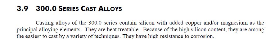

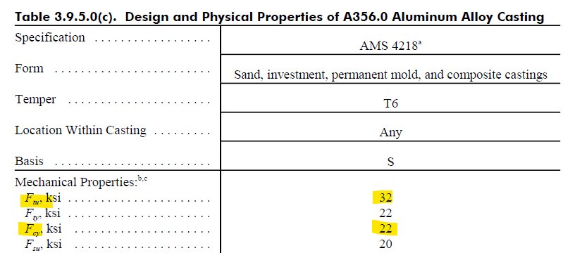

    I have no idea what that casting alloy is, but going from this description and that it is molded:
    Some other 300 series alloys are stronger:
    Nylon 6/6:
    170MPa is 24.7ksi -- comparable to cast AL
    8,000MPa is 1.1e10^3ksi - much less brittle than cast AL
    Sorry. I do not have compressive data.
