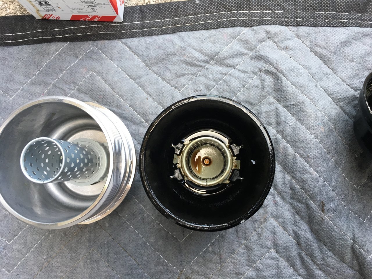

    loveinyourmouth
    loveinyourmouth [OP] Well-Known Member
    Aug 27, 2016
    #195671
    105
    2016 Tacoma DCSB SR5 4x4 - Red
    Bone stock

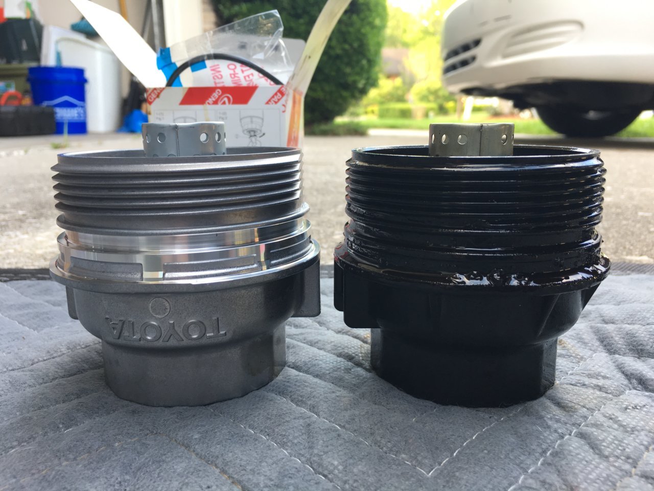

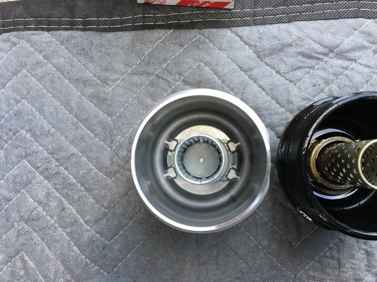

    Here’s the new oil filter housing (left) next to the old housing (right). Everything looks identical inside and out to me. Fit was perfect and everything went back together like a breeze. No leaking. Will keep an eye out for any issues and update accordingly.
    Also, I’ll have to get that oil filter drain tool for cleaner oil changes in the future. Thanks everyone!
