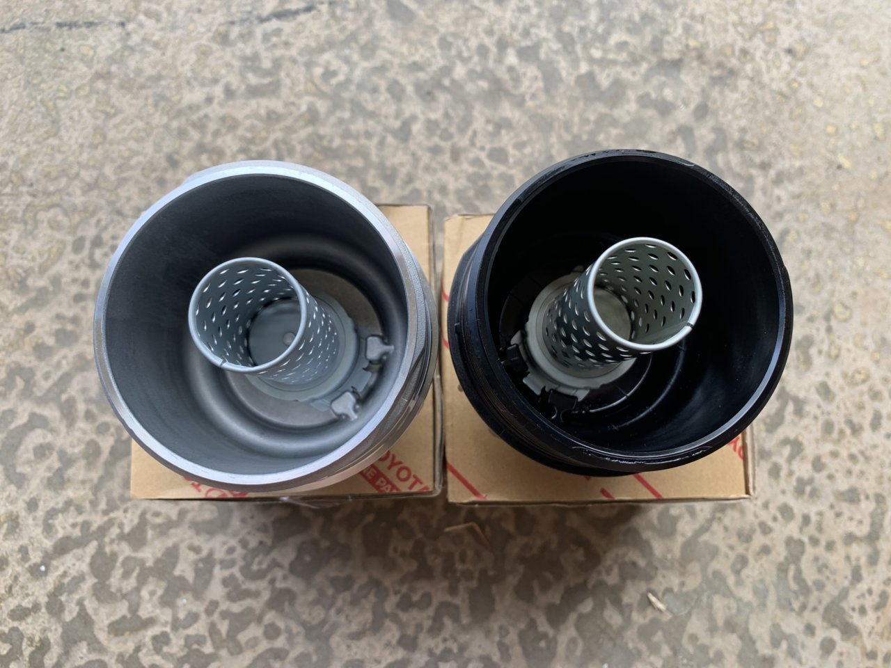

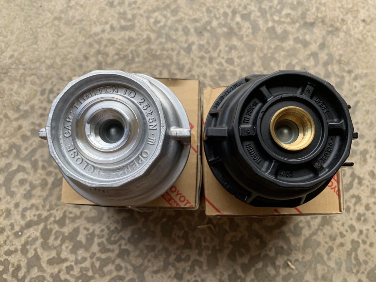

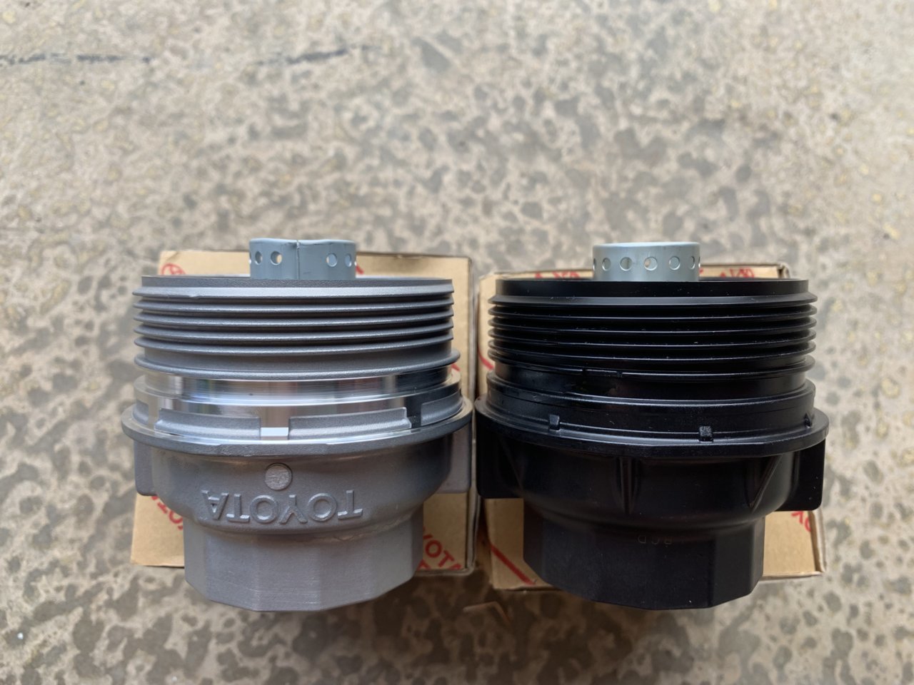

    Here is a side by side comparison of the OEM plastic and aluminum ones.
    6DF22456-7FA5-4E52-8D27-817D8458865C.jpg 835192FF-63F6-4688-80E8-E37C318DA56B.jpg CF095479-59D1-4FCD-9E05-B0FC755A89CA.jpg
