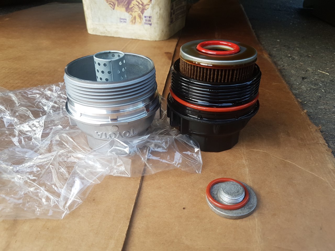

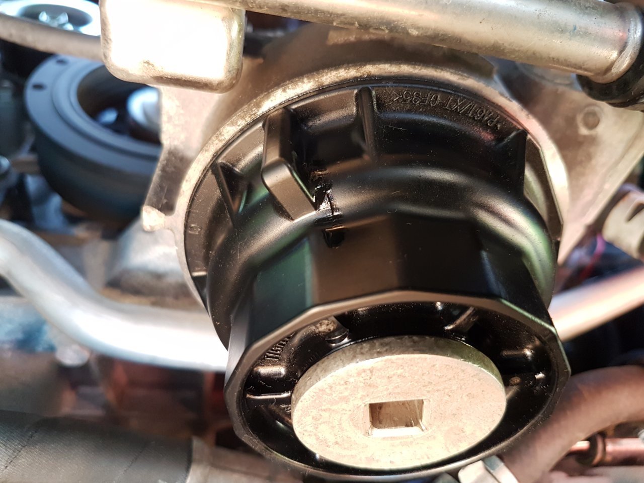

    Hey, guys. I'm another victim of the 800 lb gorillas working at my local dealership. I let ToyotaCare perform the first oil change six months ago and recently did the second one on my own. Had to use the impact wrench to get the damn housing off. Thought everything went fine until I dropped my skid plate last night. Oil everywhere due to hairline crack.
    Why do they tighten these so much?? This much torque is impossible through thermocycling, that's just bad service.
    So I filed a complaint with Toyota headquarters to help them get the message across and ordered my aluminum housing.

    Swapped my housing for the aluminium one today. Dropping the filter cap you only lose about 0.3 quarts of oil so there's no need to do the full 6 quart change. What a huge improvement!! The aluminium housing threads feel smooth and don't bind up like the plastic one.
    Thanks for the input, everyone. Happy trucking.

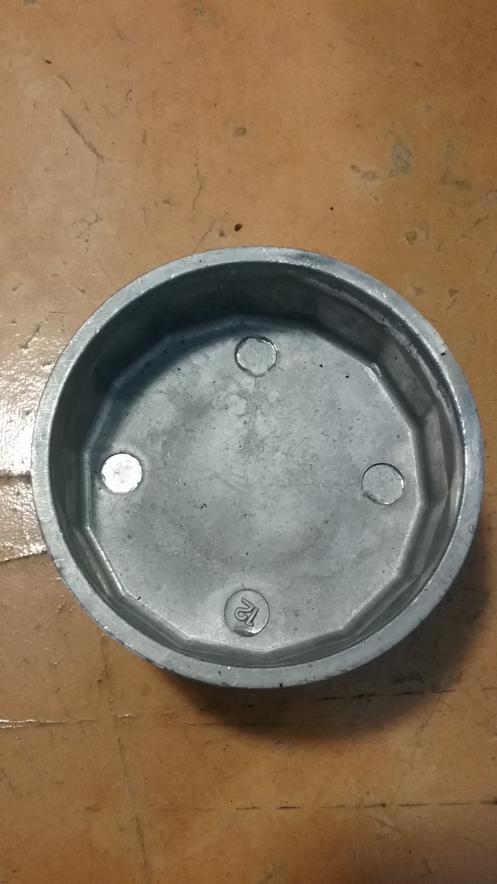

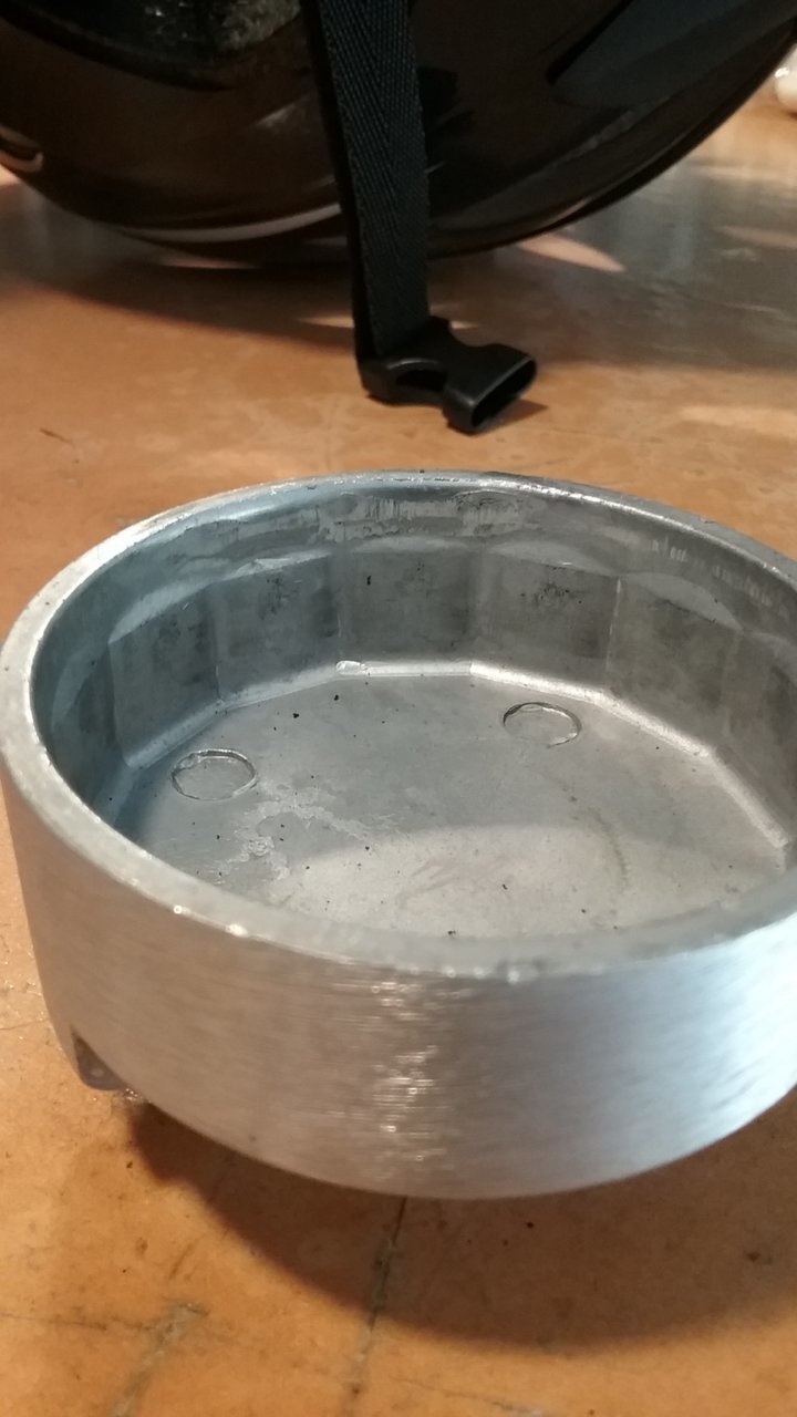

  14. Jul 31, 2019 at 7:48 AM
    #114
    Early Man
    Early Man Well-Known Member
    Apr 15, 2019
    #290192
    256
    Sand 2016 Sr 5
    Like to see the other side of this special socket, IF it's not too much trouble. Oddly there is an add for the style I bought that fits a 2016 V6, below this thread. https://www.amazon.com/dp/B073XF45NF
  15. Jul 31, 2019 at 8:05 AM
    #115
    Plain Jane Taco
    Plain Jane Taco ALL human beings deserve equal treatment
    Apr 19, 2009
    #16179
    39,031
    USA
    No problem. But it will have to be later, as I'm at work for now.
    I can't speak for other products. But I can tell you that the TOY640 fits ALL Toyota, Scion and Lexus vehicles that use the cartridge setup. All the filter housings are the same size and dimensions on the end...regardless of whether they're plastic or aluminum.
    Early Man[QUOTED] and shakerhood like this.

  20. Jul 31, 2019 at 12:54 PM
    #120
    Plain Jane Taco
    Apr 19, 2009
    #16179
    39,031
    USA
    Here ya go.
    I bought this many years ago. I like it's thick, sturdy construction and the fact that it has a 24 mm provision on the top. No weak 3/8" square hole like some cap wrenches. So if some professional arm wrestler happened to change the oil before me (which happens on some of my friends and neighbors vehicles) I can carefully loosen it with a breaker bar with nice even torque.
    Never damaged a housing....including the plastic ones.
