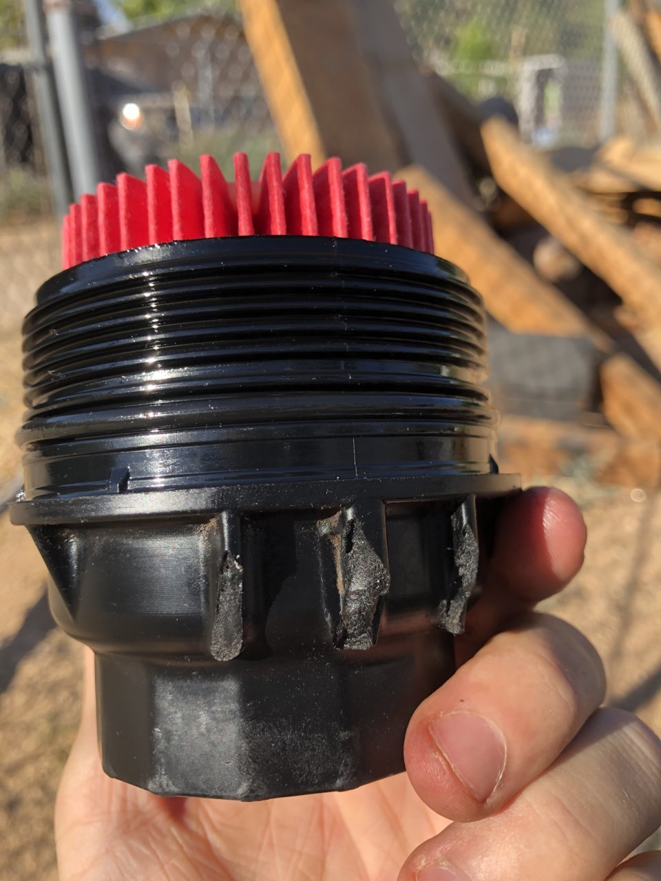

    Yeahhhh just snapped the plastic tabs off my filter housing using a breaker bar cause it was put on way too fckn tight by the dealership...

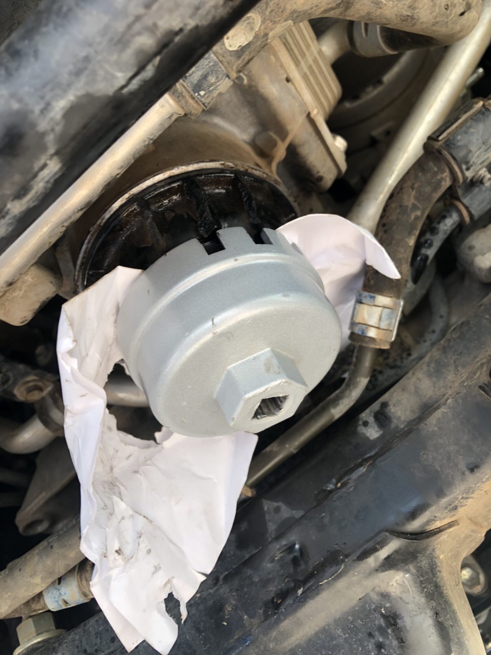

    Tried a bunch of different ways to break it free. Tapped the filter housing with a large punch (not too hard), penetrating oil (didn’t want to but I was desperate), 2 different oil filter adapters, and paper for added friction which actually helped a lot. Tried a breaker bar but that’s what broke the plastic clips on the side.
    Ended up using a torque wrench. Mostly for leverage but not as flexible as a breaker bar and also to see how over torqued it was....
    The torque wrench maxed out at 80 ft lbs... and I still had to wrench harder before it broke free. :censored::censored::censored:
    :duh:
    It doesn’t seem that the filter housing cracked, just the tabs broke. So I’ll hopefully get by with it until the metal one linked in this thread arrives.
