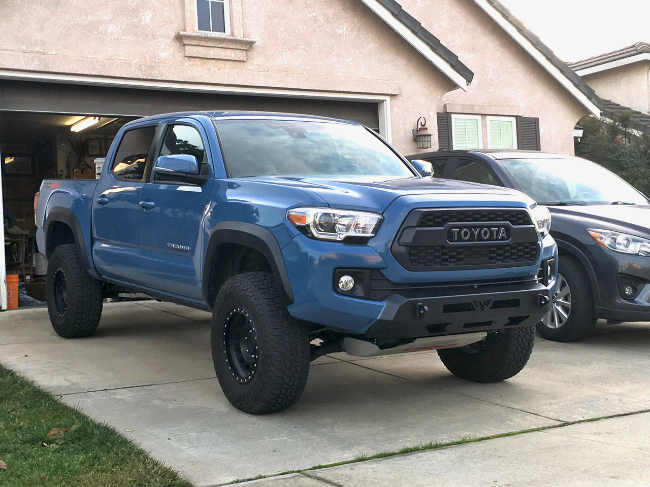

    SOS Concepts has a streamline bumper. I think that they have one in stock and ready for shipping.

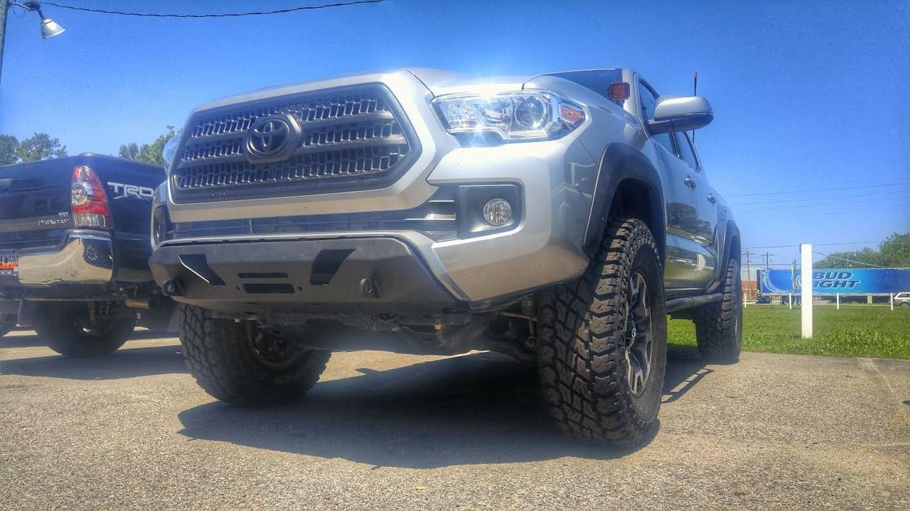

    Something like such

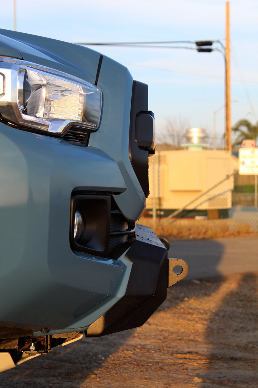

    Victory 4x4 Blitz...

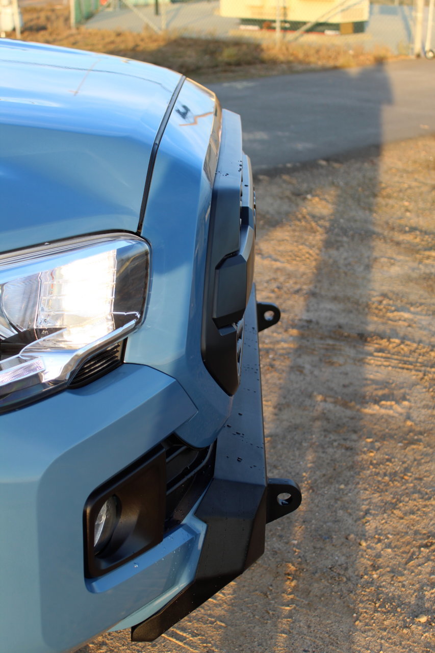

    Side angle of the bumper?

    Is there enough space to take into account the flex of the bumper?

    Not sure by what you mean by the "flex of the bumper"... The bumper is bolted directly to the frame using 4 heavy duty bolts that are bolted to 4 studs on each side of the frame. If that bumper flexes or moves, the frame is going to flex and bend. In other words, it ain't moving and if it does, you got other, bigger, issues... in fact, one of the down sides to *all* these bumpers is that the frame is going to bend well before these bumpers give.

    You body is mounted on rubber. Your body flexes and moves slightly independently from frame, is there enough room to account for the body to move, independently from frame and not scrape paint? Lemme know if my explanation needs further refinement.

    Got it. The whole plastic front end moves... Yes, there is space between the metal bumper and the plastic --probably about 3/8" - 1/4". As to paint rubbing underneath --Victory 4x4 recommends putting some clear tape underneath the edges of potential contact points if you plan to remove the bumper and return to stock --"just in case".

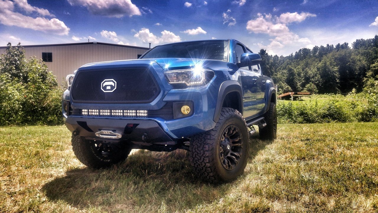

    What grill is that?
