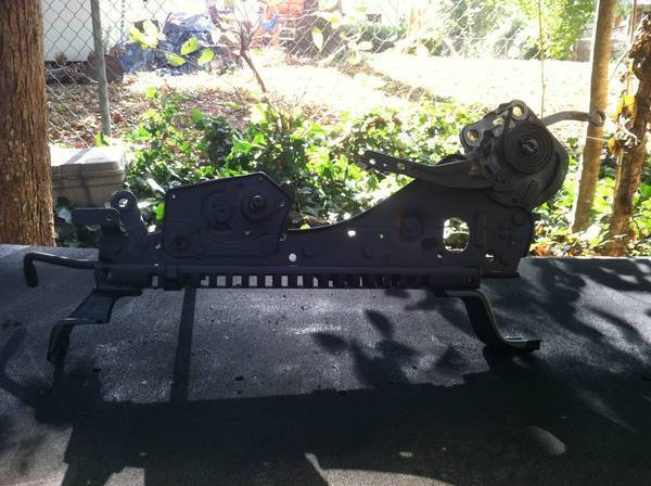

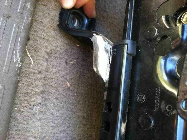

    Greetings my fellow Toyota fanatics. I decided to ditch my smelly tan cloth seats for some leather 4 runner seats I found on craigs list. I was under the impression they would "bolt right up". Well turns out its a little more complicated than that. So here is how I have spent the past two afternoons and the resulting finished functional product. I found these seats for $120 for both front seats tan leather non-power with lumbar support and height adjustable drivers seat.

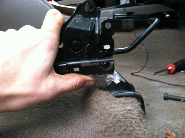

    So I stared with the passenger side as and quickly noticed a big difference in the front right side mount. Everything else matched up. The 4runner seats were at a 45degree slope and the Tacoma seats mounted at 90degress.
    At first I thought about just trying to bend them in to submission but truthfully any thing worth doing is worth doing correctly. So first thing I did was pull both mount/rail systems off the right side and hacked the front mounts off. As few test fits, welds and some grinding wheel action later the Tacoma front right mounts were on the 4 runner rails.
    I put them back on the seats and attempted to mount them. I shit my pants when I realized that the back right mount was off about 3/4' of where is should be. I guess my mock fittings were a little off. So rather than redo all that I had done I just decided to relocate the rear mount also Some more intimate time with the trusty grinding wheel and some flat black spray paint and we are good to go.[​IMG]

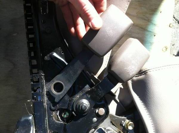

    Next I switched out the Female pieces of the seat belts as they did not lock together in my trial run.

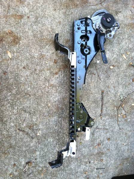

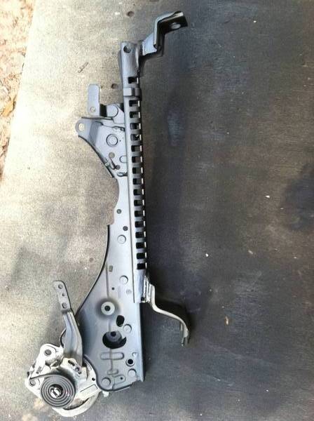

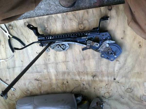

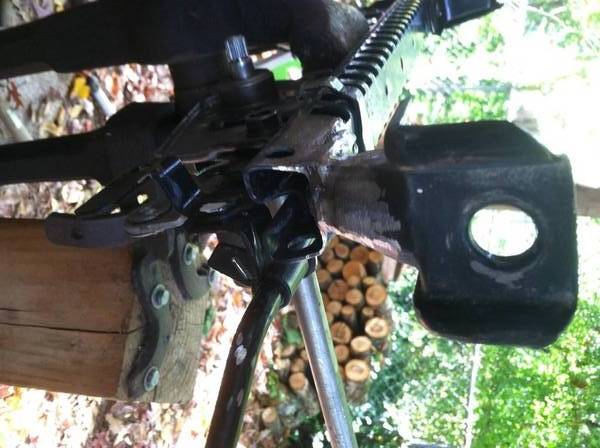

    Now on day two it was time for the drivers side. The drivers seat was 20x more difficult of disassemble/reassemble as the mechanism that allowed you to raise and lower the seat height consist of a bunch of levers gear and drive shaft that I was not familiar with. Also I had to take extra special care when putting it in the vice as no to bend any of the parts out of whack.[​IMG]

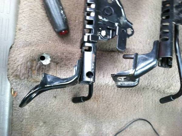

    Same deal on the front mounts and flat black paint.

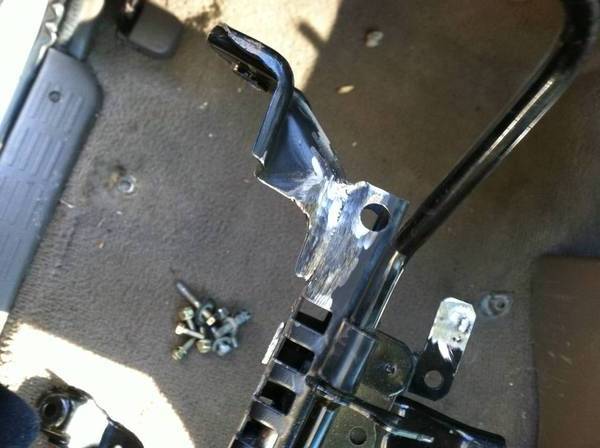

    [​IMG][​IMG]

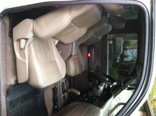

    I was a little more meticulous/forcefully in my final installation of the drivers seat and did not have to relocated the back bracket. Any ways here is out it tuned out. They are a hell of a lot nicer than the cloth seats and fully functional. Enjoy my friends I know I did.:D
