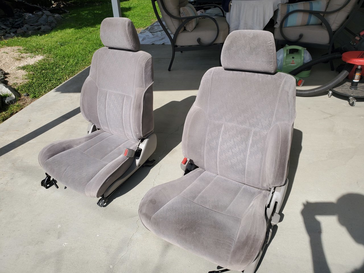

    I got hold of some Tacoma bucket seats finally to figure this out for myself today with inspection of the actual parts in hand and in my truck.
    It looks like there are bumps stops on the rails to stop the seat from sliding too far forward, as well as the rivets holding in the feet themselves that must all be ground off in order to get the rails off due to a bearing carrier inside the rail. This being the case I can see why the op decided to just cut the feet off and swap them over, save a step and the rails do appear identical otherwise. I did not grind and try since my Tacoma buckets are an upgrade believe it or not above the stock bench (not 60/40), but this is how it looks and now this process makes all the sense to me!
    Note of Caution: When I removed my 4Runner seats that I had banged into place, I found I actually bent the hump in the body where the seats mount on the front outside and needed to straighten them back out a bit in order to bolt the Tacoma buckets back in. Be careful doing this job guys, it would have sucked big time if I ruined the body where the seats mount in the process. I dont think this occurred while I was beating as I was watching very closely and it looked good before bolting in, so I think I used too much torque snugging the bolts into place which started crushing the floor pan hump as it pulled the cage nut into an angle it wasn't meant for.
    From all my experience I would definitely recommend the method in this write up, swap your feet so they will bolt up. Forget beating parts into submission and hoping they sit level and that you dont ruin your cab floor in the process, and dont waste your time trying to swap rails because its only more grinding parts unnecessarily. Only reasons I didnt do this in the first place is I didnt have the bucket seats to swap the feet over. With the seat in hand I can say this is the way to do it now.
    I have not abandoned the 4Runner seat project, since the 4Runner seats are definitely more comfy but I did get bucket seats and they are better than what I had and I can drive the truck again now. I want to get the trim on the 4Runner seat painted to match my interior and then I am thinking of getting some fabric that matches the seats to just insert into the door panel center to give it sort of the 4Runner gray interior two tone effect as below.
    Guess one more side note, 4runner seats in tan match the Tacoma interiors way better than the grays.

    Glad you got it in there but..
    Careful bending metal back and forth, you may have stressed your seat mounting foot to the point of reducing your own personal safety in an accident. Is that a stress crack I already see in that front outside foot (16:43)?
    Also it looks like you may have mashed up your floor pan beating the feet into submission (16:50), and it may prove difficult to ever get a Tacoma seat in your Tacoma again.. as I mentioned in my cautionary tale above. Hope this is only illusion..
    Here is my updated plan with no welding, grinding, and even no mangling of seat parts or factory Tacoma floor pans required.. and even factory fabrics to match my interior, S-Runner seats!
