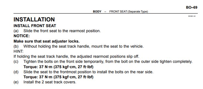

    what is the factory torque spec for the front bucket driver seat, mine is becoming a loosey goosey again (after maybe 4 or 5 months) and needs a bit of proper tightening
    thanks,j

    In addition to just torquing to specs, if you're seats keep coming loose I would add some thread lock when snugging them down as well.

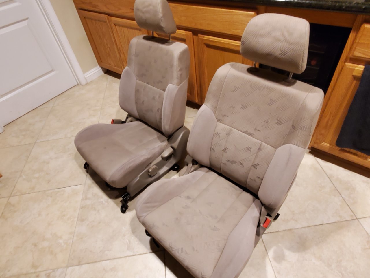

    I have these quite nice 02 4Runner sport seats already modified for the Tacoma for $300 for the pair if you're interested:20200120_015219.jpg
    Super comfy and in great shape, and everything works on these beauties including height adjustment and lumbar for the driver seat!
    Driver seat in my regular cab, I ended up finding actual Tacoma Sport buckets in matching gray so I have these left over and selling for what I paid for them.

    Do these 4runner seats fold forward at all for access to the area behind the front seats?
  10. Nov 20, 2020 at 4:09 PM
    #50
    2Runner
    2Runner Well-Known Member
    Jan 20, 2020
    #316661
    1,042
    Scott
    So Cal
    2002 Regular Cab 2.4L MT 2WD
    4Runner seats fold and slide forward manually and separately, but they do not have the quick fold and slide in one mechanism on the passenger seat as the extra cabs do.
    The 4runner seats in the pics have already made their way to a new home, and they did end up in an extra cab.
