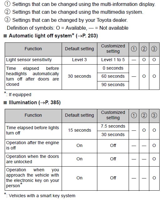

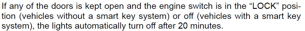

    Incorrect, or at least on certain trims. My 19 OR will leave the headlights on even once I leave and lock truck. I think I read in the manual that there's a timer and they shut off after x minutes (maybe 15 min? 30?). I don't recall if that timer can be adjusted. I'm used to auto headlights so still leave them, exit truck, walk away, then realize they still on, and have to go back in and turn off. One day I'll learn.

    Settings are in the head unit I believe

    I think that's right...buried somewhere and not accessible when truck is moving most likely :thumbsup:

    I have a 2017 base truck and the headlights will go off on their own after about 30 seconds or so.

    Haha I was way off in my Estimated time. Thanks for showing that.

    I keep mine on the “auto” mode. During the day, the DRLs are on and when dark, the lights come on. There is a setting in the head unit to turn on or off the DRLs while in the “auto” mode. You can also set the sensitivity of the sensor that decides if it’s dark enough for headlights.
