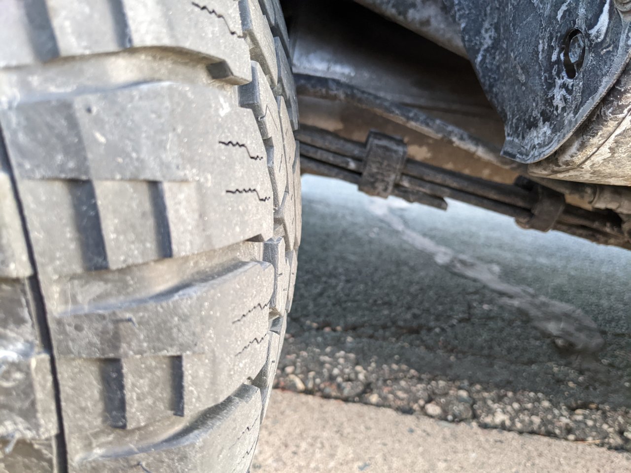

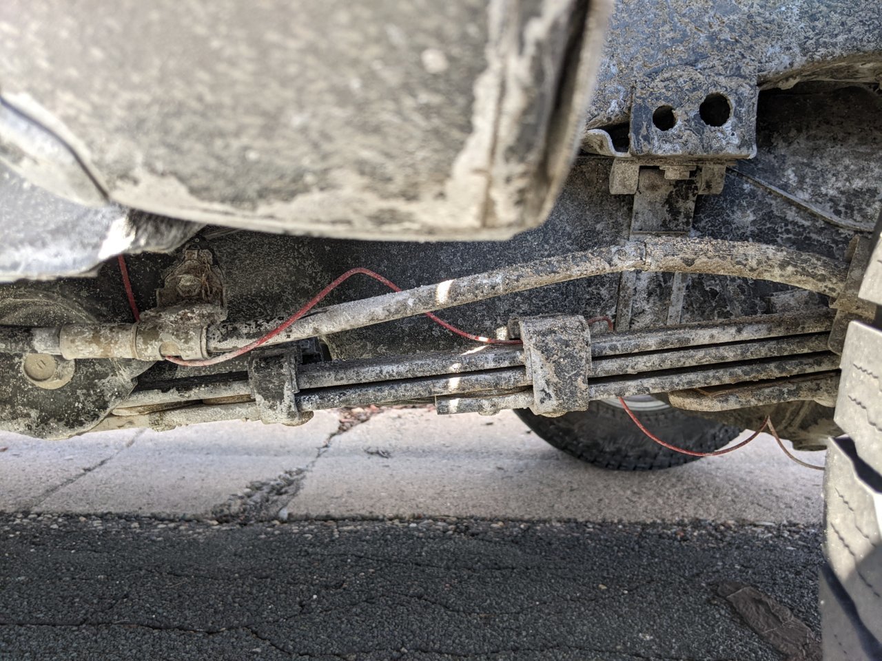

    I have 18k on my 21SR. This is what I'm seeing on the leaf springs forward of the wheels. Am I looking at needing to replace them?
    Edit: thinking, yup blown. Now what do I do?
    Edit 2: It's riding at 21-21.5 inches center hub to fender when unloaded. Could be that the springs are just funky looking and have settled from stock 22in since I got it?
    Top pic is passenger bottom pic is driver side

    :eek: yes, you need a new leaf springs.
    What are putting in the bed or trails are you hitting that made that happen. They are not supposed to arch that way.

    Guess I am not seeing the problem. Is your truck sitting at a weird angle, or really low? Tacoma springs are never heavily arched from the factory (helps with a smoother ride). Under normal circumstances they are pretty close to flat. That is just how they are designed. Folks seem to think that if you don't have a huge arch in there your springs are toast. Take some hub to fender measurements and compare it against other Tacomas

    I don’t see any cracks. Your leaf pack is fine. The stock leaves normally go inverted. If you *want* to upgrade the leaf springs, maybe because your rear end is sagging or you wanna carry static loads in the bed, get a replacement leaf pack like the Icon RXT (great product, seems to be some misguided hate in this thread).
    But the stock leaves having that shape is normal. Use this info to make an informed decision.

    Wire is from half complete bed light job. Noticed the leaf springs while doing it and took the photos.
