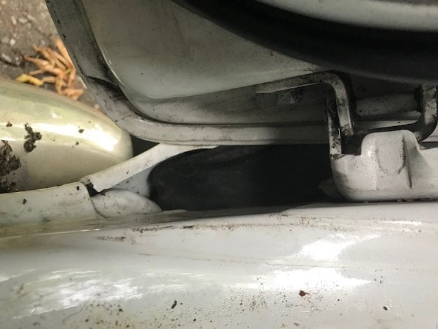

    For anyone with a 2nd gen you should pull back the rubber flap shown in the picture after every fall. Not sure how they get there but the space behind that flap is full of leaves every time.
    i have pulled more than two whole hand fulls every time i checked.

    Probably coming from where fender meets cowl

    All the leaves I pulled out where bone dry so i wasn't worried about rust or mold/rotting leaves.

    I think we are talking about a different thing, i was talking about the rubber cover on the inside and in front of the front door.. i think you are talking about the fender liner inside the wheel well...

    I remember finding that area on my taco and it was packed with crap on both sides. My tundra has the same areas. The leaves and crap come from up near the windshield cowl, some guys have made wire mesh patches to kind of block the area where the crap enters. Not sure how effective that is. I just make sure I pull that flap back a couple times per year and clear that junk out and even vacuum in there. I also spray fluid film in there to protect from rust. Everyone should check these areas for junk, definitely a good spot for rust and corrosion to start. I park in a garage now 99% of the time so it's rare they get too filled up. If you parkOutdoors, especially on trees , I would clean the area out every month or 2. Good awareness post ! Thank you
