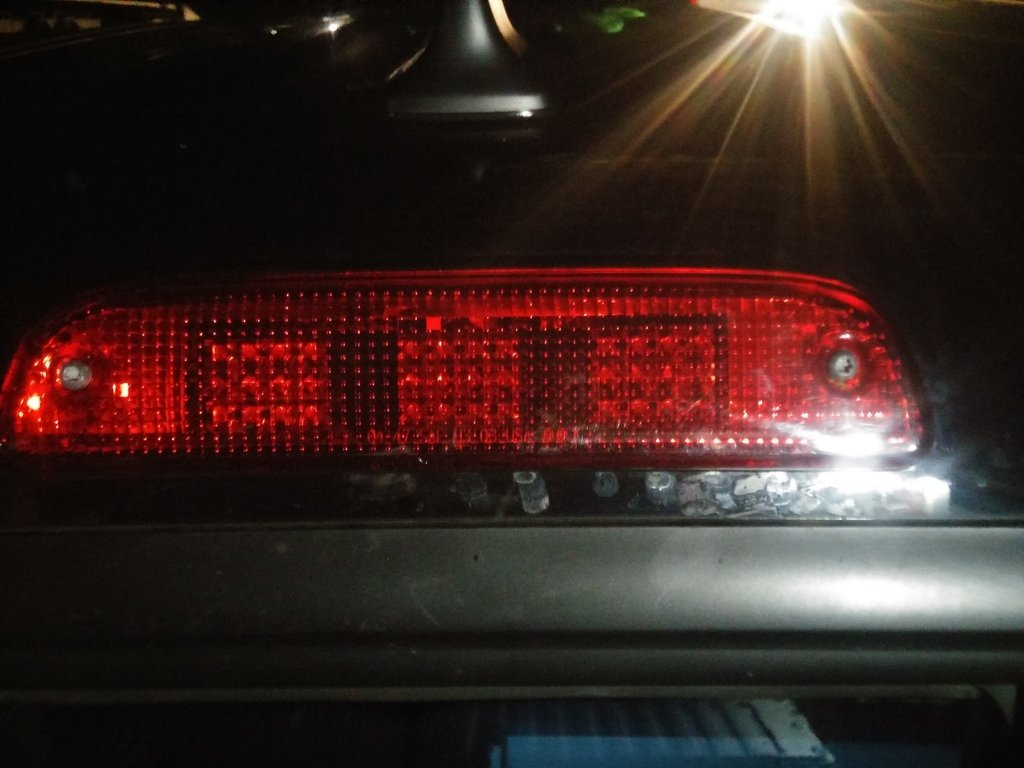

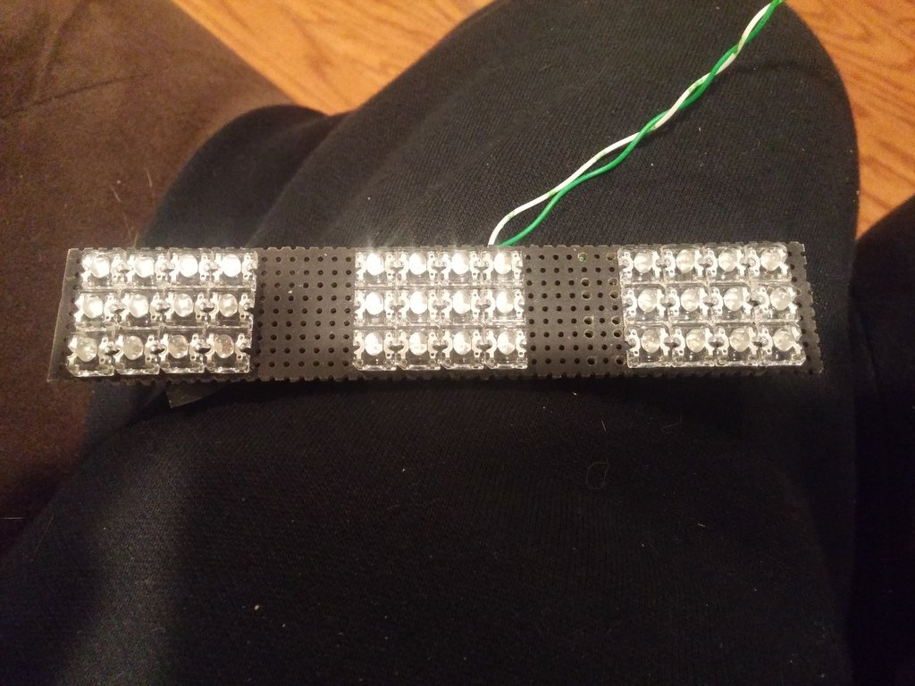

    so made 3rd brake light using Philips Lumileds. 36 of them. those led bulbs that claim they are bright is BS. this things are bright
    took me couple hours to assemble and solder everything

    What are the dimensions of your PCB?

    1x5.25"

    Is there enough room for the board to be 6.7" long?

    no because bulbs sit recessed in housing and parts that not recessed is right up against the red lens so it would not fit

    I compared it to brightness as stock led tails. I made another board yesterday, have to put it through text to make sure it can be on for 10 min without burning up couse leds do get hot

    Yes i do. 44ohm (2 22ohm in series 1/2w each resistor. Im sure its overkill but just to be safe. I would put PWM on it too but there is no space for that

    Ok. I just didn't see any on the front of the board. You should probably limit the current seen by each LED to 20 mA or less depending on what they are rated for.

    Philips lumileds are rated for 70ma, not like cheap ebay that are rated for 20
