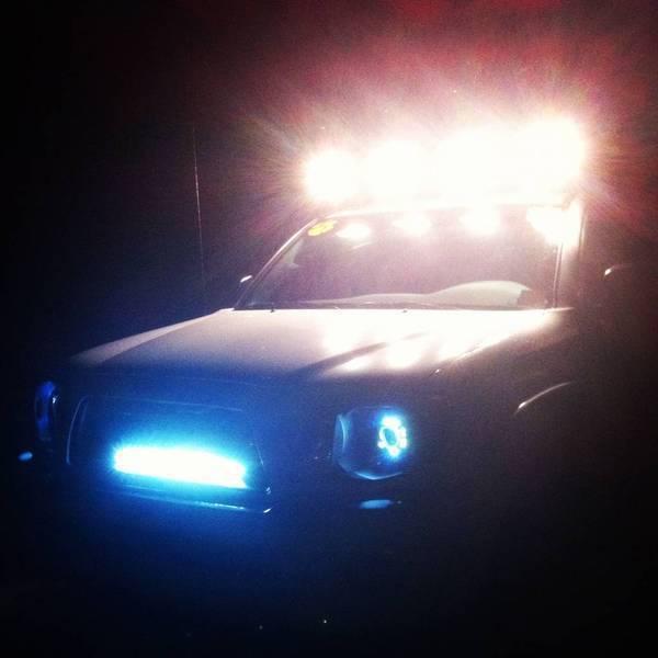

    I looked through the forum and couldn't find a thread already started specifically for this so I figured I'd post this incase anyone else wanted to do the same. I took a RI 20" SR LED Bar and put it behind my Satoshi grill. I used a BAMF behind the grill light mount with the LED bar adaptor. I like the mount but I couldn't get mine to have all four screws bolted in. The best I could get was three screws in due to the way the LED adaptor I received was made. Don't take that as I am unsatisfied with BAMF's product I'm just saying how it is. I love the BAMF light mount but wish I could have the fourth screw in. I It was actually a pain in the ass to do but I made it work with a little Dremel work and determination. I had to Dremel out part of the bracket that is in from of the radiator because the LED was to deep to fit otherwise. Here are the pics of how I got it to fit in the very tight space. Let me know if you want any more pics and I'll get them posted.
    Finished product at night with my roof lights, halos, and LED Bar on from the side:
