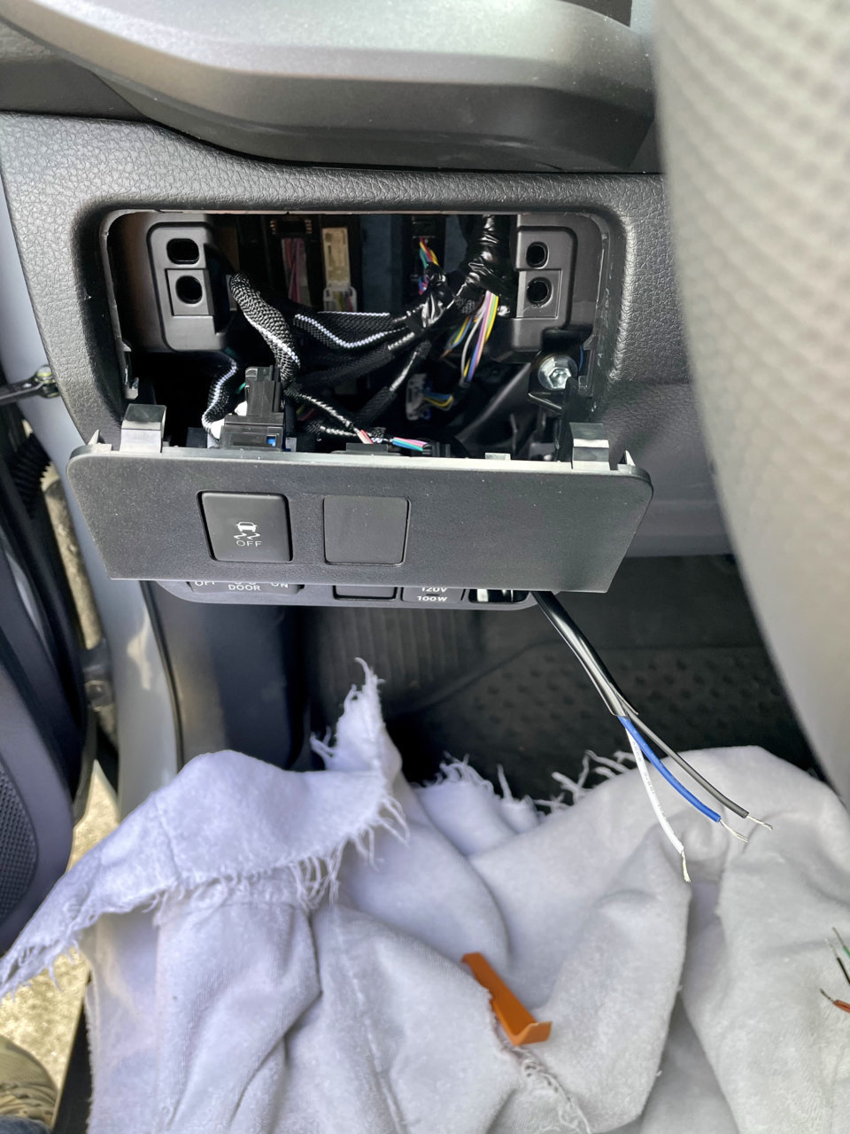

    Tossed the janky adhesive back switch that came with it and ran wiring to the left side panel (through the big firewall pass-through the hood release cable goes through) to an OEM style switch.

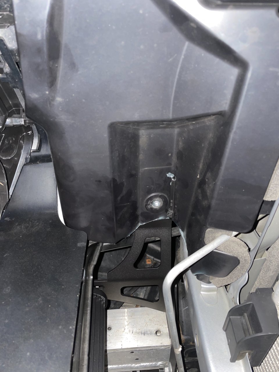

    Any chance you have a pic of that notch? I took mine out but what to put them back in "just in case".

    Best picture I could get.

    Thx - I'm going to put mine back in too.
