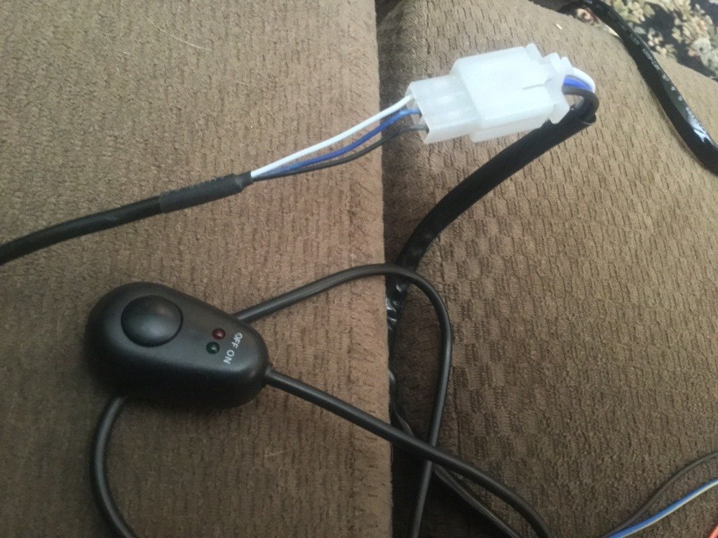

    And I'm thoroughly confused and I haven't even started. I have my AVEC light bar that came with the harness. The switch on the harness has three wires and looks like this:
    The white wire is going to pin 87 on the relay.
    The blue wire is going to pin 85 on the relay.
    The black wire is going to pin 86 on the relay.

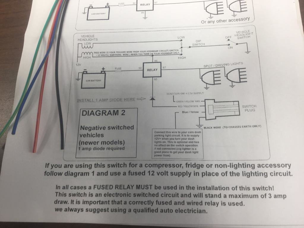

    I want to use this switch in the diagram below and have the light bar come on with the high beams when the switch is on, and remain off when I hit the high beams if the switch is off.
    Here is the wiring diagram for the switch:
    0544CB00-459D-466C-83DA-614D2C14B246_zps_d5852bb82bab88c79158a02c313a769b3b1e1239.jpg
    Do I just cut off the switch, solder in my diode on the blue wire and do not use the white or black?
    I have a tap-a-circuit to bring +12v to my new switch from the in-cab fuse panel. I can tap into my OEM fog light wiring for the illumination, and I can find a ground under the dash for ground.
    If that all sounds good, then will I just be able to come from my high beam relay and connect from the trigger side of it to pin 86 of my light bar harness?
    Thanks for any help, I am not feeling confident AT ALL right now so if someone could confirm any of this for me, I'd really appreciate it.

    I pm'd you skygear. I just want to use the air on board switch like this:
    When AOB switch is turned on, light bar comes on and off when I switch my high beams on and off.
    When AOB switch is off, my high beams work as normal and led bar stays off.

    No worries sky!! I had plenty to do today as well. My light didn't come with a schematic, it's got a 40 amp/ 4 pin relay, as well as fused power, ground, and bar connections. And the 3 wire switch I posted above. I'm curious what you think whenever you get some time. I really do appreciate it!

    It's an AVEC from mikevee on here. Pretty standard looking harness. Two wires come out of the light.

    Black wire from switch to ground wire (ground wire is black for rigid bars) (grounds everything)
    Red Wire to relay for switch power (Red wire for rigid bars)
    Blue wire to switch output (blue wire for rigid bars)
    Green wire has to be wired into your high beams somewhere (If you don't want to worry about having to have your high beams on to use it (aka I can park with my truck off and just push the button and have instalight) tie the blue and green wires together and connect it to the blue wire from a rigid bar)
    The Red wire decides if it is on or off on the switch. The Green wire tells the lightbar if your high beams are on. Both of them have to have power for your light to turn on. AKA 1. Are your high beams on and did you press the button? If "no" to either of those questions then you do not have light.
    _______________________________________________________________________________
    FOR RIGID BARS WITH AIR ON BOARD SWITCH
    This is for if you don't care about having to have your high beams on to use your lightbar
    Black to Black
    Red to Red
    Twist blue and green together from AOB switch and connect both of them to the blue wire from the rigid bar.

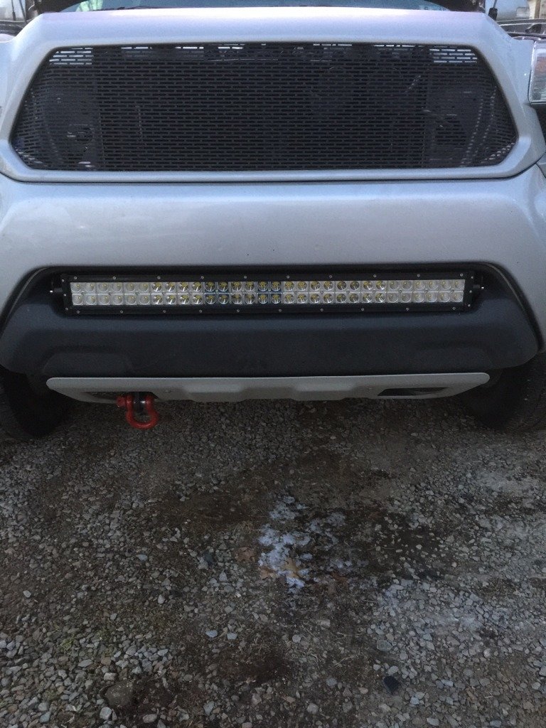

    Do you have any up close shots of the rigid brackets and your lightbar on it? and what modifications had to be done? I'm guessing some minor trimming of the valence plastic specifically the corners and the grill netting?

    Dscott7, did you use a diode like the air on board schematic shows?
    BigE I did have to trim out the corners of the valence plastic somewhat. It barely visible once the mounts and light is in.

    I wonder why I didn't get a notification in my subscription list? :confused: Anyways, I'm glad Skygear is helping yall! And Eddie, this is what I had to do
    As Josh mentioned, it is a tight fit. If you trim the corners of your valence a little bit, you'll have some wiggle room to aim

    I didn't have to drill out the mounts where they attached to the bar. I did need to ream out the holes on the passenger side mount where it attached to my crashbar just because there was a sloppy weld on the aluminum from factory. :(

    Ummmm.... Not that I know of. I used the fuse and relay from the Rigid lightbar.
