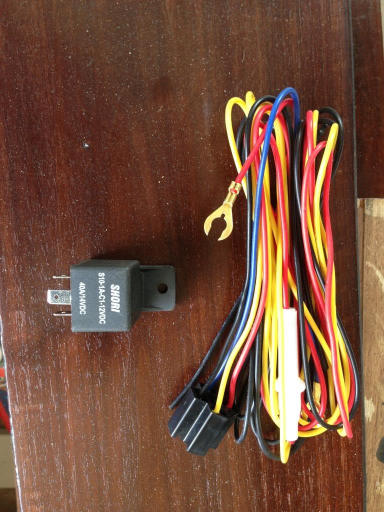

    Well, each hella light consumes approximately 4.5 amps making your current draw 13-14 amps depending on voltage fluctuation. The Blitzpro consumes nearly the same at 4.4 volts. Adding that inline will make your total draw 17.5-18.5 amps. Your relay is rated for 40amp and your not even to 50% load on it so the relay can handle it no problem. Whatever size fuse is in there now should be replaced to a 25 amp fuse.
    Only question remains is what size wore is in there. That's a key factor in this. The equipment is good to go but you have to have the foundation to support it. Pics of wires and relay would be good. Need to know wire size to safely give an answer.
    Also note that those harness' are typically designed for pairs of lights and since you have 3 lights on 1 harness its probably already pushing its capacity. But its possible it was designed to handle more.

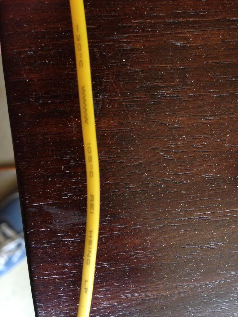

    This is what it all comes down to, these two little photos! haha
    BTW the wire appears to be 14-16G and yes it is all wired to one switch.

    Looks like 14-16 to me. hard to tell though. Well the calculations equal out to this:
    0-20 amps of draw from 4-10 feet of wire calls for 12g wire.
    If the TOTAL (power only, dont count ground) feet of wire from RELAY-->HELLA1-->HELLA2-->HELLA3-->LED1 is UNDER 4 feet in length, then 14g will work safely. With that said however Im wiling to bet you will have at least 1 foot of wire between each light and if they are all on your bumper then you will still have about 6-7 feet of total power wire total by the time it gets to the relay near the battery.
    SO, this will not work. Just using 3 Hellas on that one harness is pushing it already. I would recommend you install 2 harness' and can wire them to the same switch still. OR an even easier route would be to rewire your current harness. The wire that powers the lights now can be removed and upgraded to 12g wire. The ground on each light MUST be the same as the wire power. Then the wire that goes from RELAY-->BATTERY should also be 12g. Then your golden! The relay, switch, and remaining wire does not need to be changed.

    Correct! The wire that goes from relay>light1-4 needs to be 12g. The wire that goes from relay>battery (or fuse box) needs to be 12g. The wires that go from each individual light to ground also need to be 12g.
    the wires that go from power(or ground)>switch and switch>relay and relay>ground dont need to be changed. Those are low current wires which only supply a signal. It cant hurt to upgrade the relay>ground as well but its not 100% required.
    And remember, your fuse needs to be correct at well. You can try 20amp first and if it works fine then perfect. If it blows, go to 25 but dont go higher than that. the 20amp is good but heat and voltage can both cause current to change, so if they have been on for awhile and everything is hot and then your AC turns on and battery voltage drops real quick than amperage jumps real quick and that spike could cause a blown fuse. Thats why 25 may be better.

    Did the math again and 12g is for sure the correct size wire.
    in order to make 14 gauge acceptable, you would have to have a continuously supplied battery voltage of 13v and and amperage draw no more than 18.5 from your lights and no more than 1.8m (6ft) of wire from lights to relay. So thats all REALLY pushing it close. So 12 g will work more safely. 12g will be safe up to 10feet of wire for a battery voltage as low as 12 volts and a current as high as 20amps. More than 10 feet of cable or any more lights on that circuit will call for 10g or heavier wire.
