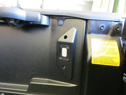

    Shop around some. I originally bought mine a couple of years back from a group buy here on TW from Lexus of North Miami. Not sure if they stock these anymore though. But they're readily available.
    I paid no attention to the wiring instructions. They had it so the bed lights came on with the dome lights. I didn't like that. Ultimately it's just a hot and a ground...so you can power the lights however you want. In my case the battery with a 5 amp fuse for protection.
    When I bought mine you had to print the templates yourself (that may have changed). If not...be sure to have your printer set to "actual size".

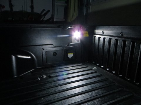

    What I did with my bed lights is just grab switch control from the interior dome light.
    If a door is open lights are on. If truck is locked and you hit unlock lights come on. It lowers your risk of draining the battery by leaving bed lights on and it’s a fairly simple install.
    I got two cheap white sticky strips at autozone for like $25. They stuck to the underside of the bed rails really well and have been there for years.
    The switch in your dome lights is ground side switched. So run got power back through your lights and snake a ground wire up to the dome light to connect in.
