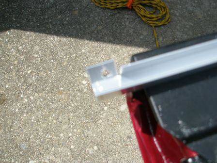

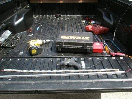

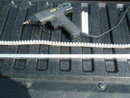

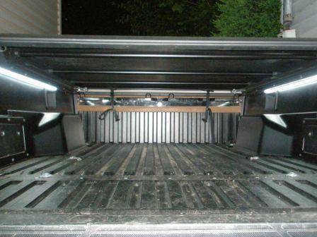

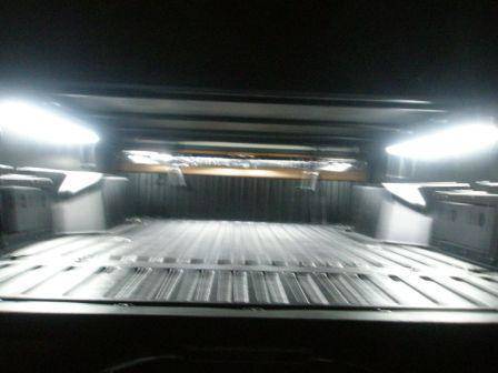

    I bought 3 sets in cool white, note that you cannot run the engine with these lights on (higher voltage will shorten led life) that's why they are not recommended for vehicles.
    Switch is located in the locker, ran power directly from the battery. Hot glued flexible strips in the channel I bought at Home Cheapo, then mounted directly under the cleat rails. They work great and are bright.
    http://www.superbrightleds.com/specs/WFLB96.htm
