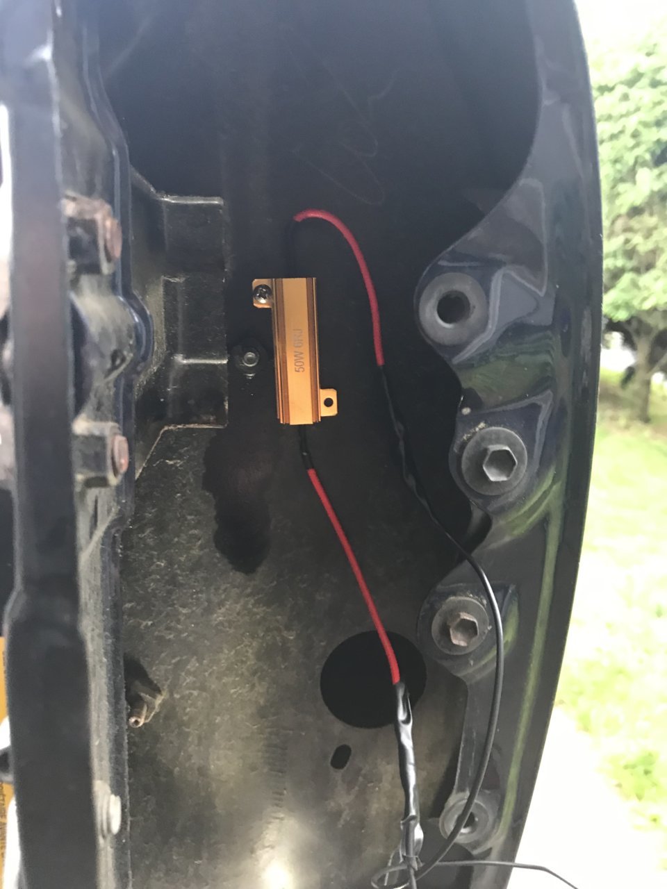

    I just wired up resistors on my 2012, and installed LED front blinkers with my son. Blinkers work with no hyperblink... UNTIL I turn the headlights on. I get hyper blink sound, but blinkers do not work at all when headlights are switch on. Did I buy the wrong LEDs? Thanks TW PEEPS! Amazon.com/dp/B07HF47RV9?ref=ppx_pop_dt_b_product_details&th=1 amazon.com/dp/B07SSXDW4G?ref=ppx_yo2ov_dt_b_product_details&th=1

    update. Cut the resistors on front, and everything was functional. But hb was back.
    So I swapped leds to rear lights. Stuck rears into front. Done.
