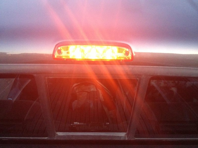

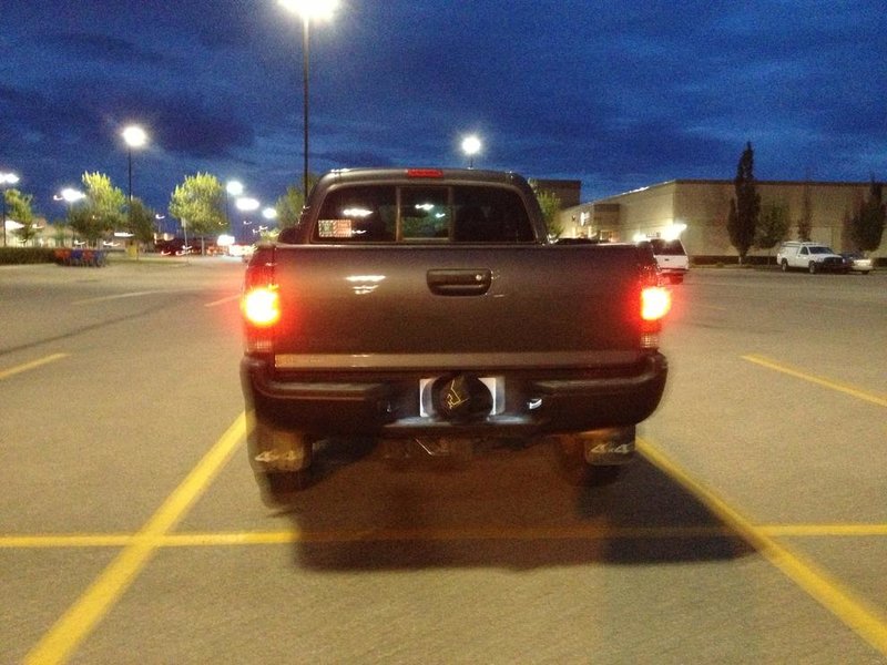

    Map lights/license plate/3rd brake lights are 168/192 wedge bulbs.
    Dome light I used was a 1.50" feston tube.
    Mine were just plug in play(just swap out the bulbs). Other people choose to wire up new lighting. This picture was from my 11' Tacoma, swapped into my 13'.
