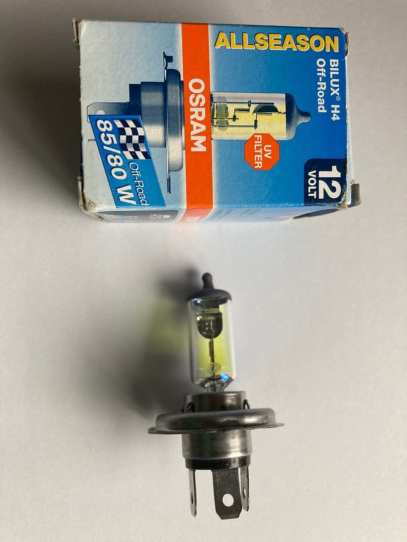

    Osram actually did make a high performance 85/80 watt "All Season" bulb which is no longer available. It utilized a yellow tint to supposedly improve one's vision in inclement weather. I used to run them in my Tacoma with the HD harness and they were actually pretty decent. I still have a pair in my basement stash.

    Are they plug and play or require harness modifications

    They require a heavy-duty harness - if you could even find a pair.
